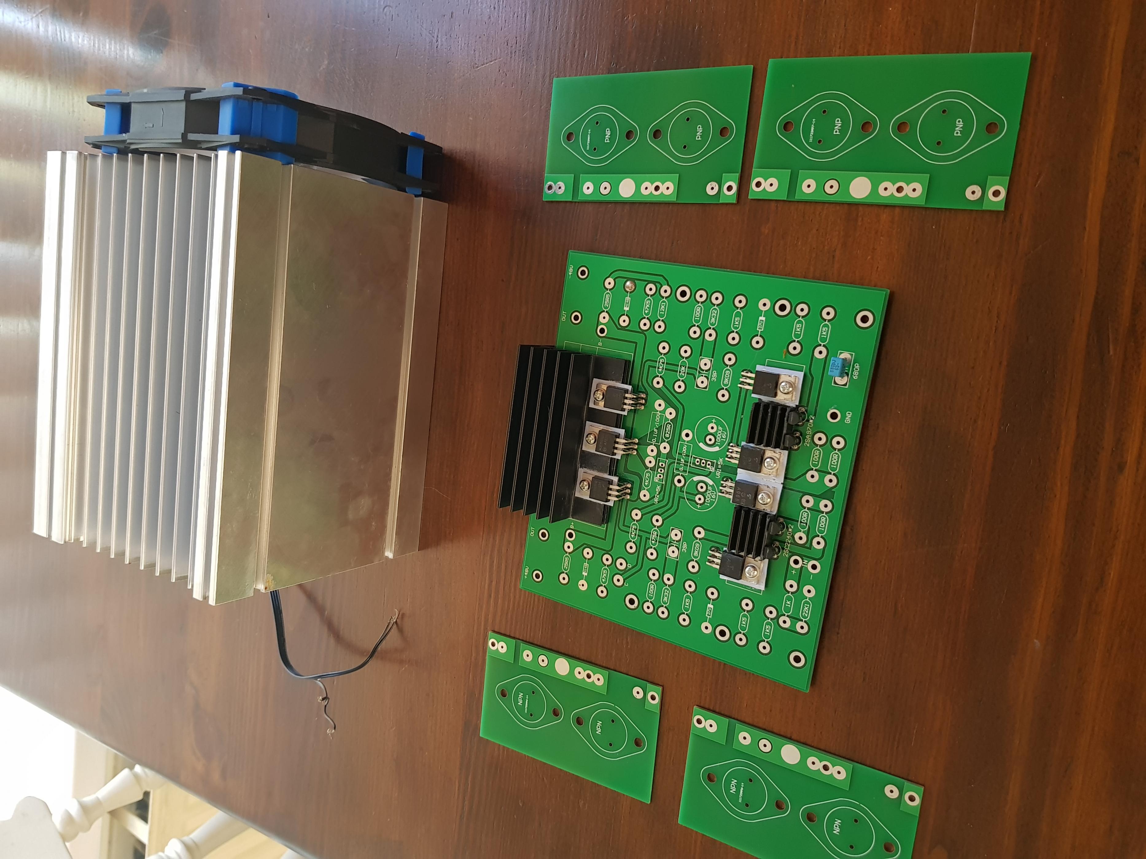

I designed a longer output PCB to better use the length of the heat sink. I made it so a single design can be used in either side of the case. Here are the new output boards next to the original ones, which I never used.
Output boards populated and then mounted on the heat sink.

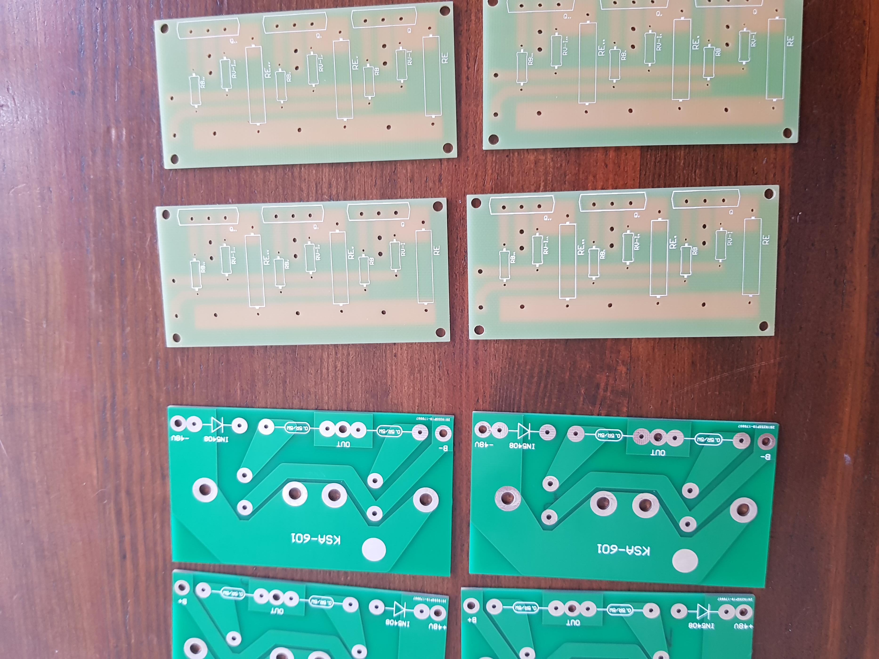

Just ordered a set of boards from ebay and want to make 2 mono block amps like this.
I have been offered 4 x heat sinks 300x132x40 £80 second hand would these be large enough to run in full class A 2x50w.
Not sure weather to get these or buy T-03 heatsink and make fan heat sinks.
Also I really like the longer transistor boards.
Thanks Dave.

Hello. I built a KSA-100, way back when this thread started and noticed your boards look very much different. May I ask where did you get them and are they still available?I am trying to decide what transistors to order for my krell clones.
My pcbs that I have started to put together come with T03 type transistor pcbs but I also have pcbs from another kit I decided not to use.
It would be easier to fit the pcbs with MJL21193/4 to my heatsinks but have noticed that the T03 pcbs have places for diodes.
Would I need to add diodes if I use the MJL21193/4 pcbs.
Which is the best choice transistors for sound quality T03 LM21193/4 or MJL21193/4.
Thanks for any imput.
Hi I got them from ebay they are still available item number 112435193237
I bought a set of those eBay boards not too long ago just out of curiosity. They are actually direct drop in replacements for the original factory boards and are very high quality. The traces appear to be 2 ounces.

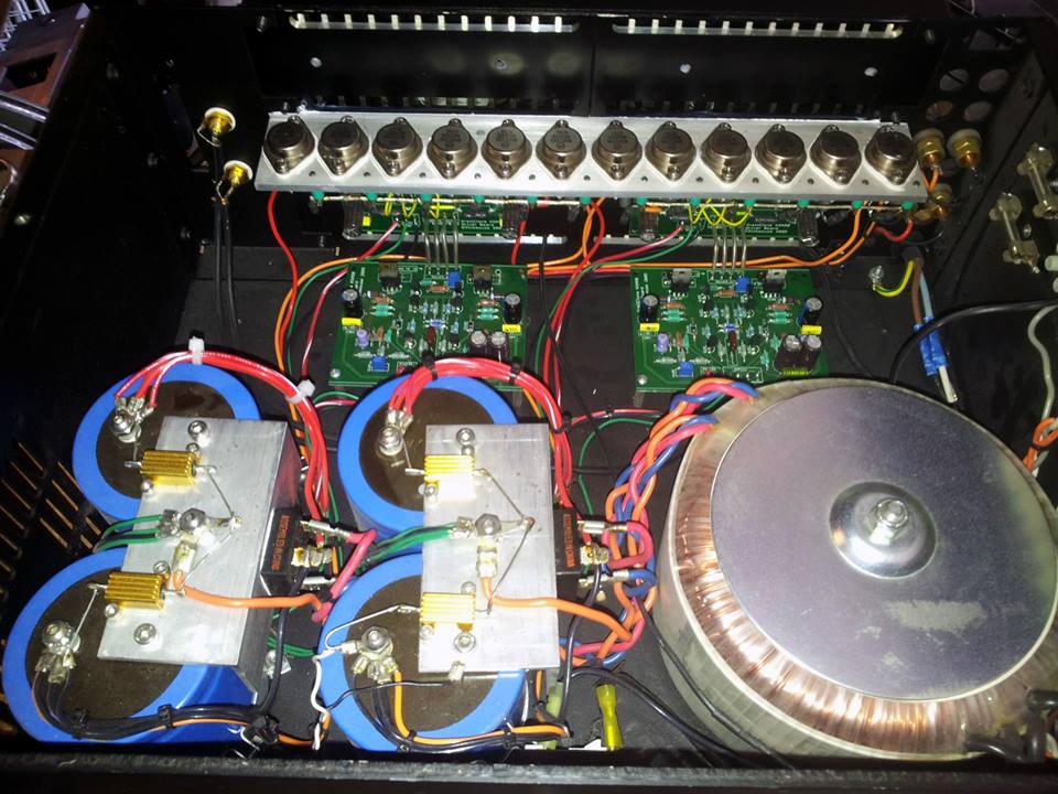

Who has built a KSA 50 type amp with raised rails and lighter bias?
Say maybe +/-48v and 25w class A... for 6-8ohm speakers-ish.
If so, what was your impression? Was there a 'Klunk' into AB? 🙂
Mine has high rails thata re right around that voltage, and three output devices per side on each channel. Also a 1.2 KVA toroid. You can see mine in the picture. I built it back around right when the Pink Mouse boards came out. The heat Stinks are smallish but force air cooled. This is an ex AB Systems 6 channel amp chassis.
Mark
Mark
I am for sure its not over 2 amps per rail at about +|- 46 volts. I also remember there was a mistake in the original spread sheet that was found later on, so if anyone used it then you are off a bit. Mine beats factory specs by quite a margin, so I've always just left it as is. The bottom end it produces is incredible.
