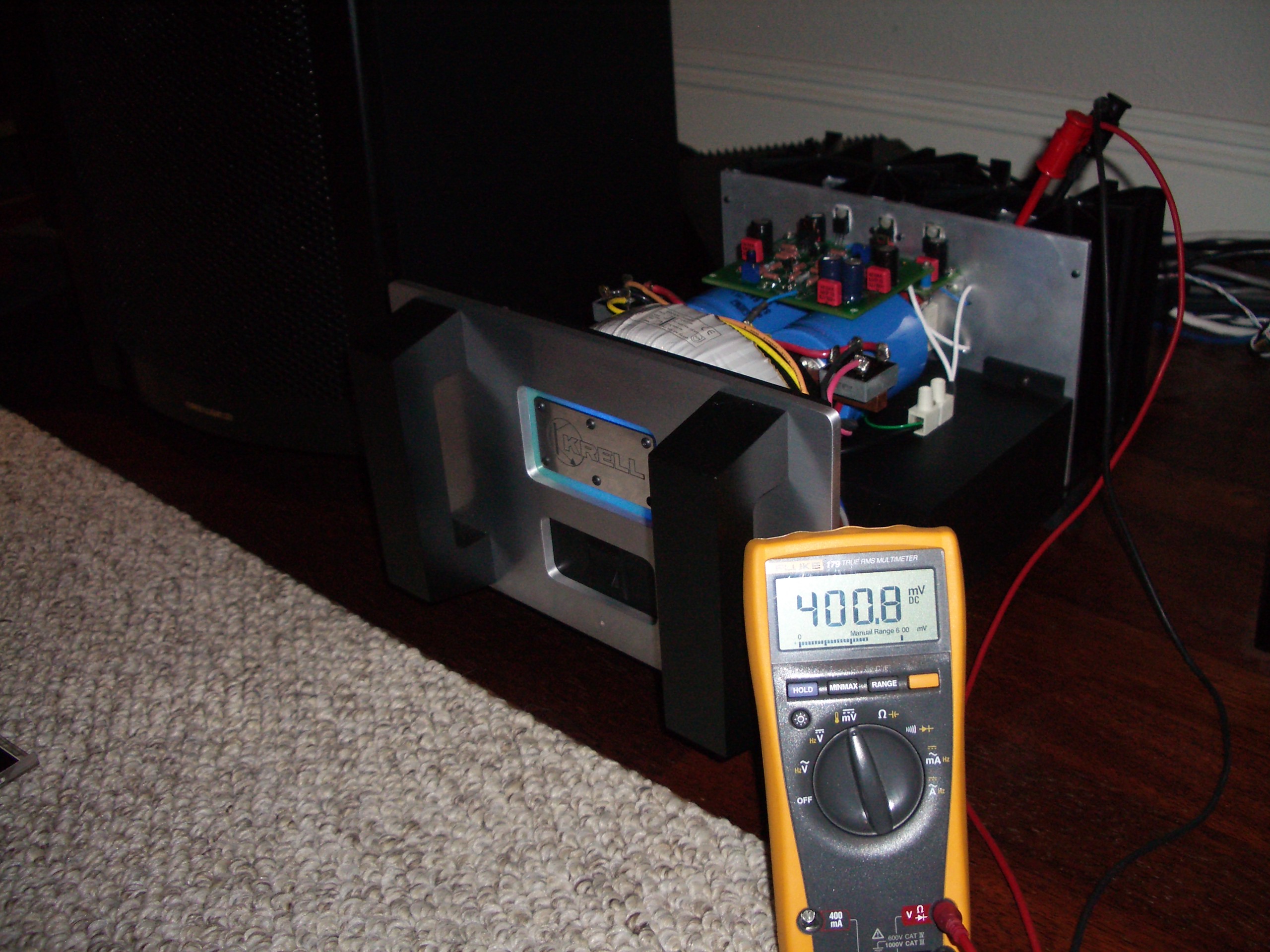

In progress doing a refurb and clean up of my KSA 50 clone built 12 years ago. Bias was all wonky but DC offset needed no adjustment and was not a problem.

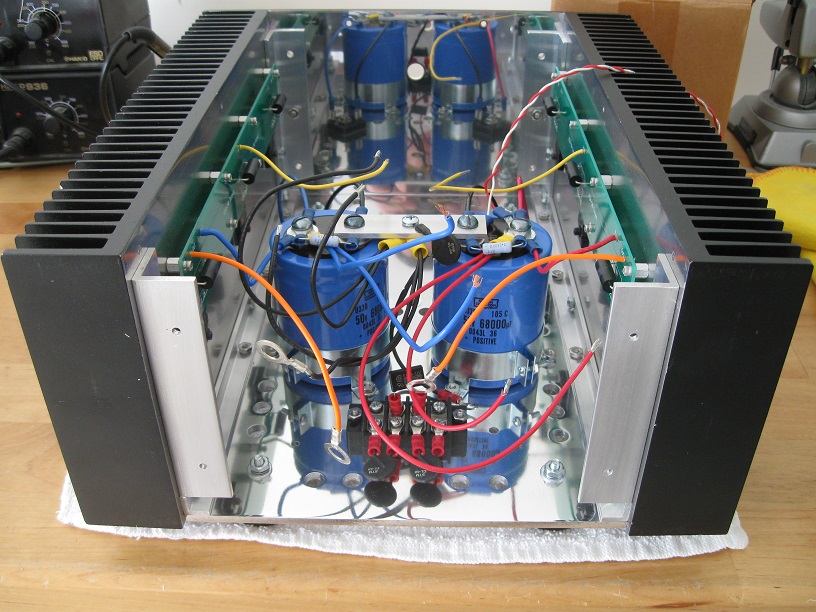

I completed my KSA-50 build in 2007. It took longer than I had planned and, combined with a job change and added daily commute time, I never put the final touch in the mono-blocs’ appearance. I decided they would get a makeover for their 10th anniversary, starting with a thorough cleaning of all the aluminum parts which still had Sharpie markings from the cutting and drilling steps. The makeover would also add long output boards to better use the length of the heat sinks, and front panels, which I never got to make back then.
After I had taken the units apart and cleaned up the aluminum panels, Troy posted this:
http://www.diyaudio.com/forums/solid-state/31077-krell-ksa-50-pcb-355.html#post5195136
I decided to take pictures of the makeover and post them, so he can hopefully enjoy them.

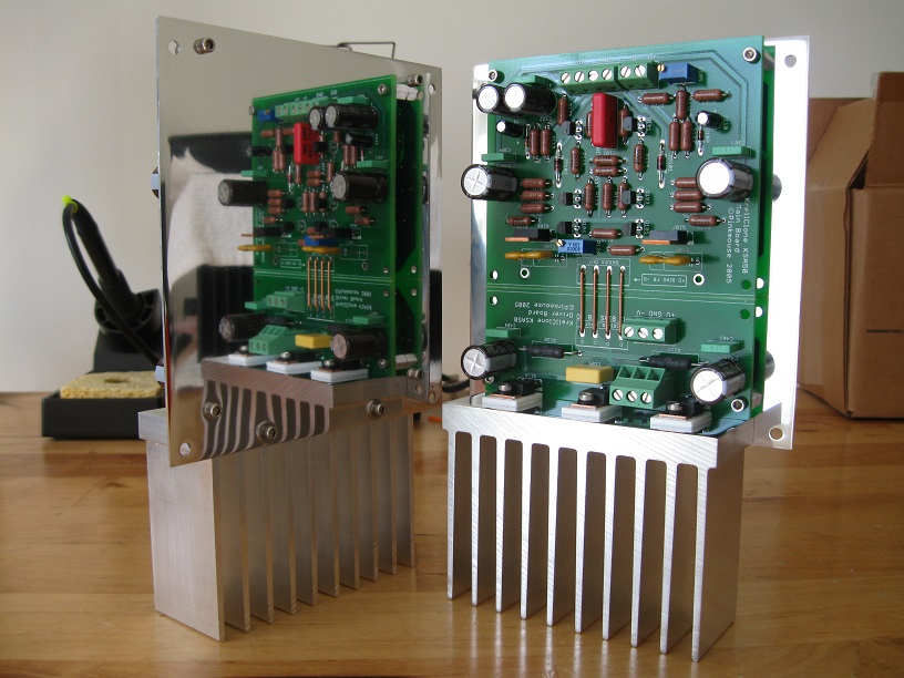

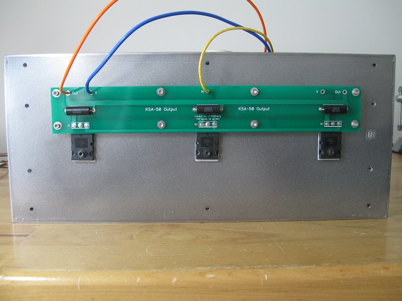

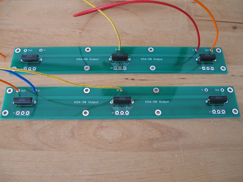

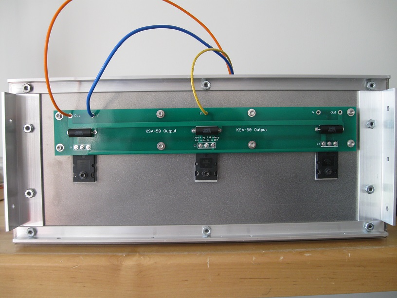

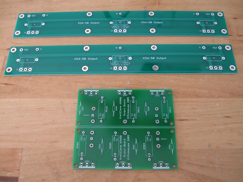

I designed a longer output PCB to better use the length of the heat sink. I made it so a single design can be used in either side of the case. Here are the new output boards next to the original ones, which I never used.
Output boards populated and then mounted on the heat sink.

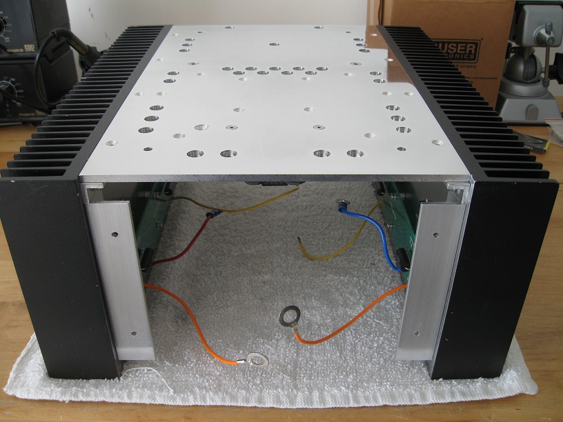

The aluminum brackets after the cleanup, mounted on the heat sink.

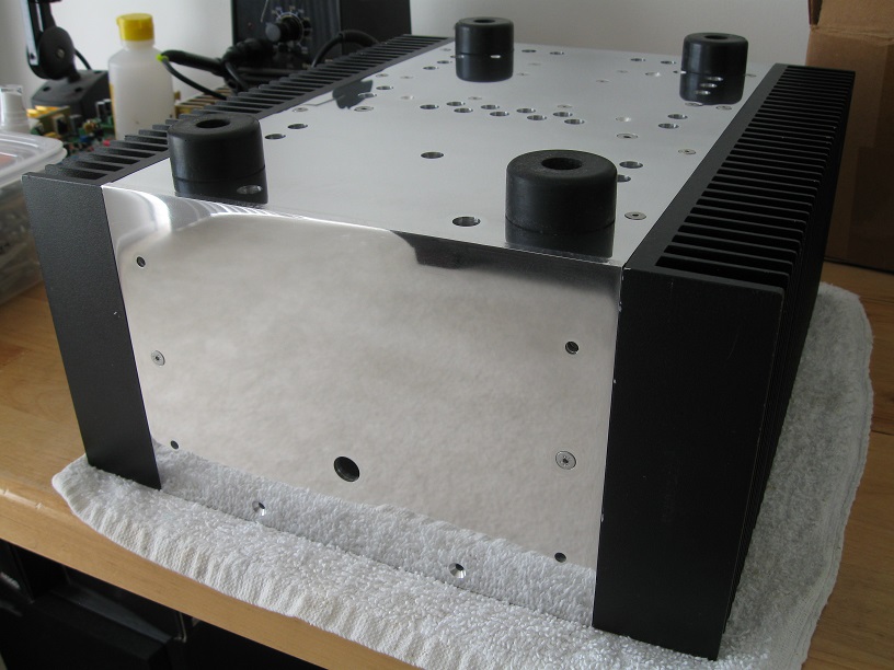

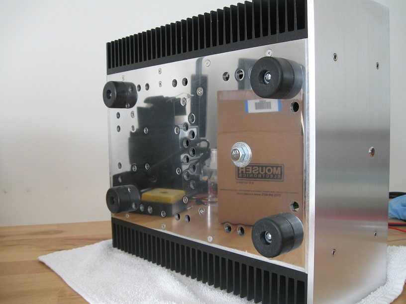

The bottom plate really clean (yeah, I went a little crazy on that one. 🙂
The best way I found to mount the bottom plate is to flip the heat sink and assemble everything upside down.

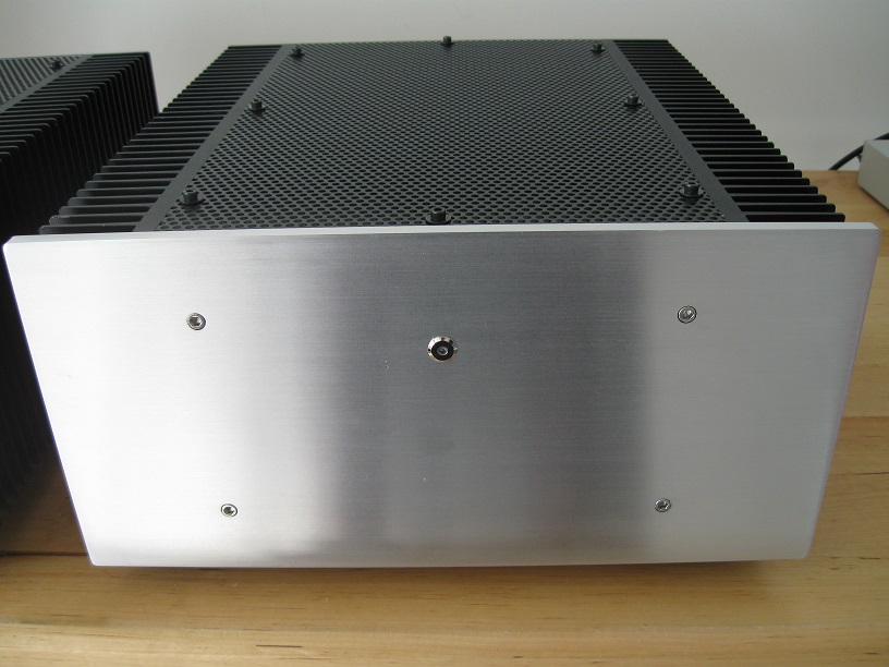

I then installed the front plate and the rubber feet.

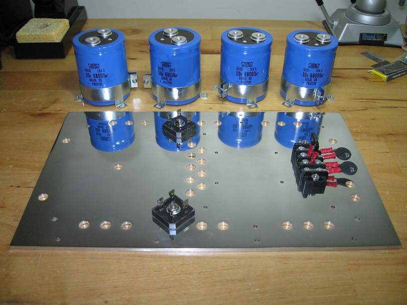

Next I reinstalled the capacitors and redid the wiring.

10th anniversary makeover (continued)

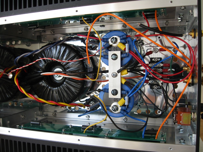

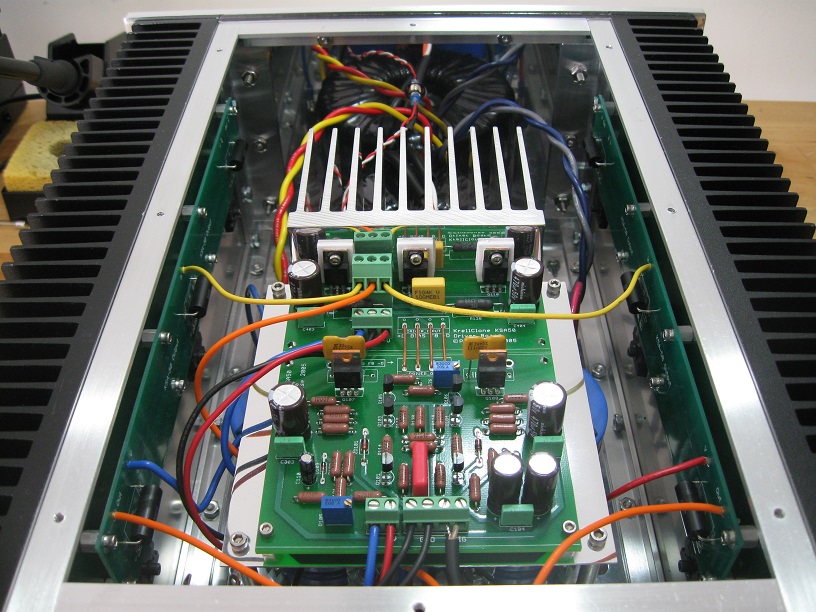

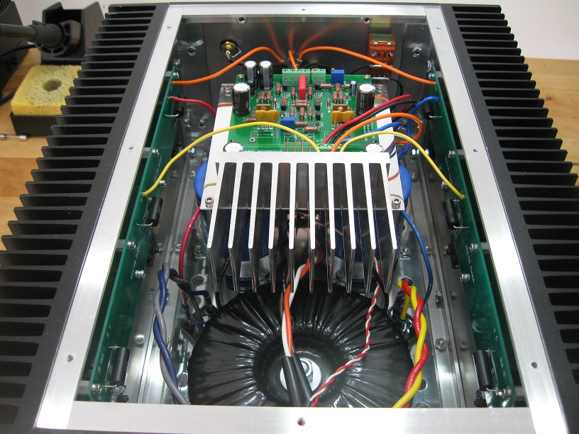

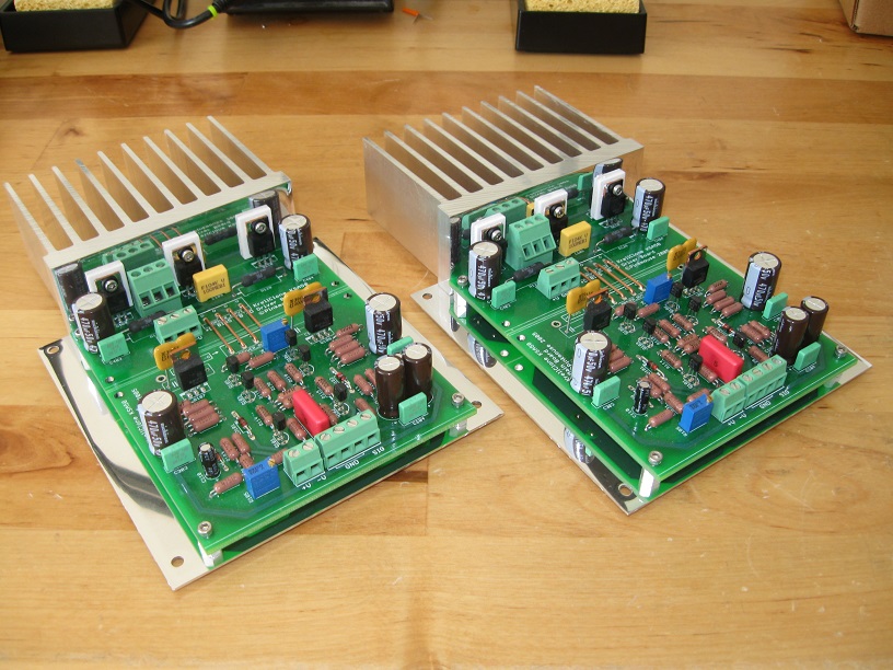

The main PCBs are mounted on an aluminum plate, supported by four standoffs attached to the bottom plate. I replaced the drivers' heat sink with a larger one.
I reinstalled the transformer and connected it.
Next I put the PCB assembly back in its place.

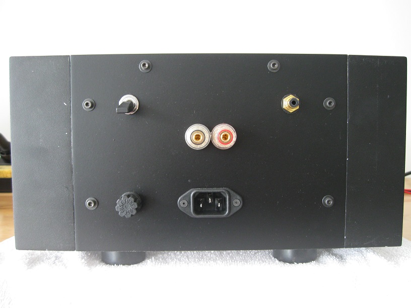

And here is a view from the back.

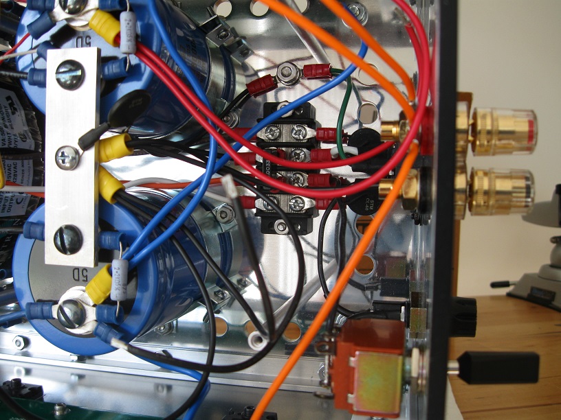

A closeup of the connections on the bottom and back plates.

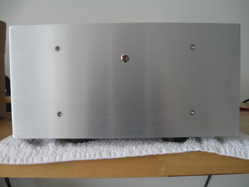

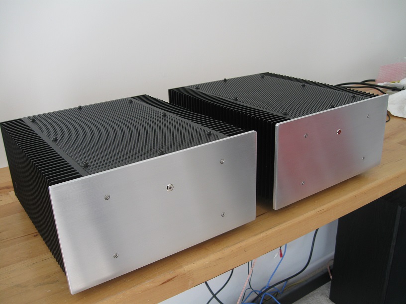

The newly created front panel
The back plate.
And the bottom plate

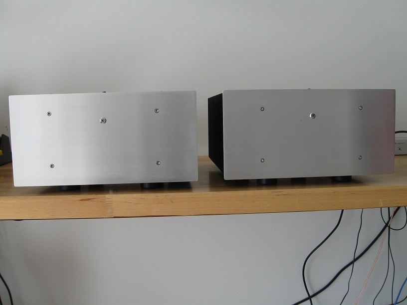

And finally, the mono-blocs complete, side-by-side.
The back plate.

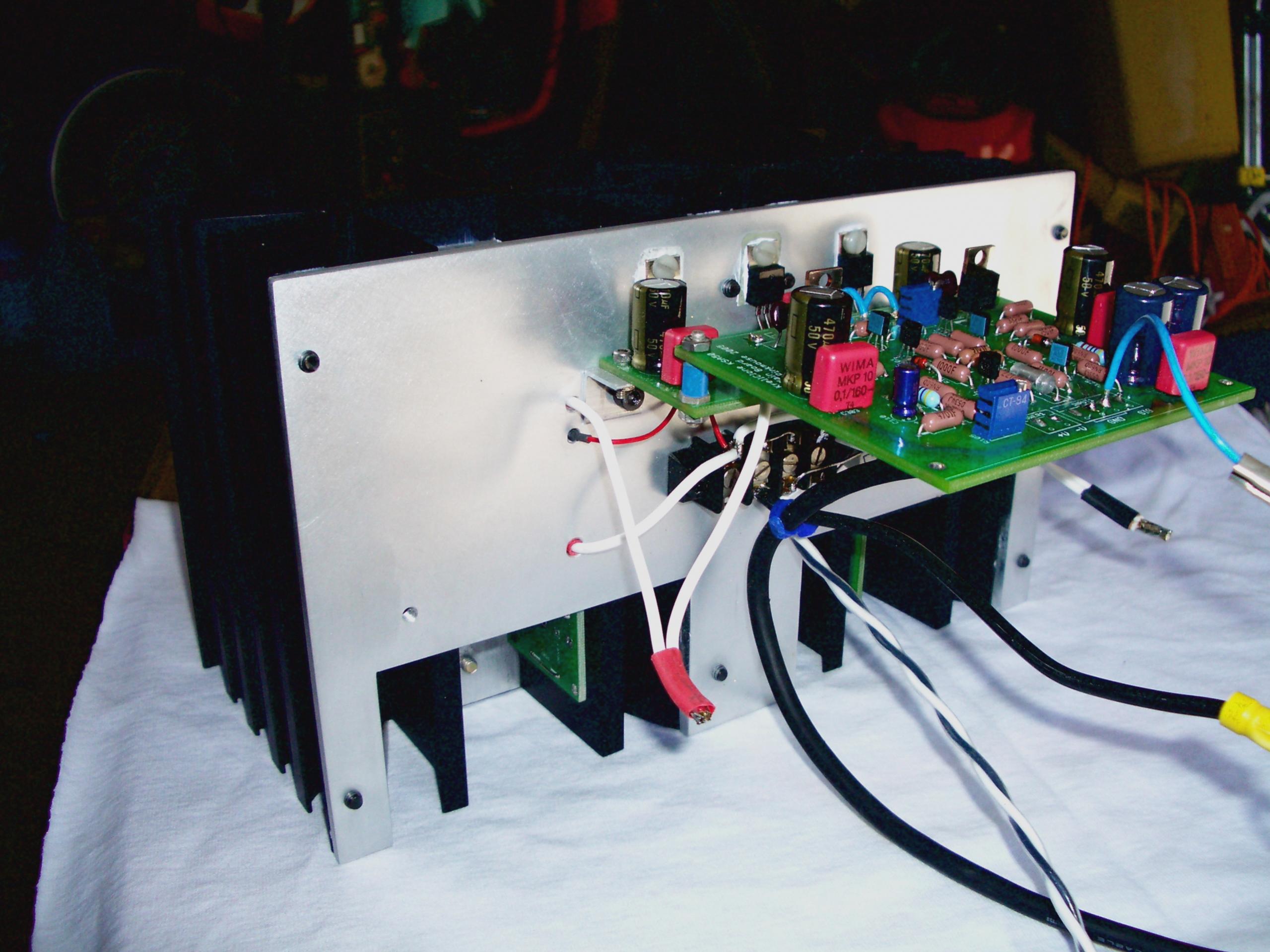

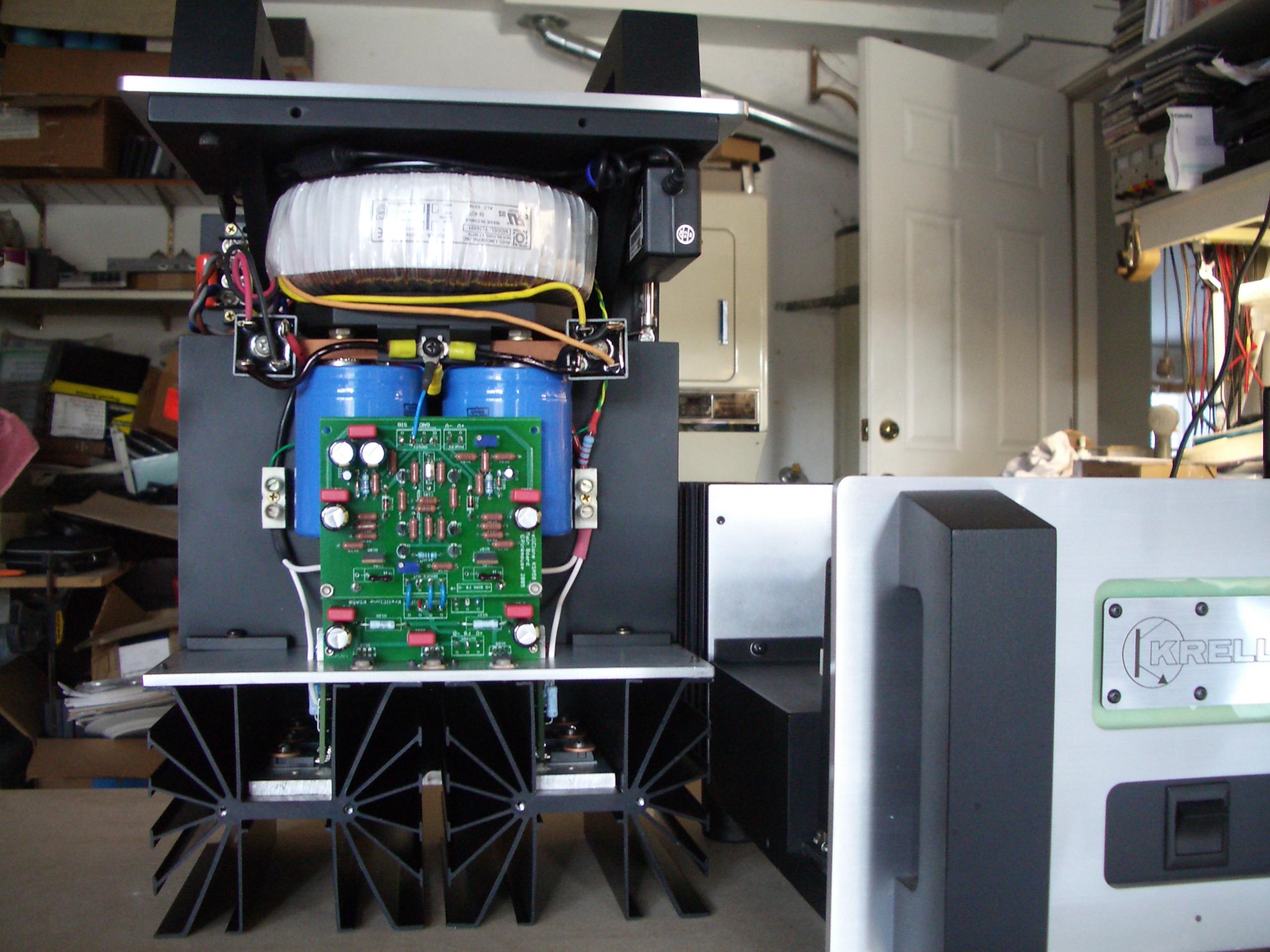

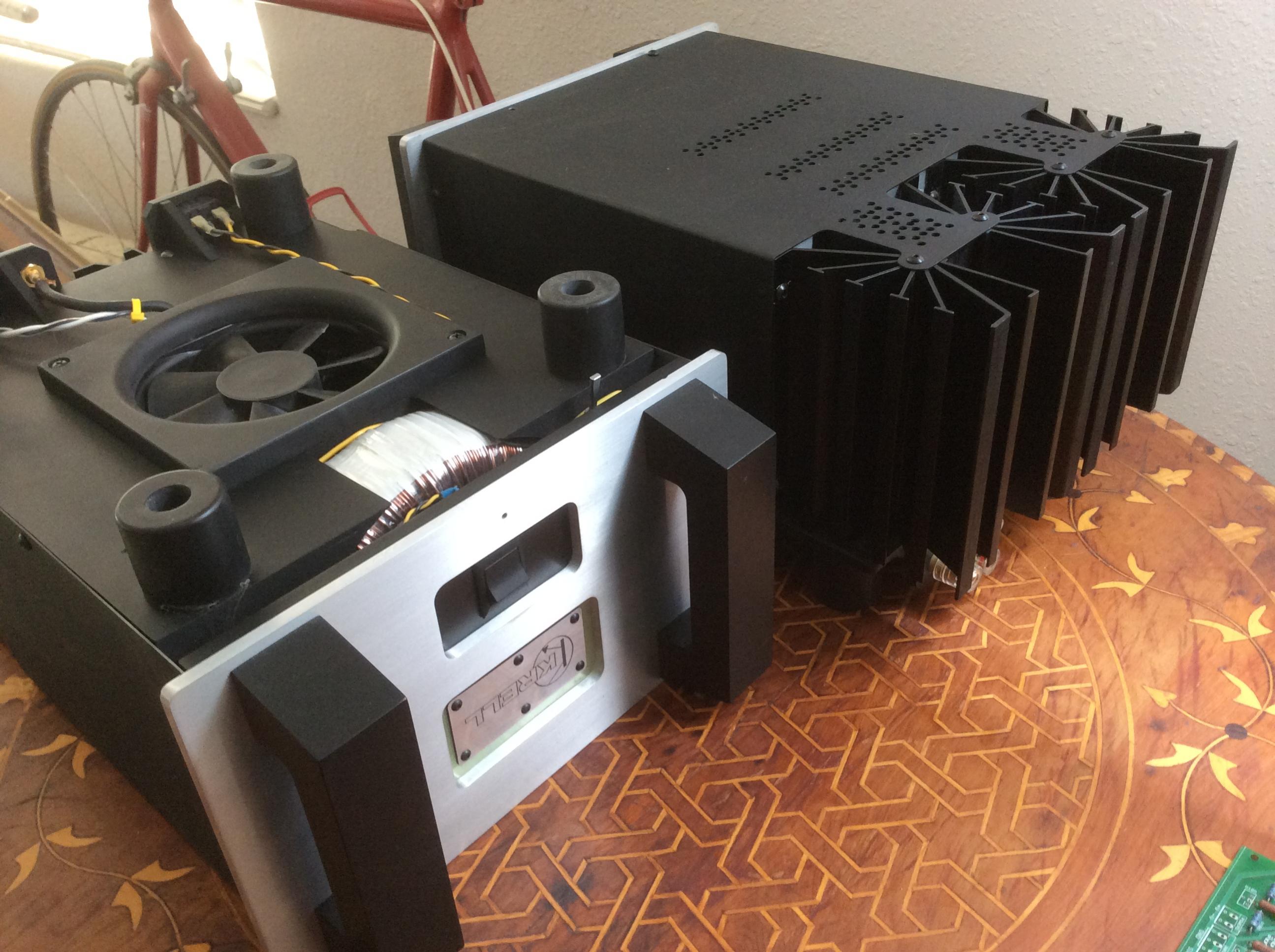

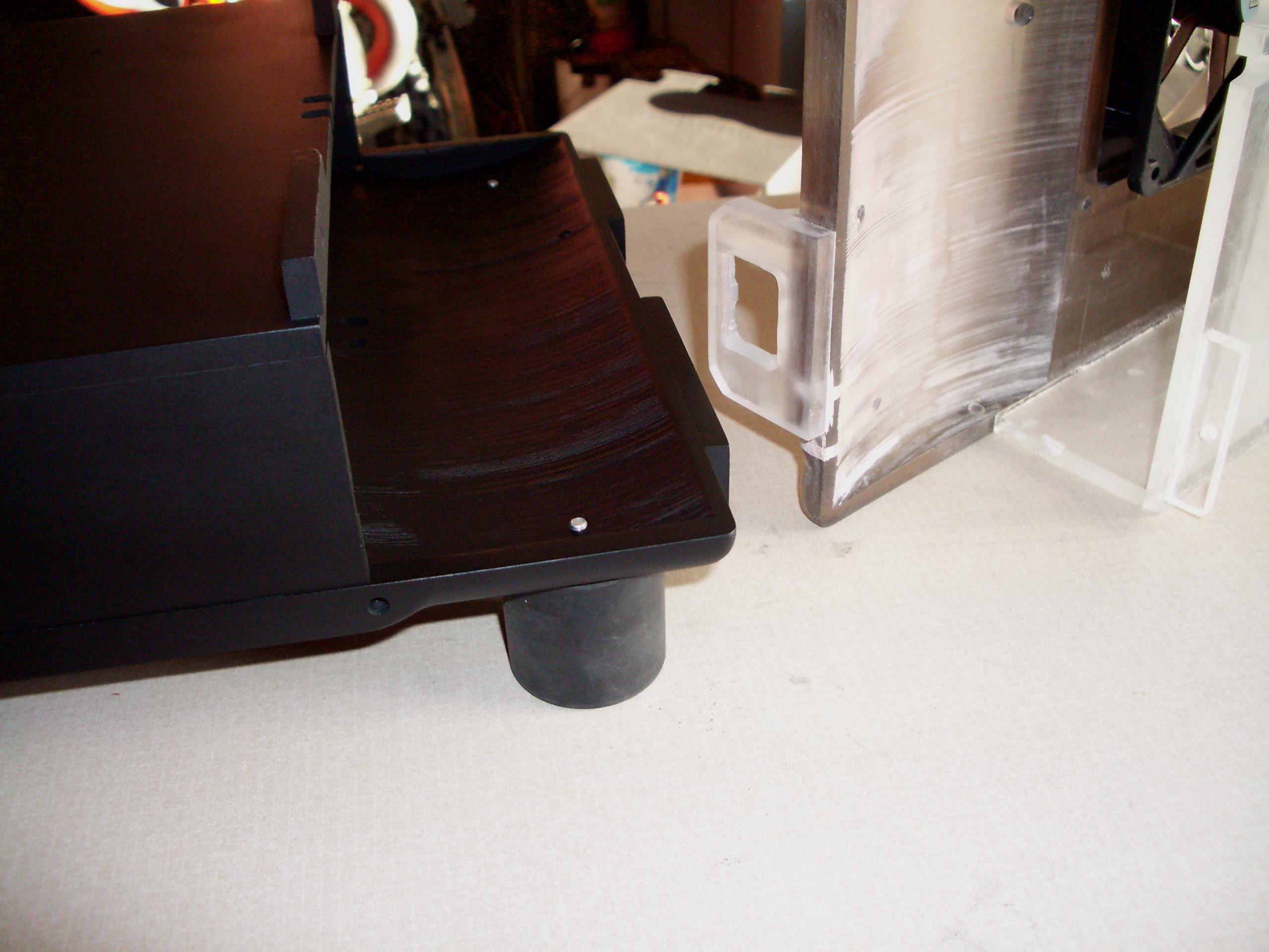

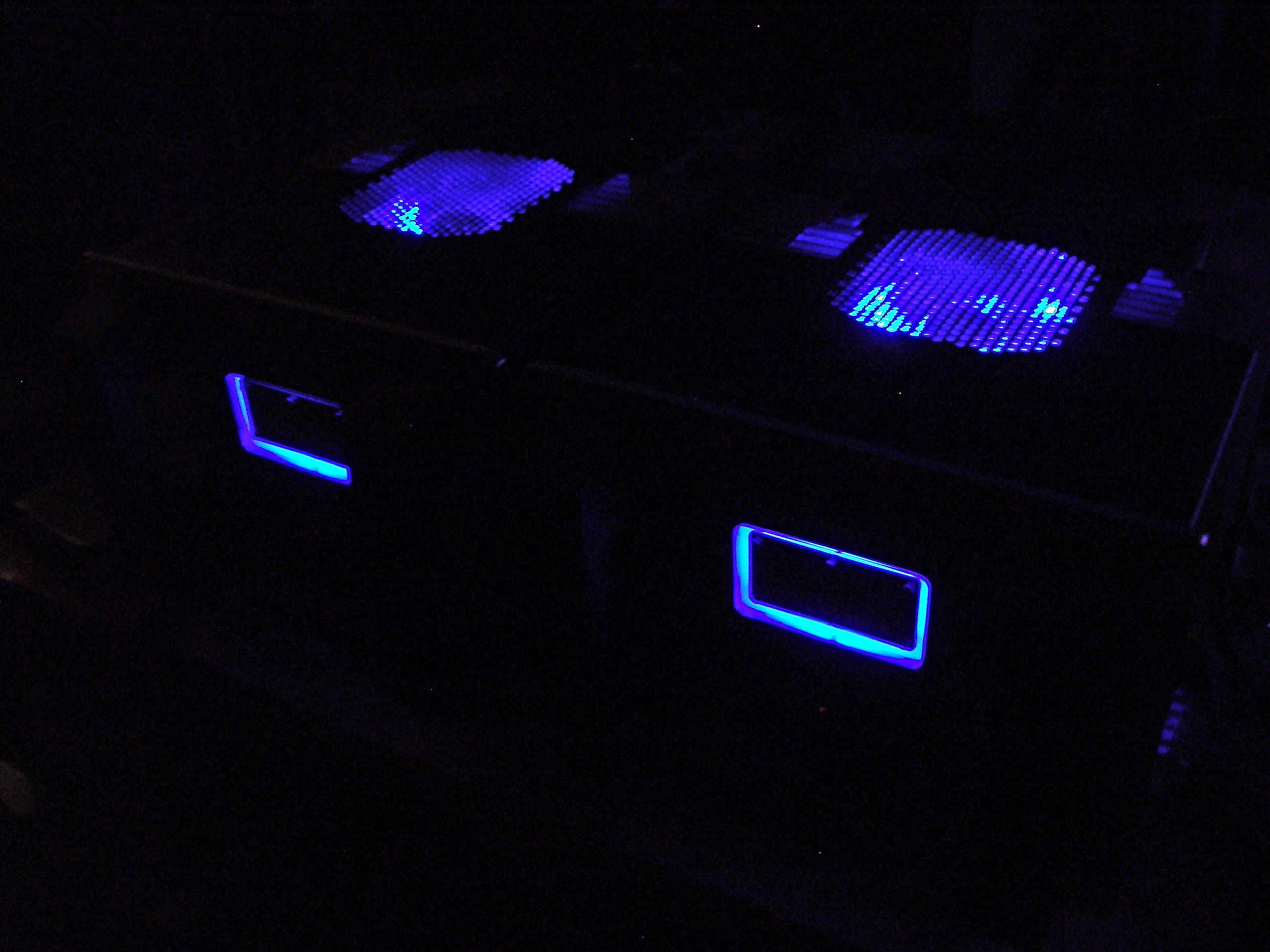

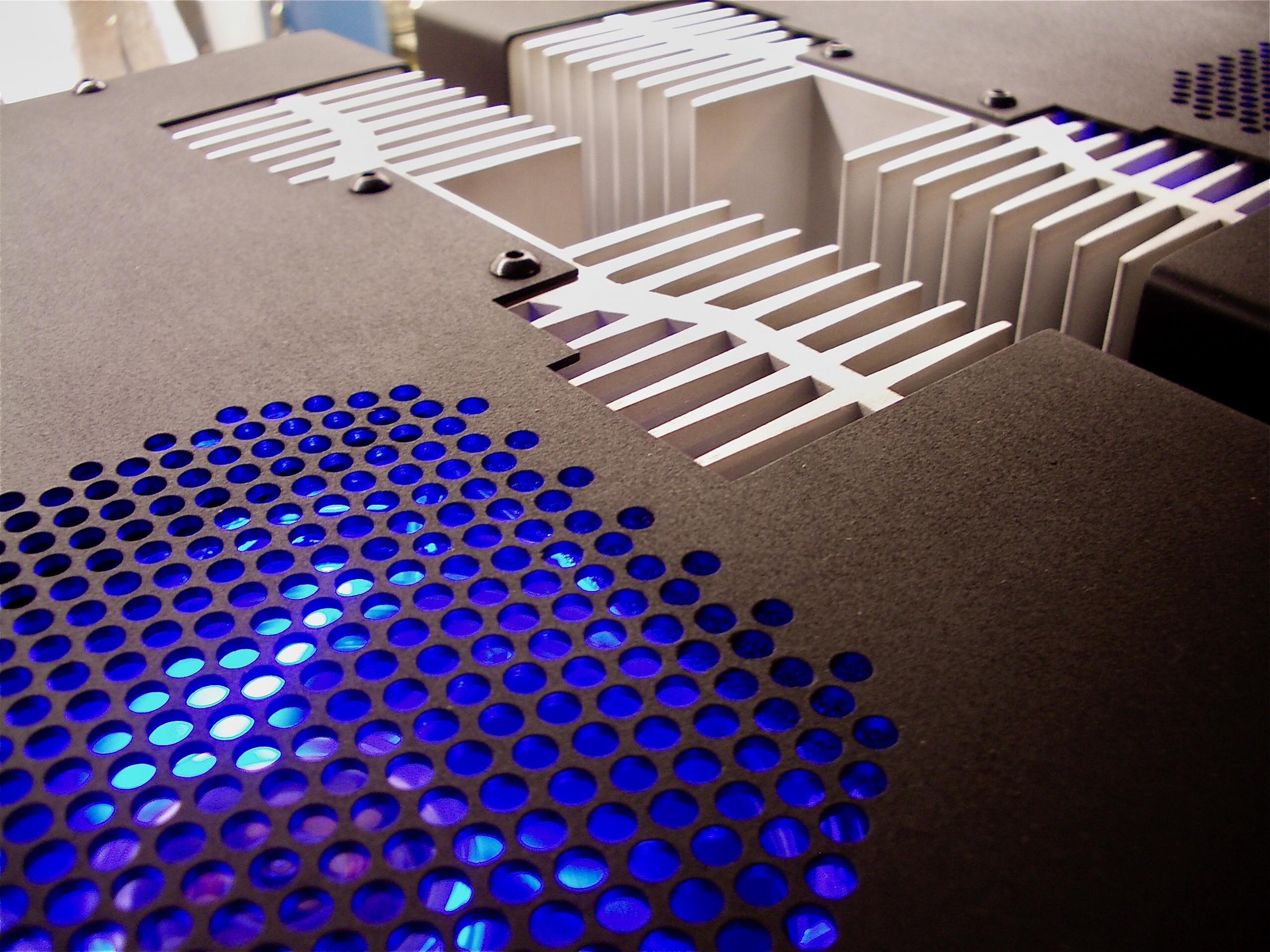

Hi Avwerk, impressive build. How's the air flow on your enclosure? I see a fan but i can not understand exactly how the air flows.

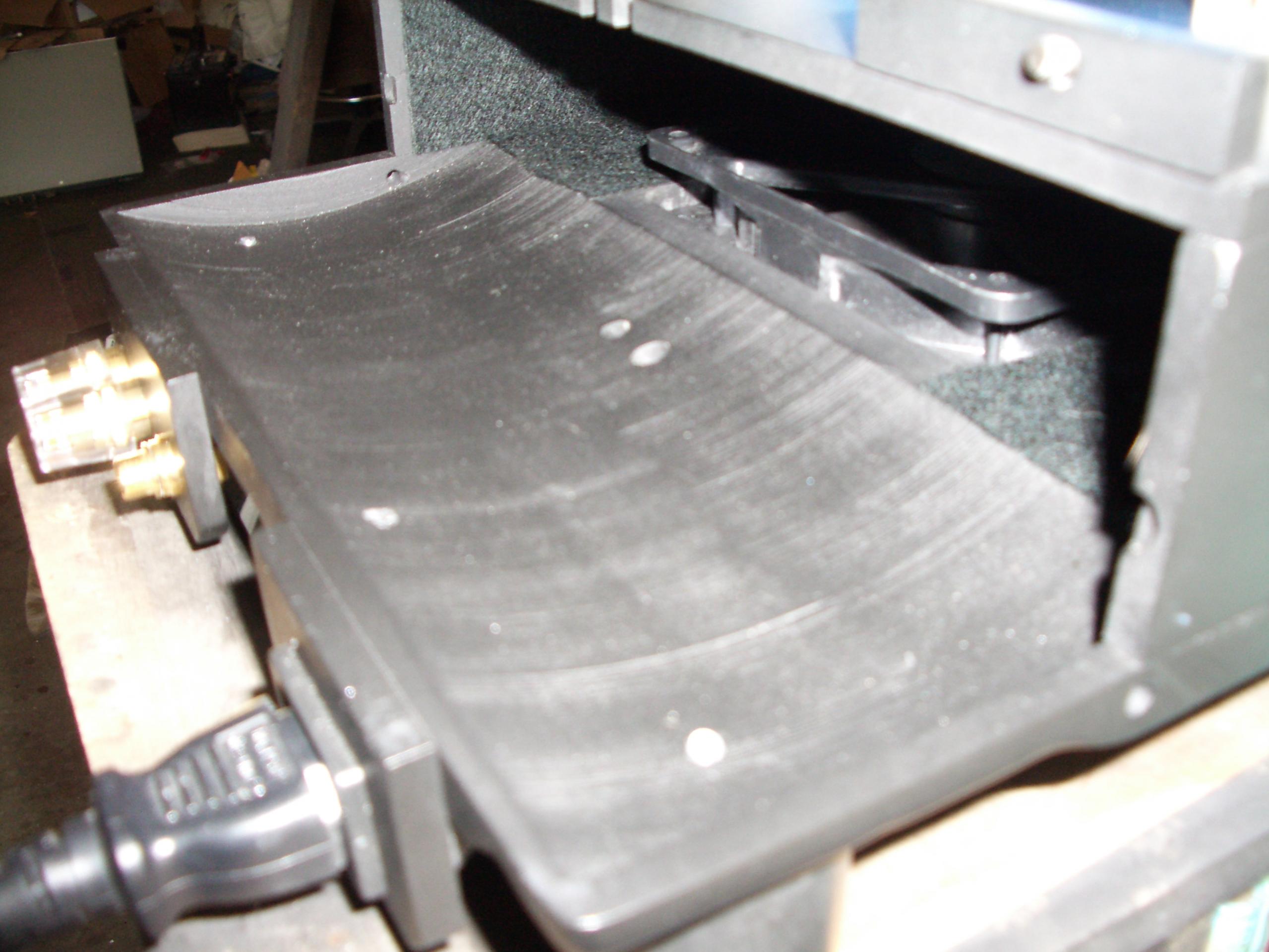

There is a plenum box it blows into and is lined with felt and it exits into a scouped out base that extends half way out underneath the heatsink area. This is enough to direct the air across all fins upward.
The way Grimberg has done it is the best quietest way of course, but at the time I didn,t have the sinks for natural convection and had these.
Don,t think for one second each heatsink can handle 3 outputs at full bias because they can,t and thus the fan is needed.
It is important that you run a fan well under 1000rpm and these are run just above the turn on voltage around 7 volts ( from memory)
Even in this particular arrangement, I can hear the fans slightly so would not really suggest this way but it was my thinking back then and went for it.
My 100 monos are fan cooled and you cannot hear them because inlet and outlet are protrusion free.
The last pic shows the 100 Mono. There are fins on the back side of each sink and blowing straight down lowered the on off temp 11c and just enough to keep proper bias temps on the TO 3 outputs of that build.
Moral of story , big sinks (grimberg) air convection and no noise or small sinks and smaller builds and slight sacrifice in fan rush depending on configuration
All good fun
Regards
David
Some pics

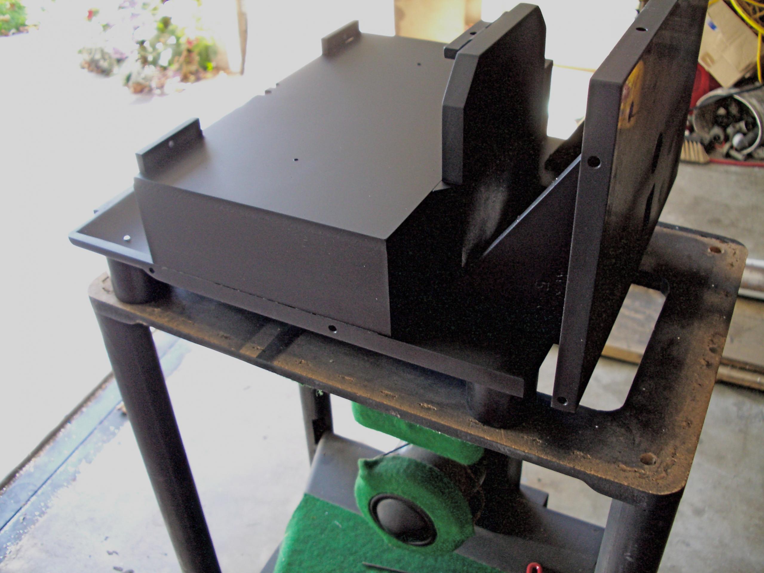

Do you have access to metalworking equipment or did you order the front panel and cover?

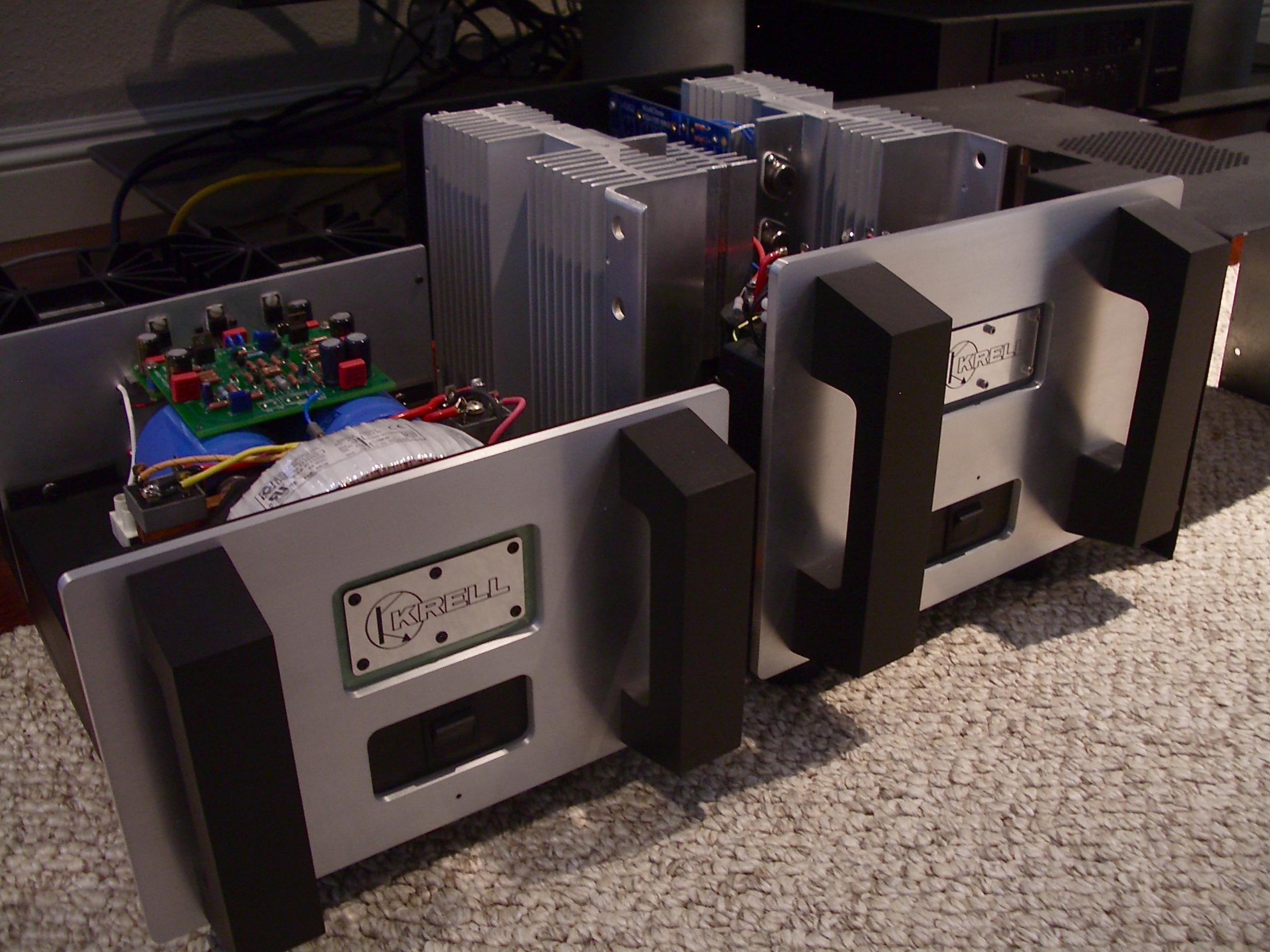

The badges were made by a member in Europe back in that time period and he offered them one time only. It wasn,t a group buy, just everyone responding to a couple of posts he made while he was building his clone. They were CNC,d out of brushed metal clad Formica material. Back lighting was my design though.
The machining is nothing fancy and the handles are made of acrylic and painted. Just made a jig with a long laminate trim router held on with 5/16"-28 bolts.
The front panel was cut on a table saw , sanded, acid etched and clear coated.
The big fans that are now avaible are the best bet and were not around 10 years ago. I might even remake the 50 water to accept a couple of them. That air path design is still not optimum ,but bigger fans would lower noise contributions.
I am currently going to use them in an OTL /6c33 in the works.
They have the low speed torque to provide that low speed and super low noise.
The key to low noise is keeping the inlet clear , some distance from any objects in the path and a clear open area exiting and yes those big slow fans.
A pic of the downward blowing fan 100 mono build. 2 speed and no noise.

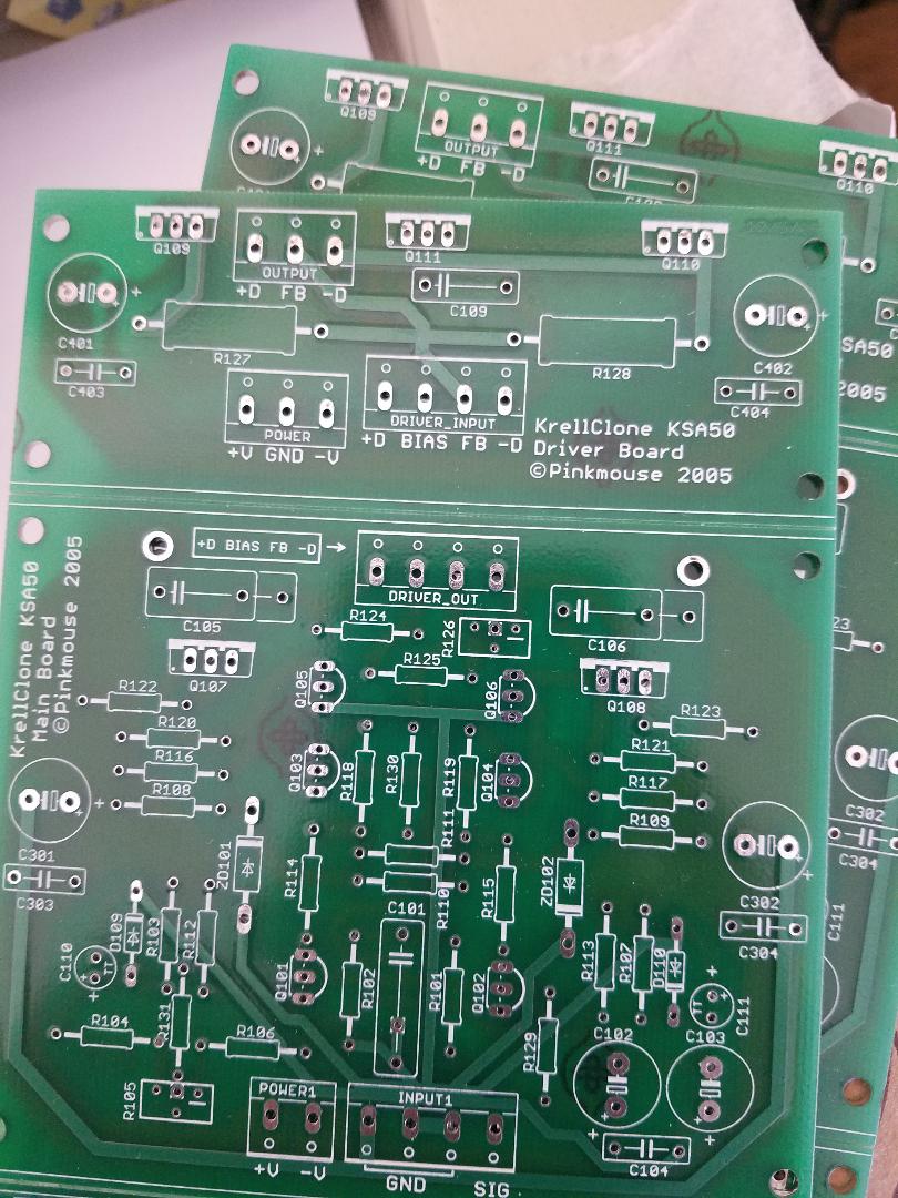

I have a pair of pinkmouse KSA-50 boards available. What would they be worth now? Add shipping and they're yours. I have a wonderful KSA-100 still kicking ash which I never push bias pass .365mv and never have to raise volume one quarter turn-don't want to blow out the windows. I use 1KVA transfos, so I have two sets of speaker. One with 12" woofers and the other with 15" woofers.
I built this amp because I lost my hearing in the Army so I have to ---FEEL--- the music. If these boards are too old and outdated I understand.
Not sure what those would be worth but at this point one who wants to divest of the boards should figure out what errors are on there and point to the solution... identified and buried in this thread... I think there were a couple of issues with those?
Can you recall what issues with these boards as I can,t remember anything significant

To my knowledge there was no issues with the pink mouse boards ordered by Mark. The Jan boards had a unique potentiometer that was unobtainable so they needed to be modified slightly.Can you recall what issues with these boards as I can,t remember anything significant
