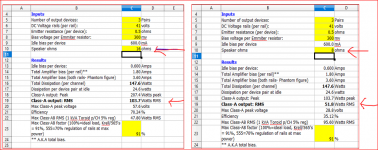

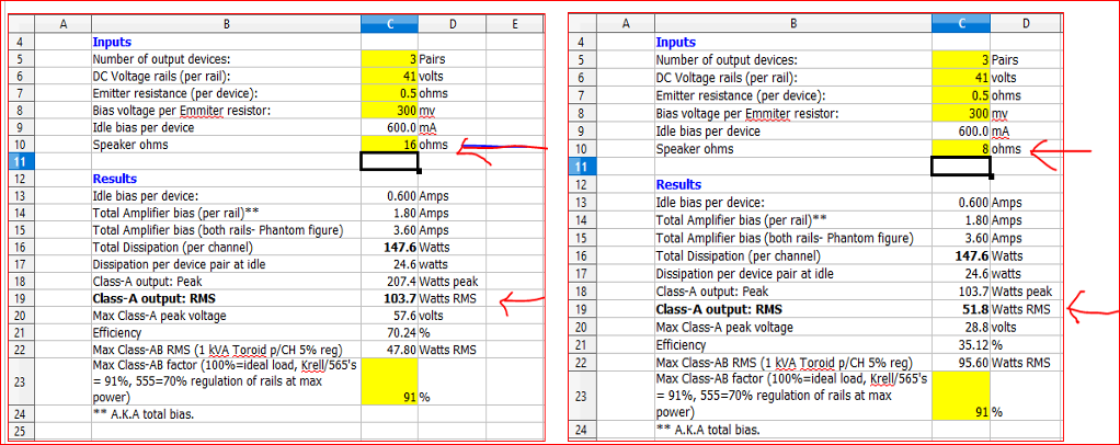

16 ohms?
I'm a big fan of this amp.
I recently acquired a pair of 16 ohm drivers I want to spend some time messing with.
There are a couple of spreadsheet calculators floating around for the Klone. I know that some errors have been found in the past with them, but I'm not sure if they have related to the output power rows. According to the calculator, the KSA50 can put out considerably more power into 16 ohms than 8 ohms. What's wrong with this picture?
TIA
TIA
you will need to go into the cells and change the formulae
I'm not a math wiz...
The speaker impedance as entered into the spreadsheet is one of the variables, same as rail voltage or Iq.
Are you saying the formula needs to be re-written for each speaker impedance?
If the result is correct for some speaker impedances but wrong for others, then the formula needs to be conditional. Those conditions need to be chosen to suit what currents and voltages are available.

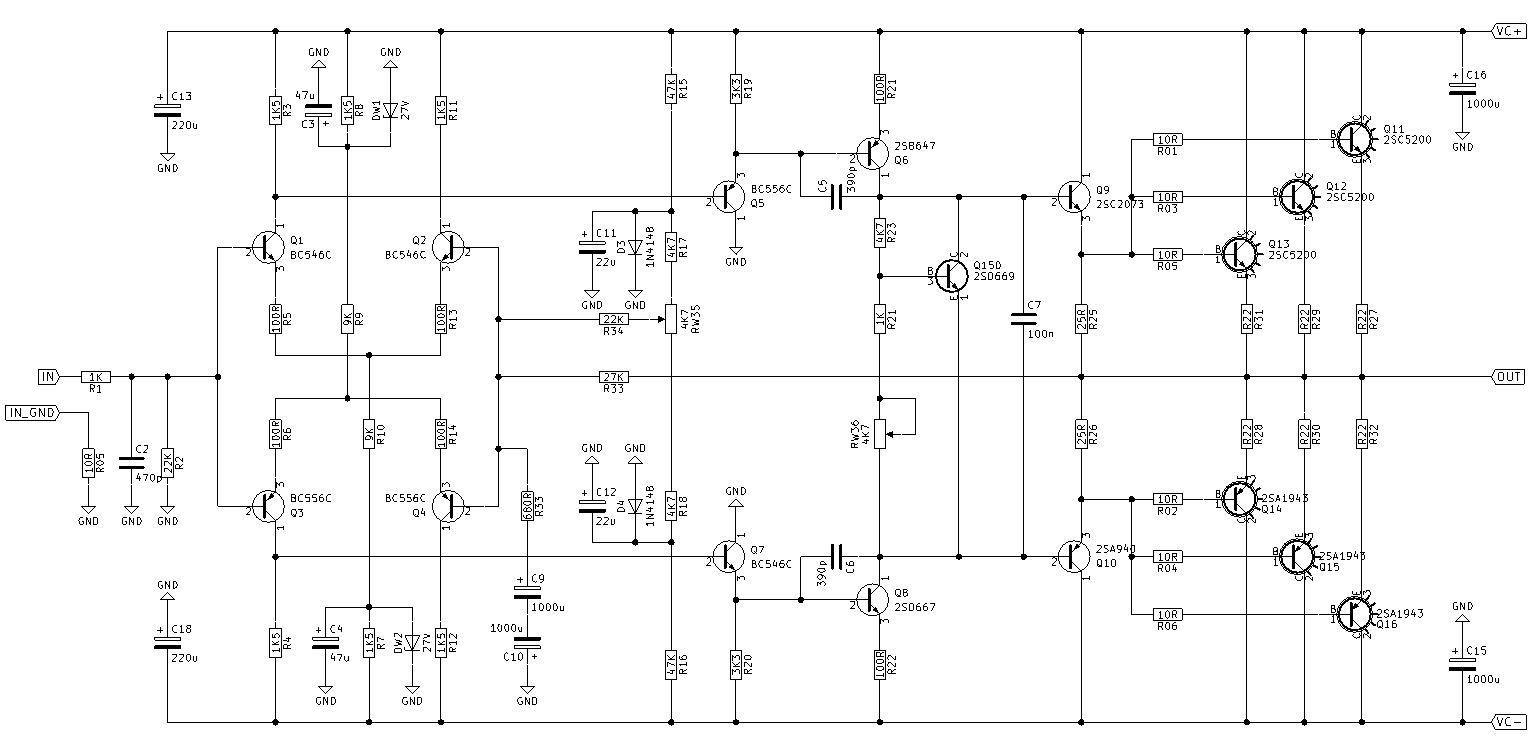

I have always wondered about "errors" on the KSA50 schematics that have been hand drawn from original circuits. I have never seen a factory schematic.
Anyway, I have modified some part values based on information in the Self and Cordell amp (and Randy Slone - RIP) books. The attached schematic is based on the Pinkmouse board, so I used the same part reference designators. The power supply bypass parts are not included for clarity.
In particular the emitter follower emitter resistor never looked right to me. With approximately 1.4VDC across R120 and R121 (3.3k) only a vary small current is flowing through the emitter follower circuit to drive the VAS.
Granted, all the klone amps appear to work OK with these circuit values, I think the original resistor for R120 and R121 was 330 Ohm.
Just like the error with the original compensation caps being 10 times too large (390pF vs 39pF), I believe these resistors are also 10 times too large (3.3k Ohm vs 330 Ohm). With a 3.3k resistor, the current in the emitter follower is approximately 420uA. With a 330 resistor, the current in the emitter follower is approximately 4.2mA. This figure makes much more sense to drive the VAS.
Increased power dissipation in the emitter follower should not be an issue, no matter what transistor you used. If it is a TO-92 (MPSA42 / 92) they might get a little warm vs them being "cool" with the 3.3k resistor.
The compensation cap connection has also been revised to include the emitter follower in the VAS local feedback loop they way it should be (according to most books I have read). Refer to C105 and C106 for the new connection method. This connection method properly loads the LTP with the calculated Miller capacitance and allows the emitter follower to drive the VAS base directly. Local VAS feedback is taken around both transistors so both transistors are compensated.
Both connection methods seem to work, but I believe including both transistor in the feedback loop yields more consistent, reliable results and may help damp tendencies for the circuit to oscillate.
The transistors in the attached schematic are the actual ones I am using in my klones.
If you are adhering to the original KSA50 circuit and are only using 4 output devices per channel, you can probably use alternate drivers; I have also used Toshiba 2SA1306B and 2SC3298B (These are identical replacements for the original Sanken 2SA968 / 2SC2238 that Krell used) for the drivers and they appear to be happy. I just happen to have a large stash of these drivers so I thought I would test them in the circuit.
I could not tell any difference in sound, but perhaps if you drive low impedance loads (or are using more than 4 output devices per channel) at higher volumes, there may be some advantage to using the MJE15032 / 33 drivers.
Main speakers I use are normally 8 Ohm.

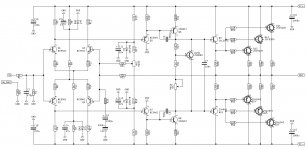

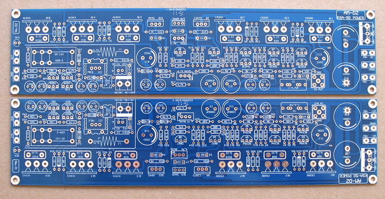

KSA50 clone
Thanks THD+N for sharing insights on the KSA50! I bought a couple of PCS from Taobao, China and they seem to be quite close to what you describe. I.e. the 390p capacitor and the 3K3 resistor.
There was no schematic so I reverse engineered it. I have seen at least a couple of other clones that look similar, for example the one from Delta in Denmark.
I will certainly try the mentioned modifications. What do you think about the values of the feedback resistors at 27K/680R? 22K/1K5 seem to be common values.
KSA50 PCB and schematic (drawing was just finished, so may contain errors):

The transistors in the schematic just reflect what is printed on the PCB. I have not yet decided which transistors I will use.
