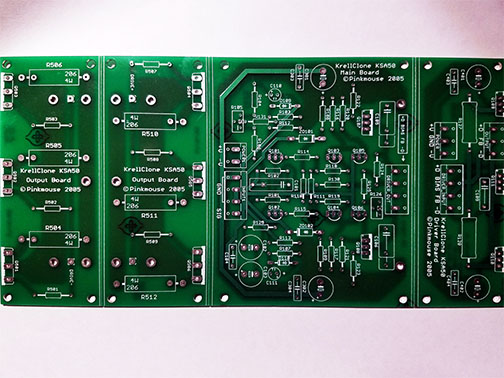

Are there any boards for these still out there? I've taken apart some old potentiostats that were going to be thrown away at work and have 7 pairs of MJ15003's and 4's on reasonable sized heatsinks, and 2 frame transformers of about 450 VA each (as well as two smaller ones not labelled). I was looking for a way to use them for a nice project, and found this thread. I've spent a week reading most of it, drooling over the pictures.
As the Delta Audio website is no longer live, I found what I think is the final version of the schematic prepared by Jan Dupont which was at http://www.hobbielektronika.hu/forum/getfile.php?id=34222. This is attached, as I could not find it in this thread, only links to the Delta Audio address from the post http://www.diyaudio.com/forums/solid-state/31077-krell-ksa-50-pcb-16.html#post516893, apologies if it is somewhere already.
I'm was planning on using this, but saw the updated values used by Pinkmouse. I'm curious as to which changes resulted from changing the transistors used, and which are improvements even if you use the original transistors. I've only just started with LTSpice for modelling, but I thought if I knocked up a model in LTSpice to check my understanding of the circuit, it might help to check what effect the changes had. Anyway, I've attached this in case it's useful to anyone, with the .lib files in a zip file.
I've seen some different boards available commercially, https://world.taobao.com/item/9797282148.htm?spm=a312a.7728556.201601086188259.3.BQS6Kg&scm=1007.12679.20634.9797282148 but not to the exact same schematic, so I'm wondering if it's best to make my own. I've got access to the kit to etch some boards, but I'll have to look into what is required.

There have been several different boards designed, as I understand it, which ones are
closest to the original factory design?
Hmm - Regarding Pinkmouse's and Jan's boards; i think they were both pretty faithful to the original schematic.
Pinkmouse's had a separate driver board. This is the one I have experience with. I never did any formal measurements. It sounded great on power up, and I didn't want to spoil it 🙂
Except for the semis, mine was thrown together using parts from my drawer - the thing has paralleled resistors and no name caps all over the place. has been enjoyable for many years. I want to make a better one. Almost time to re-cap anyway!
Come on board hoards - Fess up 🙂
Thanks! I meant with regard to the original layout, but all good points.
That is great that you built from parts you had, sounds a lot like what I do.
I figured you were concerned with the layout.
I don't think the PM boards are original layout - ish.
Jan's boards were single sided IIRC, and I recall the orig being double sided.
The Group Buys are long over and board houses have come way down in price. Maybe Pink Mouse would be willing to post the gerber files so guys can get boards made. I built Pink Mouse's boards and another set that used plastic outputs. Both play and sound beautiful.

I did post the gerbers. They're in the thread...Somewhere...
Sorry Pete, no spare boards, I only designed it, I didn't look after production.
I found an eagle file.
http://www.diyaudio.com/forums/atta...27d1115332689-krell-ksa-50-pcb-eaglekrell.zip
I have not found gerbers.
Mark did the group buy but then got pulled away by work so I finished shipping the boards out for him. Every order was filled and the extras sold. I have a set of both boards but i am keeping them for "one day" when I can build them.I did post the gerbers. They're in the thread...Somewhere...

Pinkmouse Boards
I think I have a new pair that I got from Pinkmouse and few years back (I am assuming I got them from Pinkmouse). I don't remember what I paid for them then and wouldn't know what they are worth now. I built the, lately referred to as Stolen KSA-100 and the amp is still working great so I have never started the KSA-50 amp.Thanks for all the info everyone.
