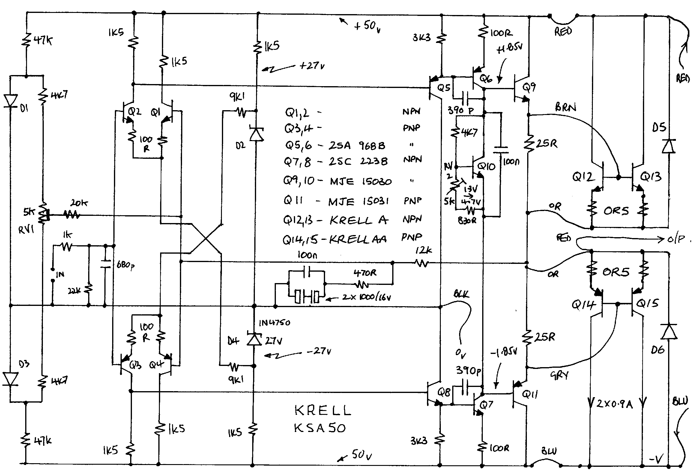

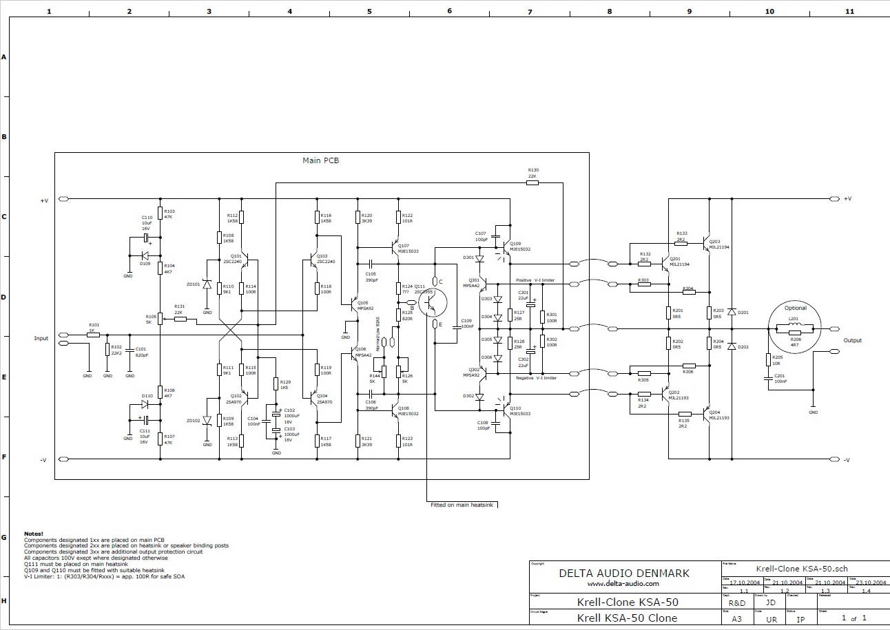

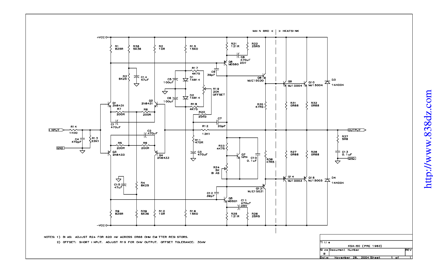

One more question for you guys so I don't have to tear into my KSA-50 to find out. I have one set of main board and driver board hooked up and run up to 20 volts per rail on my small Tektronix Split bench supply. This amp oscillates at quite a high frequency! I was able to stop it by adding another 330pf across C-105 and C-106, base to collector. Its specified as 390 pf on the Delta schematic, 330 PF in the Delta parts list and only 39 pf on all the other schematics of the KSA-50 that I have. So whats the correct value? I also note that C-107 & C-108 (100 pf) do not have locations on the board, so if need be those can be soldered across the bottom of the driver PCB.... My amp does not have C-107 & C-108 and without substantial tear down I have no idea what value cap I installed at C-105 & C-106. Do any of you guys remember if you ran into this oscillation and what value did you use at C-105 & 106? Also, did you even bother with C-107 & 108?

the feedback around the VAS is a bit unusual on this.
It has a double EF VAS/TIS.
normally we see the feedback cap from second collector to first base.
In this we see the cap from second collector to second base. That will behave differently.
Might be worth trying the "back to first base" NFB.
The Delta Audio BOM had c-107/8 as 100 pf
The Pink M boards had none nor the wiki BOM
I used 33 pf for c-105/6 ( PM pcb )
The zobel was always there at power up and never pulled to see if an oscillation was present
Unlike my 150 mono block that went crazy without it

I switched C-105 & 106 to 39 pf and I still have the strange oscillation issue, but I am able to cure it by removing C-105 and reinstalling the 330 pf at C-106. I am also able to quench it by jumping from the emitter of both Q-107 & Q108 to the feedback line with a 39 pf cap. I'm afraid I have a device or two that seem to be very high frequency sensitive... For now I am going to leave it this way.
