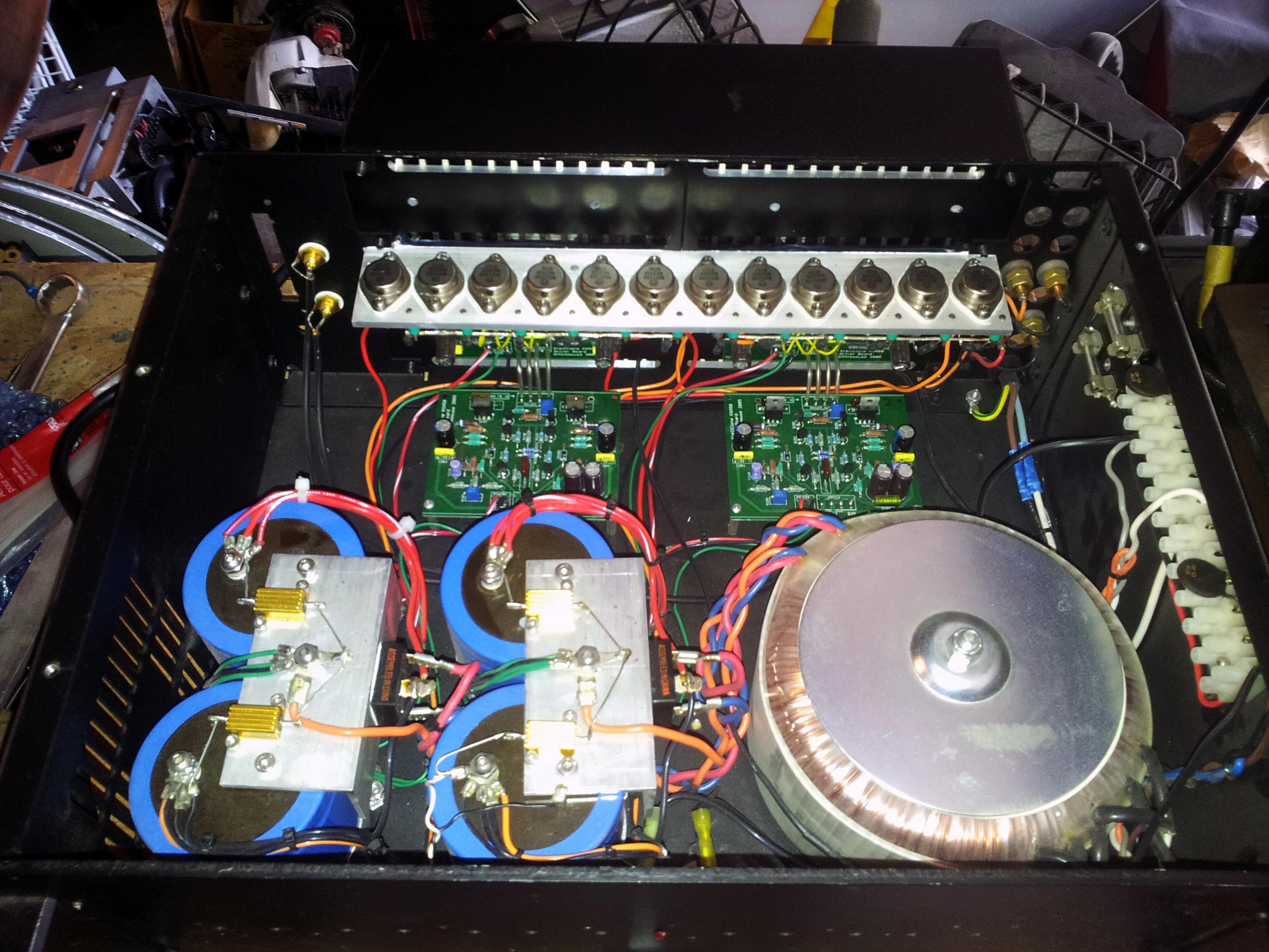

Thanks a ton mark, someone shared me the shert before, according to the sheet i got biased the amp but heat is massive and my heatsinks are huge arround 2.5kg of aluminum each were for industrial use
Yes, well... the heat IS going to be massive! If you think that's bad build the KSA-100! You really have to use forced air cooling on these amps at the minimum. When I biased my amps I used a combination of both the spread sheet and my Sound Technology distortion analyzer to set bias. The distortion correlated petty closely with factory specs at the specified bias on the spread sheet. So I'm still out as to what, if any, mistake there is in the spread sheet itself.
These are true Class A amplifiers unlike the Aleph which has a current mirror to increase efficiency to nearly 50%. I never did any calculations but I'd bet KSA-50 efficiency is down about 20% give or take. Krell even went to a sliding bias scheme in their later amps so they could control the heat and do away with the forced air fans.
Also, we did not follow the original part for part because the addition of two extra outputs has its advantages. It increases reliability becasue it spreads out dissipation better, allows higher power out and into even lower impedance's than the original KSA-50. I compared mine to an original KSA and mine had better bottom end. I also have a 1.2 KVA dual secondary toroid vs. the whimpy toroids Krell used.
Attached is a picture of my daily use KSA-50 that is well over ten years old. Its built on a salvaged AB Systems power amplifier and the heat sinks are relatively small. There are two 4" 120 volt ball bearing fans running at 60 volts in the box at the rear pulling air in from the front and exhausting it out the rear. The fans are only audible if you are right next to the amp. I lubricated both fans bearings with synthetic oil and that quieted them down considerably.
Transfo and bleeders

Mark. May I ask what are your transformer voltage and volt amperage are and what is your Ohm/wattage size of the bleeders on the can capacitors and what capacitance are they? I did build a KSA-100 with 40V/1000VA per channel and they are still running without a hiccup also and mostly never over 41C in temp (120V fans). I rarely bias over .380mA as it really doesn't affect sound and keep temps down. As it is, I can't go over 1/3 of volume control for fear it will blow out my windows but I do need to front the amp with a preamp so it will enhance the lower frequencies (big difference). I just finished diyaudio's Mezmerize B-1 buffer to see which is better, increasing current with the B-1 or voltage with a preamp, to perk up the low frequencies.
