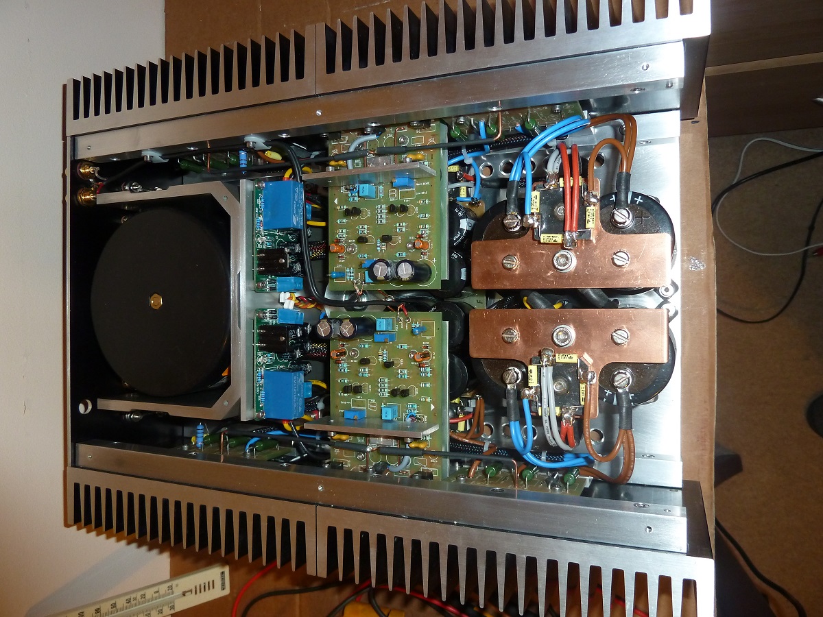

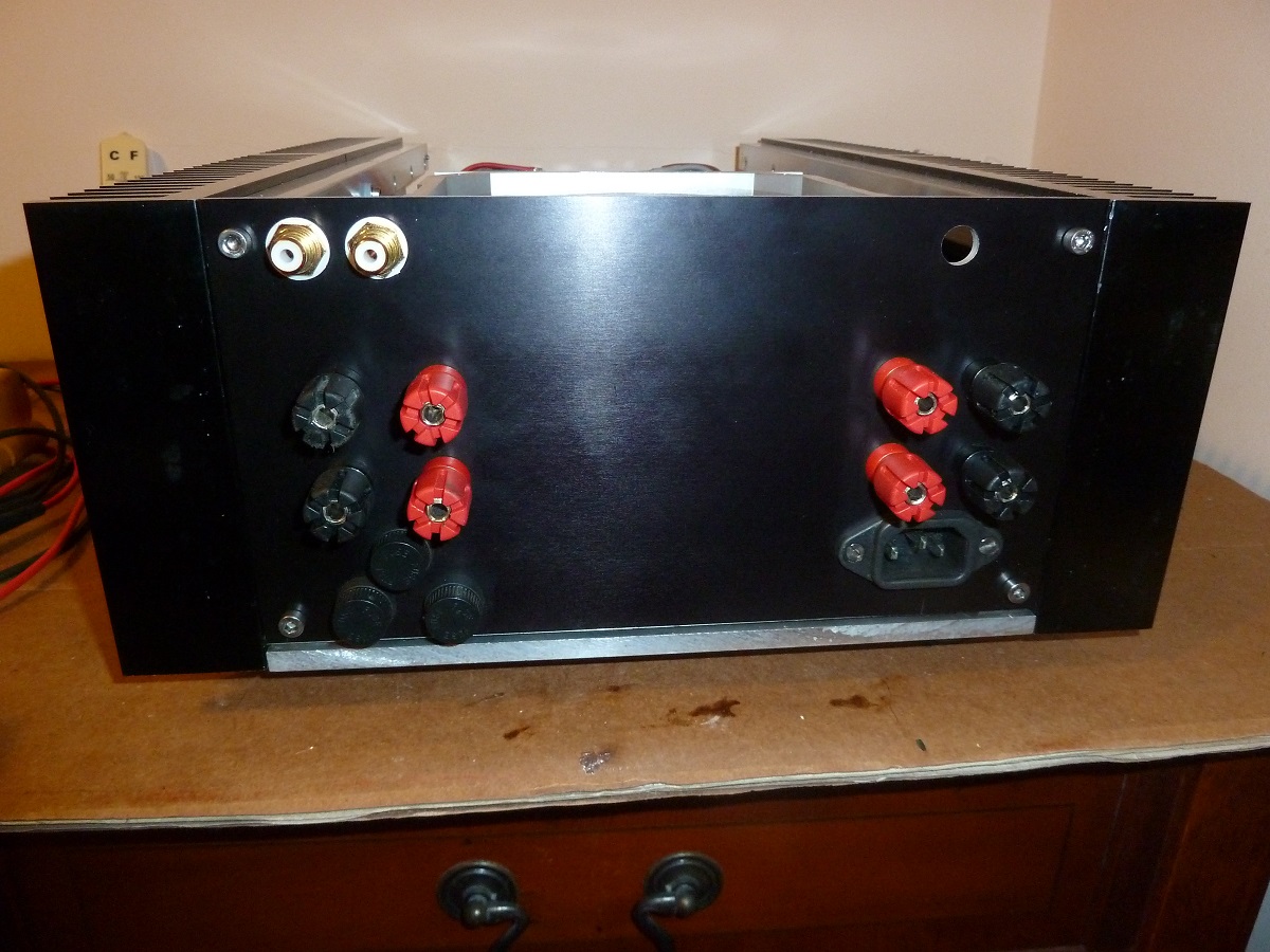

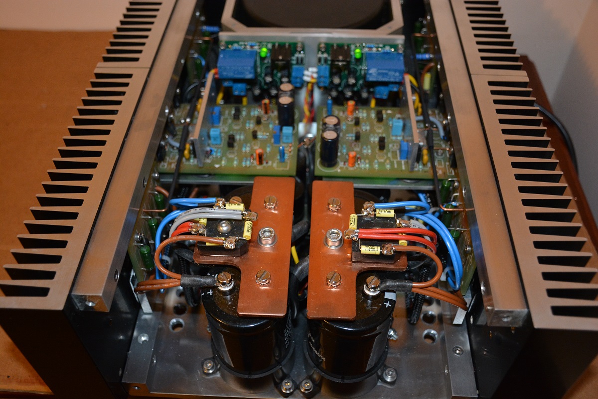

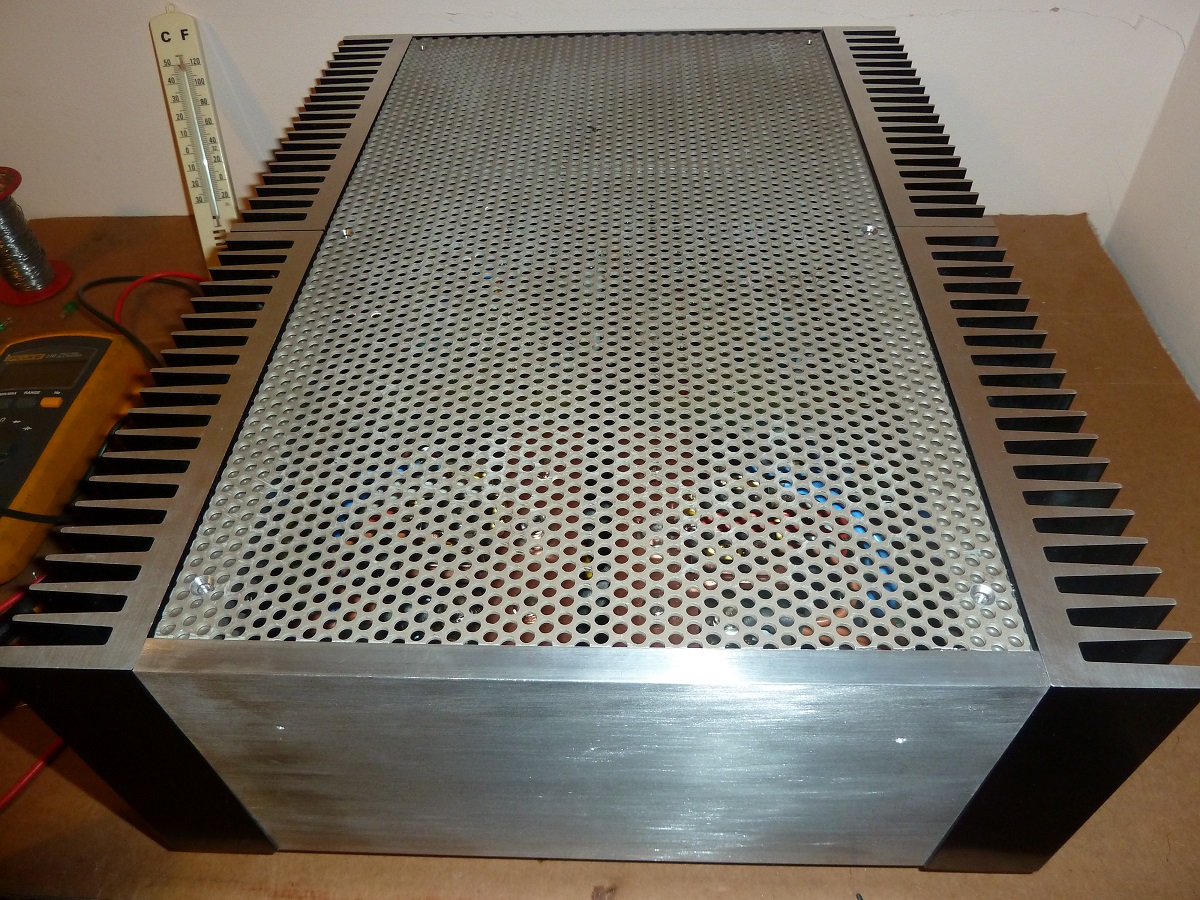

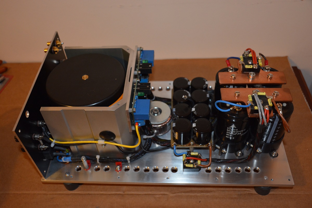

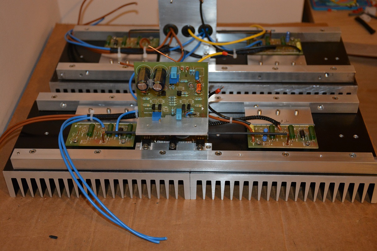

Here are a few pictures I took during the construction of my KSA25. It is dual mono construction with the exception of the "front end"which uses a seperate supply. The boards were modified slightly to enable easier mounting of the driver transistors to their heatsink, this was quite easy to do. Also component values were altered to allow use on 25V rails. The heatsinks are thermaly isolated from the base of the chassis to keep internal temperatures as low as possible. Also fitted are loudspeaker protection boards. All metal work was carried out using hand tools only, with the exception of a piller drill.
I decided on using a lower supply voltage and biasing for 25W for size reasons and passive cooling. Still quite a large and heavy lump.
Still working fine and very easy to listen to.

I like it, very nice.
I would turn the output posts 90* as I always forget to do it myself
Cables always route better horizontally

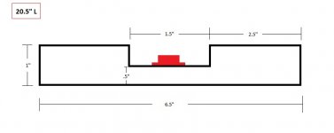

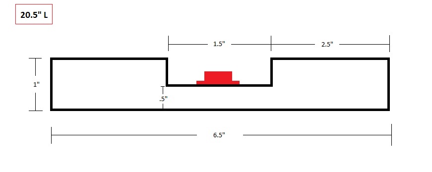

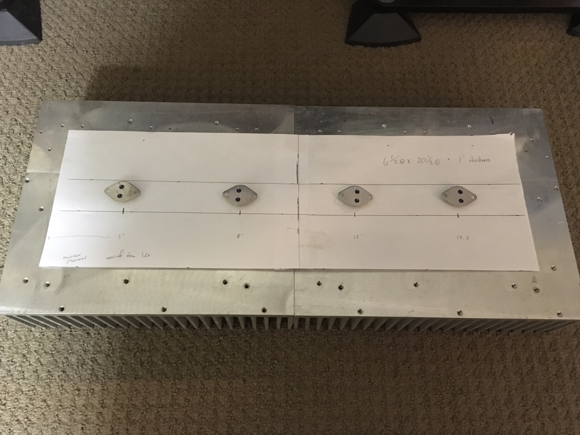

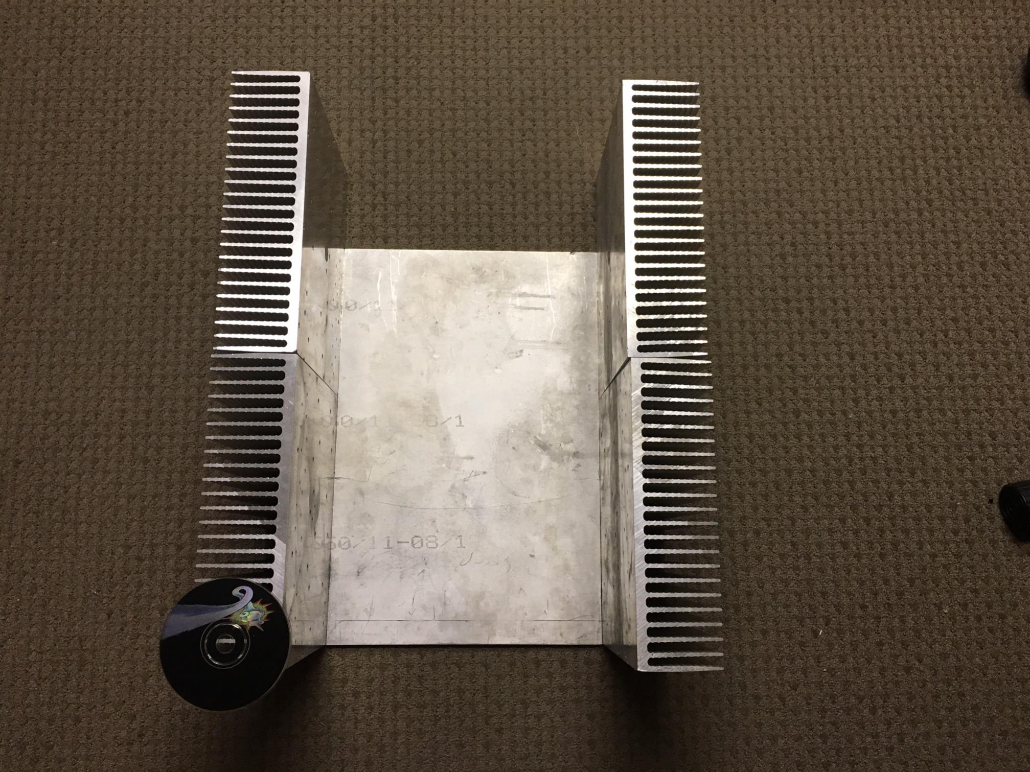

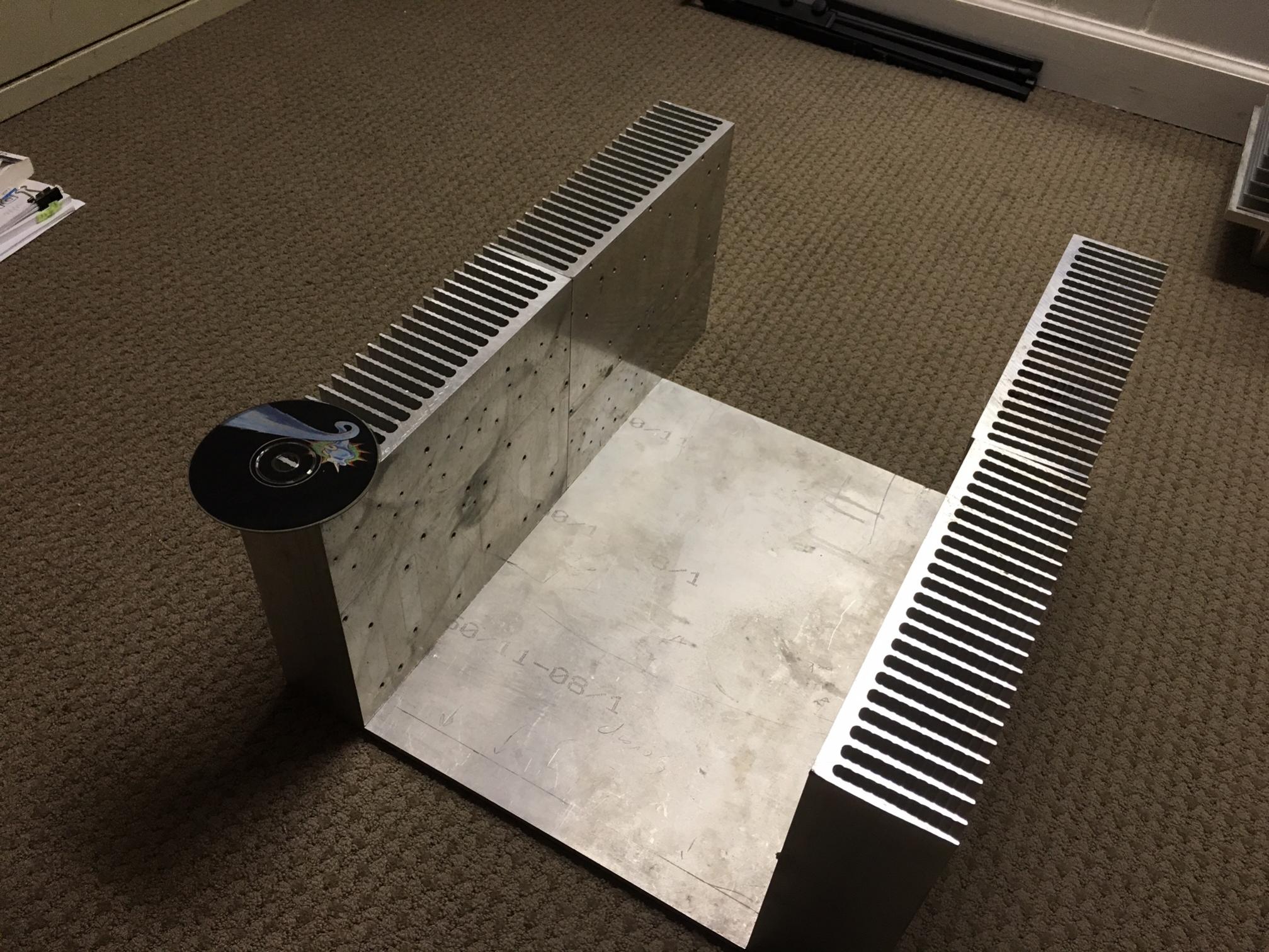

Thoughts on my ksa50 build:
-30-0-30 1000VA x1
-CCLCCLCCCC - maybe CCLCCLCCRCC to drop a few volts (yes, thats 16 caps)
-biased as high as heatsinks can safely handle
-Heatsinks are 10"h x 11.75"w x 3.25"high, .5" base - (2 per/ch)
-30-0-30 1000VA x1

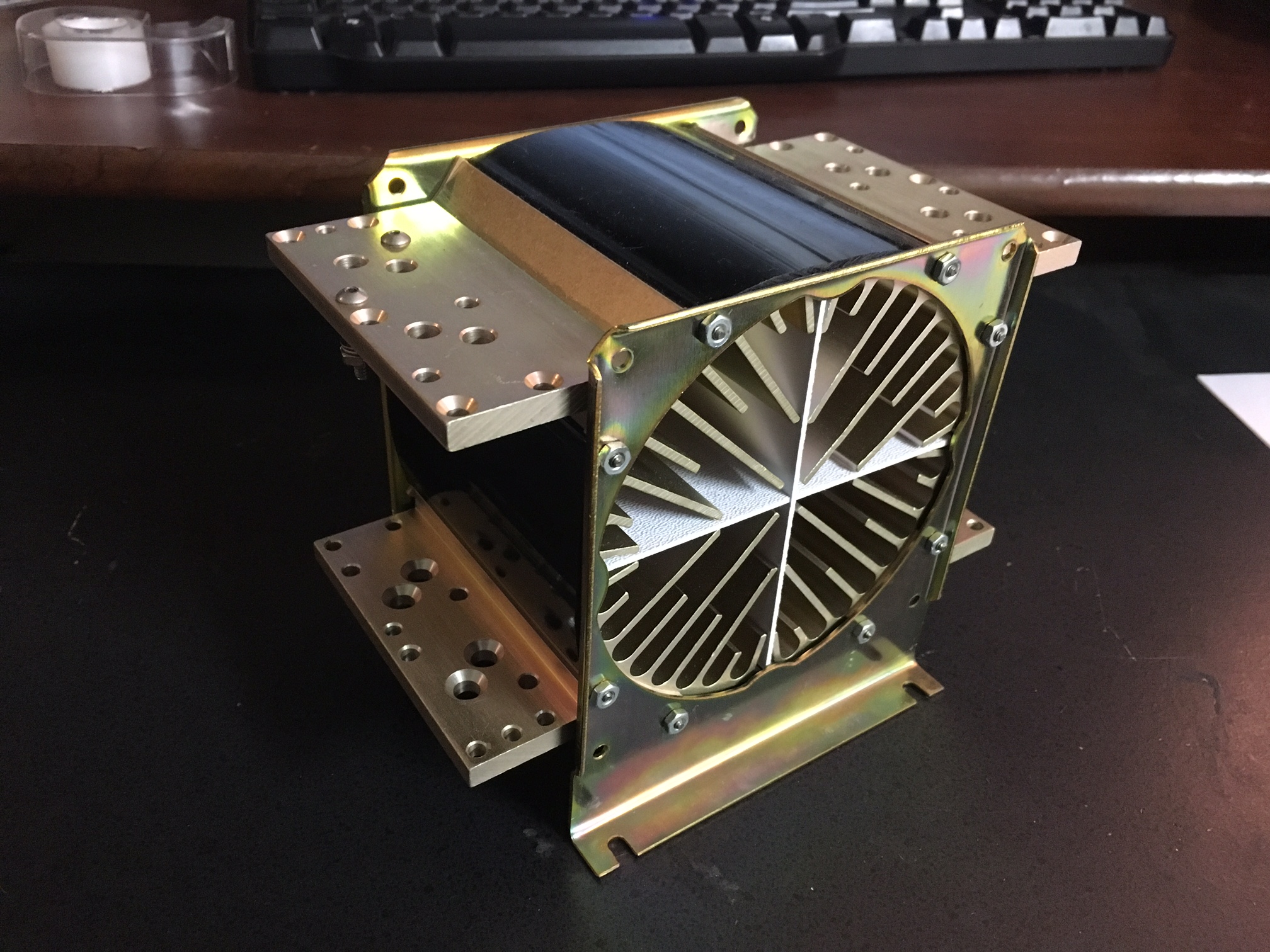

If i'm feeling lazy, use 1 of these per channel. Nice thing about these is that you can mount one transistor per quadrant without mica, as each section is electrically isolated.

Hello MEGA_amp
I just starting my KSA100 build and would like to know where you purchased the fan cooled heatsink?
Thx
Hi Bonanza, I have a pair of heat sink tunnels very similar. Also brand new Papst fans to suit them. Also some large passive cooled heat sinks if you don't want to go the forced air route. If you are interested ( or anyone else ) send PM and I will send pictures etc.
Alan
