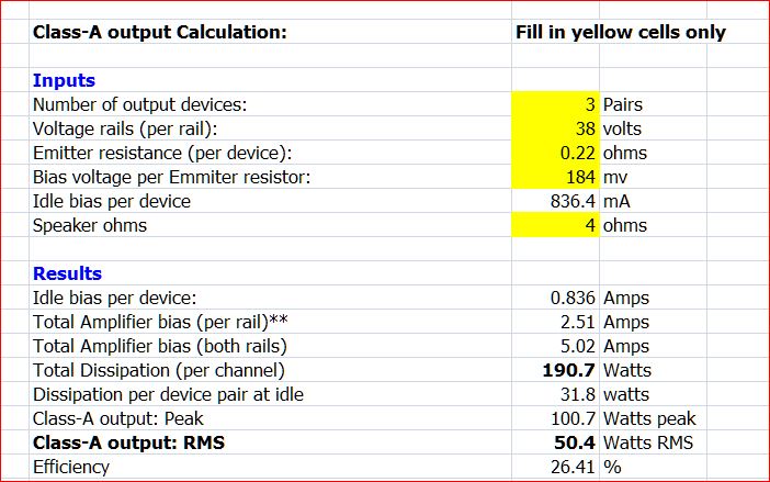

awesome john, im using the same transistors for output but with .22 resistors as the posted schematic, would it be ok to get around 640mv for 50w class A or more power
thanks and regars wolf
Wolf:
For three pairs (like mine), you will not need 640mv across your .22 ohm emitter resistors, just 220mv to get the 1A/Device.
As andrew indicated, 50W will be 1.9A, not the 3A total I have, so bias should be around 210mv across your .22 emitter resistor for 1.9A (50W).
Someone check my bad math!!

OK, I am wrong again...
"As andrew indicated, 50W will be 1.9A" - I think this is correct for 2 output pairs into 8 ohm.
"so bias should be around 210mv across your .22 emitter resistor for 1.9A (50W)." - for your amp, this should read 183mv across .22 ohm emitter resistor for 3 Pairs for 50W Class A in 4 ohm.

thanks john so it would be for 3 output pairs?

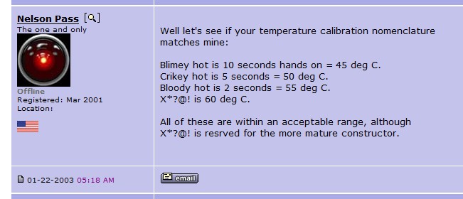

Nelson Pass has the Heat sink temperature "method" - basically when it is too painful to have your hand on the sink for more than 5 seconds - this equates roughly to 140F. You should not be hotter than that as you risk burning up your output transistors. Of course you can always just take a temperature measurement...
I got an email after a few years from DIYAudio... brings back memories ... I think you need my old excel spreadsheet to calculate Class-A power. Wolfintosh, here is your result to get 50 w into 4 ohms.
Just re-do the math for 8 ohms and it comes to 130mV across each ER gives u 50 watts rms class A.
EDIT
Not sure how I can attach an excel file it to this reply... I selected it, but does not show up here... any ideas?
