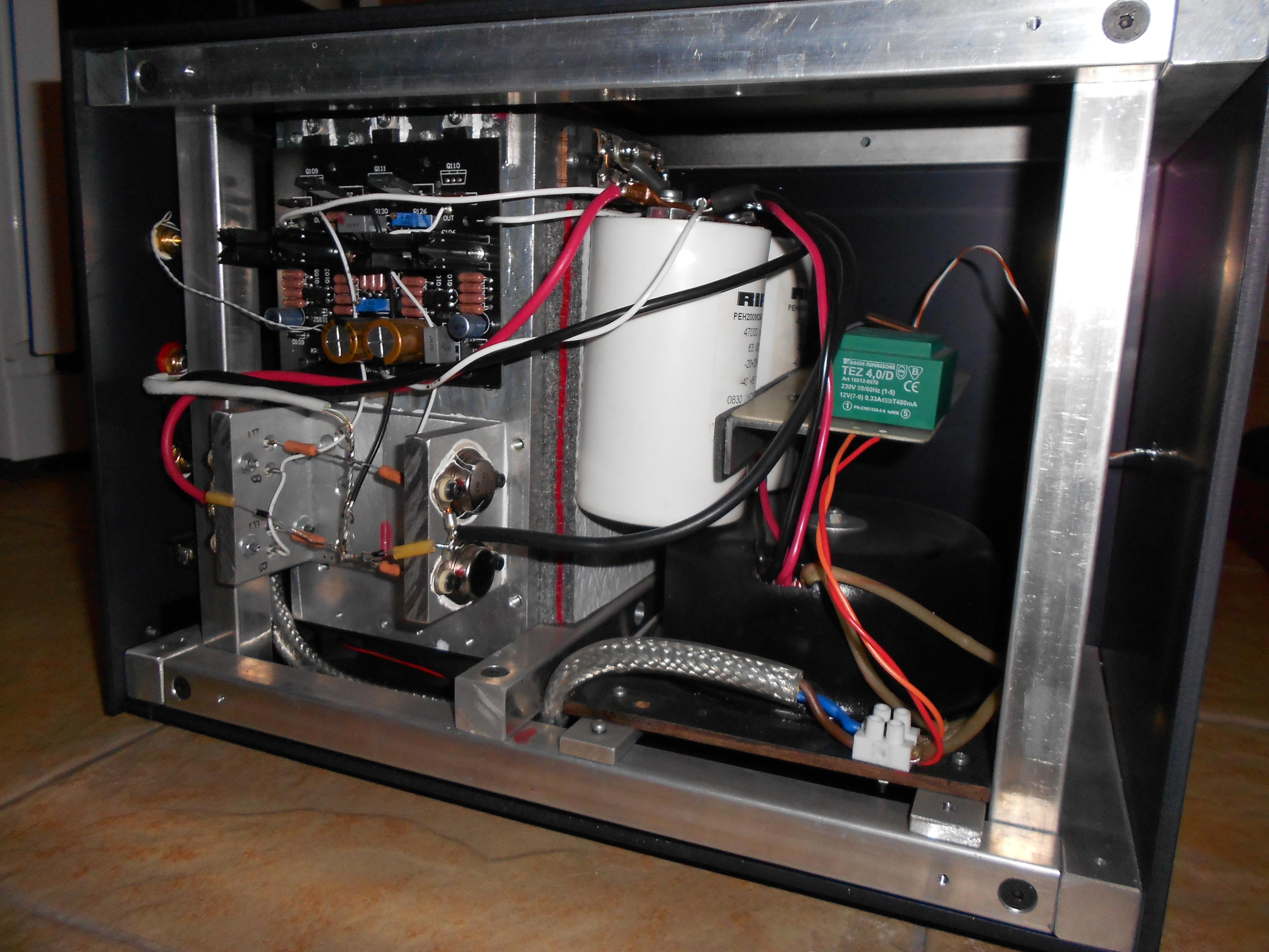

hi i have been building a ksa 50 and having some troubles with the power supply i am using 500va 50 0 50 toroidal transformer with 470000uf 63v capactitor iv been using a diagram found on google images but i keep getting 140v across across the plus and minus rails would anyone have a better idea i am a little stumped.😱
70v its ok for that transformer because its your rectified voltage 50*1.4=70 but for the ska 50 and that voltage check all transistor support if and also you will need more output drivers if not use a zener diode to reduce and regulate voltage
You have a very serious problem or mistake somewhere. Double check everything and remove semi's from the board and test them all. Also test output devices. 30 volt rails is a reasonable DC voltage on this amplifier and shouldn't cause any headaches. When you get it working again use a variable to slowly bring it up and also a scope to be sure the amplifier is not self oscillating. KSA-50 is an extremely simple, stable reliable circuit. Mine is now 9 years old...
Thanks Mark, ill check it again i tested with multimeter an seems that one of the masa transistor is the one that got broken, im thinking about oscilation because it failed after i played a 20hz reference tone, with music worked for hours
Wolfintosh, I presume you mean one of the 100ohm emitter resistors for the pre-driver transistors ? What was the total bias per rail you were using with 30V rails ? What circuit are you using-- the Delta Audio from the start of this thread ? What load were you driving into ?
Alan
Alan
thats correct, the bias pot i have it adjusted almost halfway at normal bias a 5k pot, im using the delta audio version , my goal its to run it with 42v rails it is been tested with my lab power supply, i replaced the masa transistors and some 2240 and 970 the ones that are placed almost together and it worked again, i want to tweet it and prevent this, also i made measurments with the scope at school an the signal look perfect without load, it an 8 ohm load with that i get a bit of distortion on politeve cycles of the sinusoidal wave produced by the function generator
