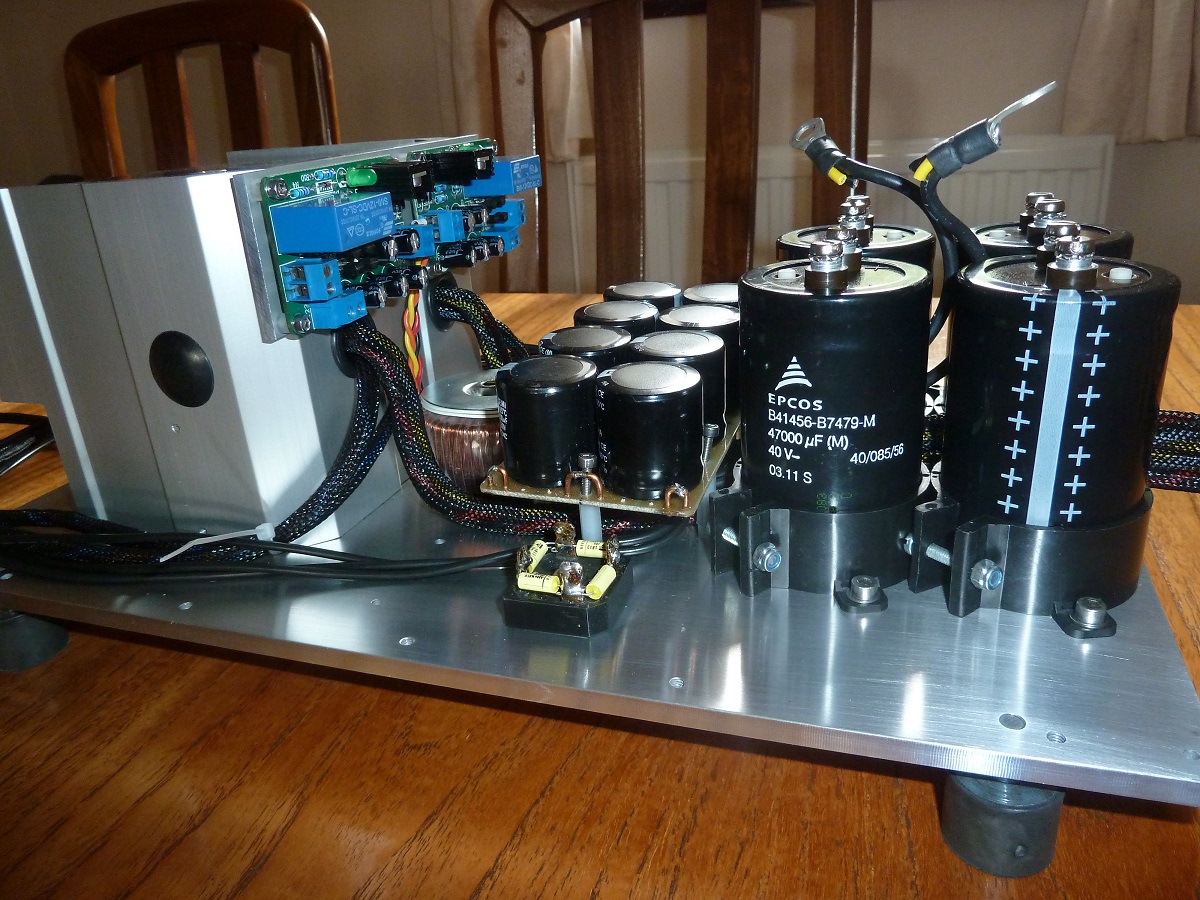

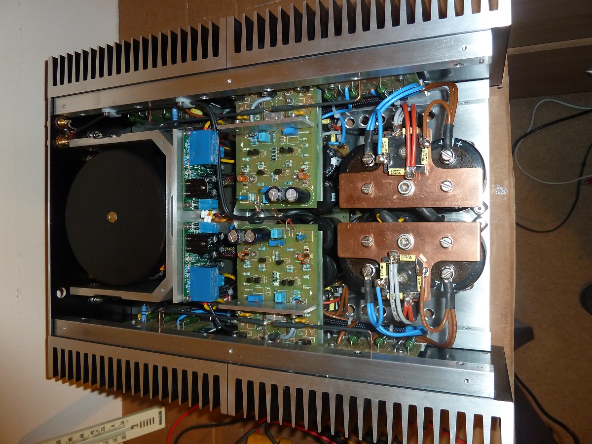

Hi, I built a Krell clone several years ago, it is still in use today.
I used Delta Audio boards that were modified to run on +-25V rails.
Duel mono construction throughout with separate supplies for the front end, triple plastic output stage.
I chose lower voltage rails to make heat dissipation more manageable with passive heat sinks. Even so with 1.6A bias the sinks still run quite hot ( about 50C ) Sinks measure 400 x 130 x 40 mm, dissipating about 70W per channel .
Heat management is the biggest problem when building class A.
Best Regards
Alan
