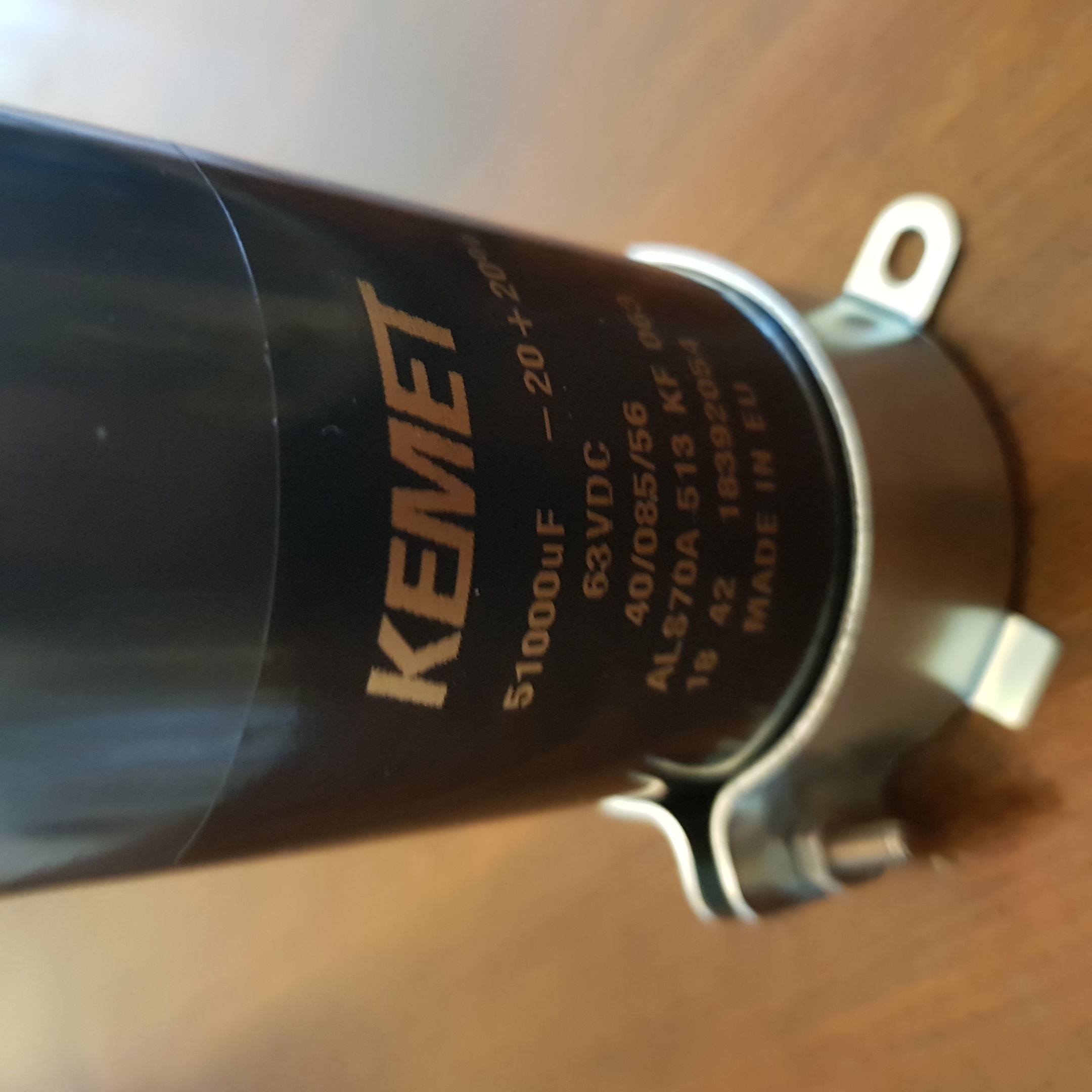

https://content.kemet.com/datasheets/KEM_A4034_PEH200.pdf ... 7milliohm ESR at 47000/100V...lifetime 19000hours for voltage and current...what do you think ?
ALS70A513KF063 KEMET | Mouser Norway
I will be using these, mainly due to price. Paired with KBPC bridge.

I simulated the PSU in PSUD2 (30VAC, 1.5 per rail)...current ripple around 13A...but voltage ripple is 300mV with a plain 47000uF filter...300mV is not a dream...
Now, lets look at LCL: your current rating of the 24000uF/63V...it is at 13.2A, so maybe good enough...24000uF-1,5mH-24000uF brings your voltage ripple down to 30mV !!
If you want to optimize a little the transient response / resonance you start maybe with a smaller 13000uF/100V (rated at 14.2A) and let a bigger 33000uF follow. When you do this with a Hammond 159ZJ 10mH in between, we are now down to 6mV !!! And at a nearly perfect impulse behavior (R=0,4ohm in between Caps).
Energy storage capacity is the same or better, costs are only marginla higher...so why is not everybody using this path...

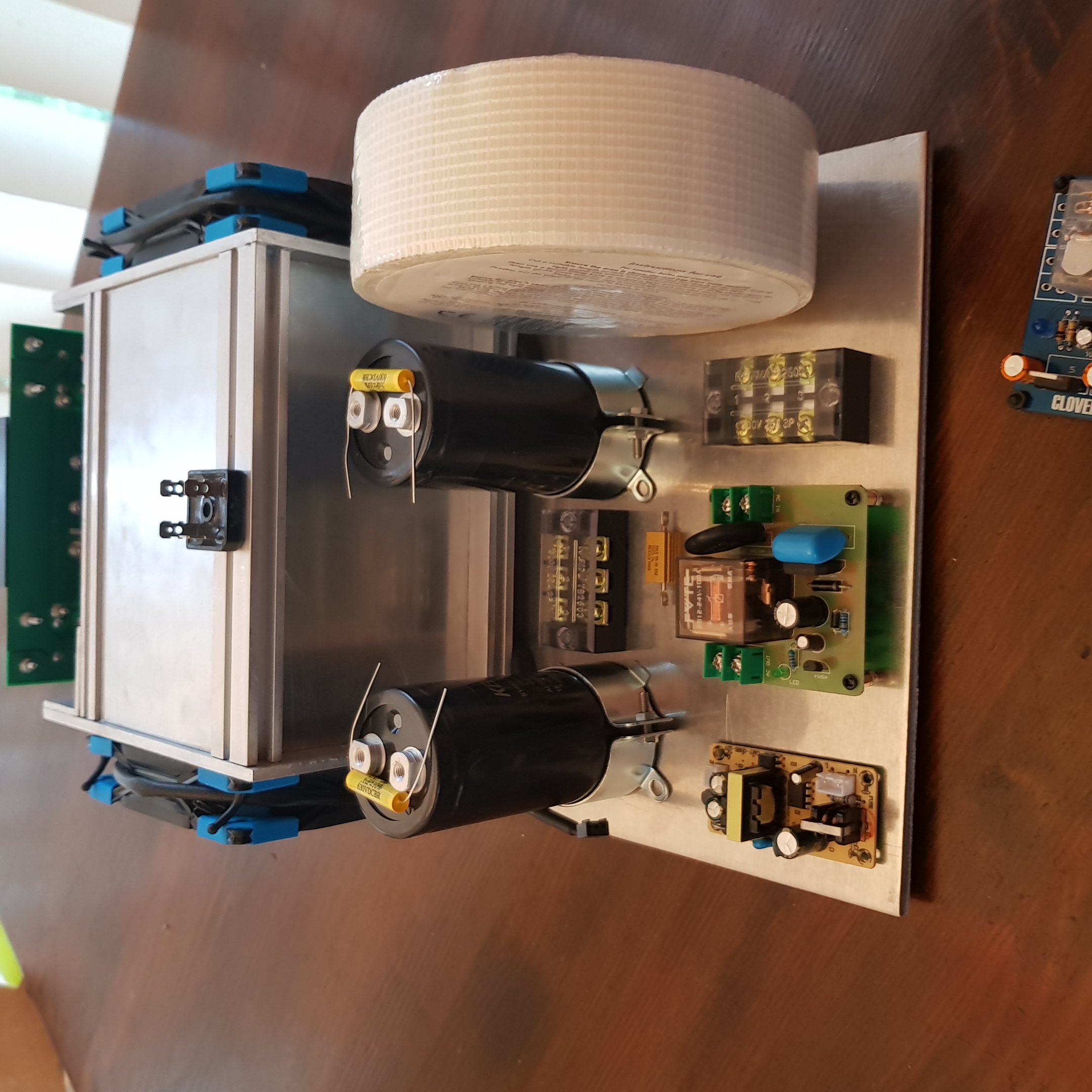

Hi I was just wondering would 2 x 500VA transformers be large enough for my amps 3 x MJ21194G and 3 x MJ21194G per channel.
I have added an extra MJ21194 /93 as my heat sinks are quite large and double fan cooled in push pull.
750VA transformers are a bit of a tight fit.
Also I have contacted the transformer supplier and he has told me that 230v/36v transformers actually gives out 37.5v x 1.41 = 52.3v on my UK voltage as my mains supply is 240V at sockets.
He does a 33v version which I am guessing will give me about 34v x 1.41 =48v on 240v at sockets.
I have read expect to loose 2v or more after rectification and load so would 37.5v be a bit high or 34v be a better option.
sorry to be a pain as i am no good at the maths side of electronics.

Hi Dave,
Which boards will you use, red or green? If you'll use red ones, your transformers will be just fine. Red boards are used for ksa50mk2 and ksa100mk2 (same circuit) so a little higher voltage should not be a problem, just use a higher wattage zeners (3W).
Btw., if you are planning to add a clc or crc filter to the power supply it will additionally cause a rail voltage drop.
500VA transformers will also be good.

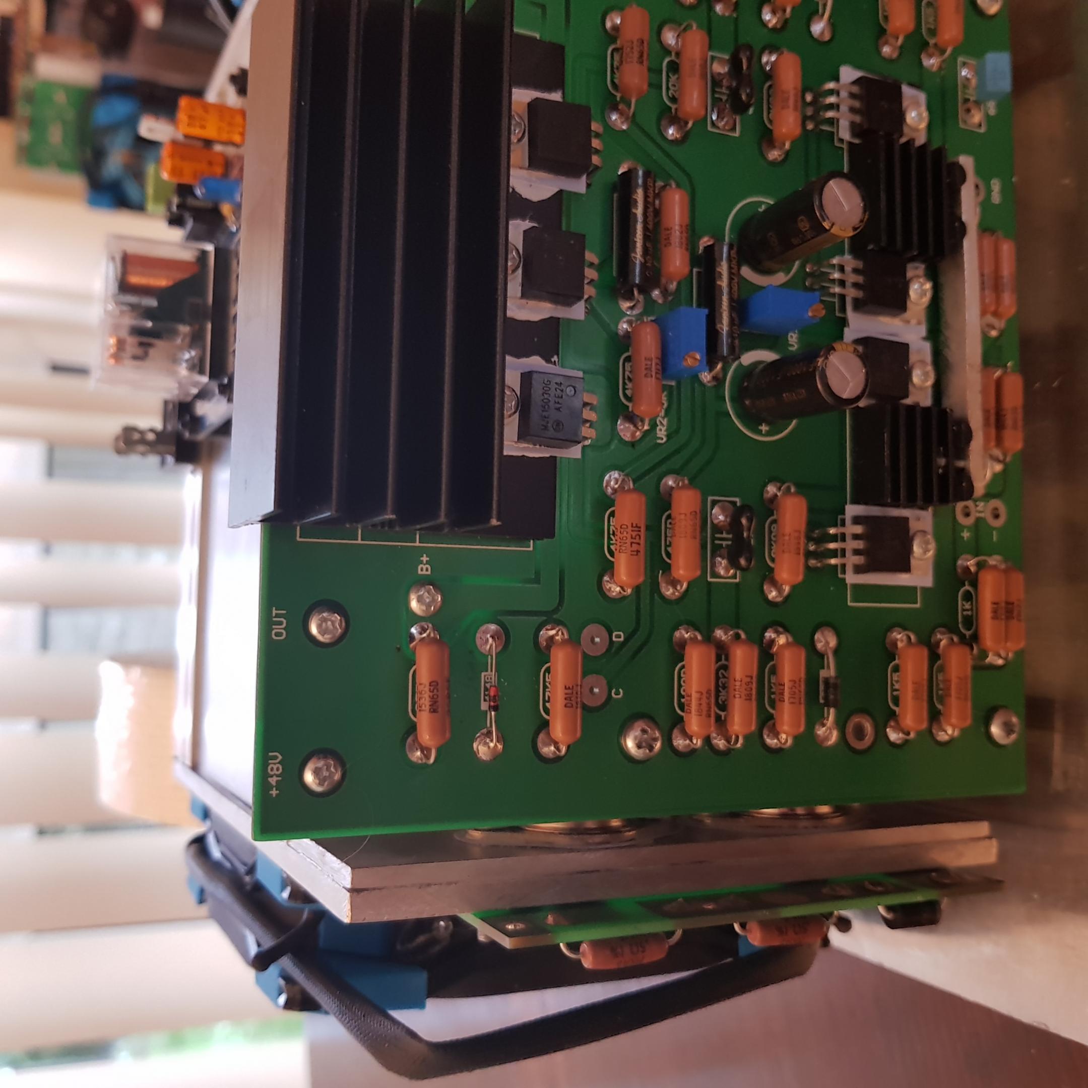

Hi Neychi thank you for your help as you can probably see this is my first amp build.
By boards are green ksa 50 mk2 with zener 3w 27v diodes.
My power supply is just 2 capacitors like original krell but with added 0.1uf capacitors on each cap for extra filtering plus I was going to add some kind of bleed resistor to each cap.

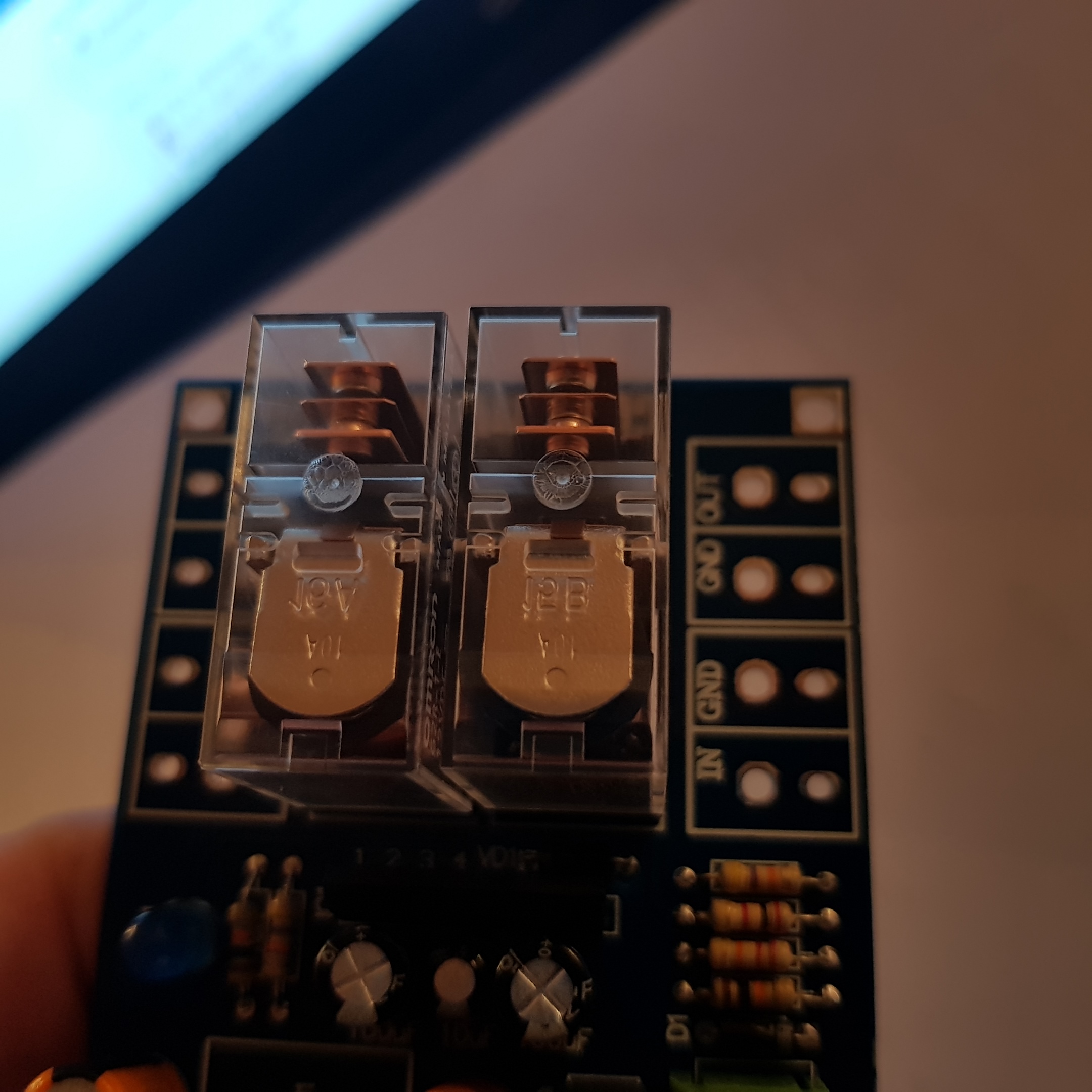

All of my components are from mouser electronics or RS components except the 2SA970 and 2SC2240 mouser and RS did not have these so I got them from a company called cricklewood electronics.
The only components I got from ebay was my soft start pcbs and speaker protection pcbs.
I did not trust the omron relays on the speaker protection pcbs so I changed them to bigger 16A omron relays from RS components.
I have bridged relays to run as mono pcb speaker protection instead of stereo.

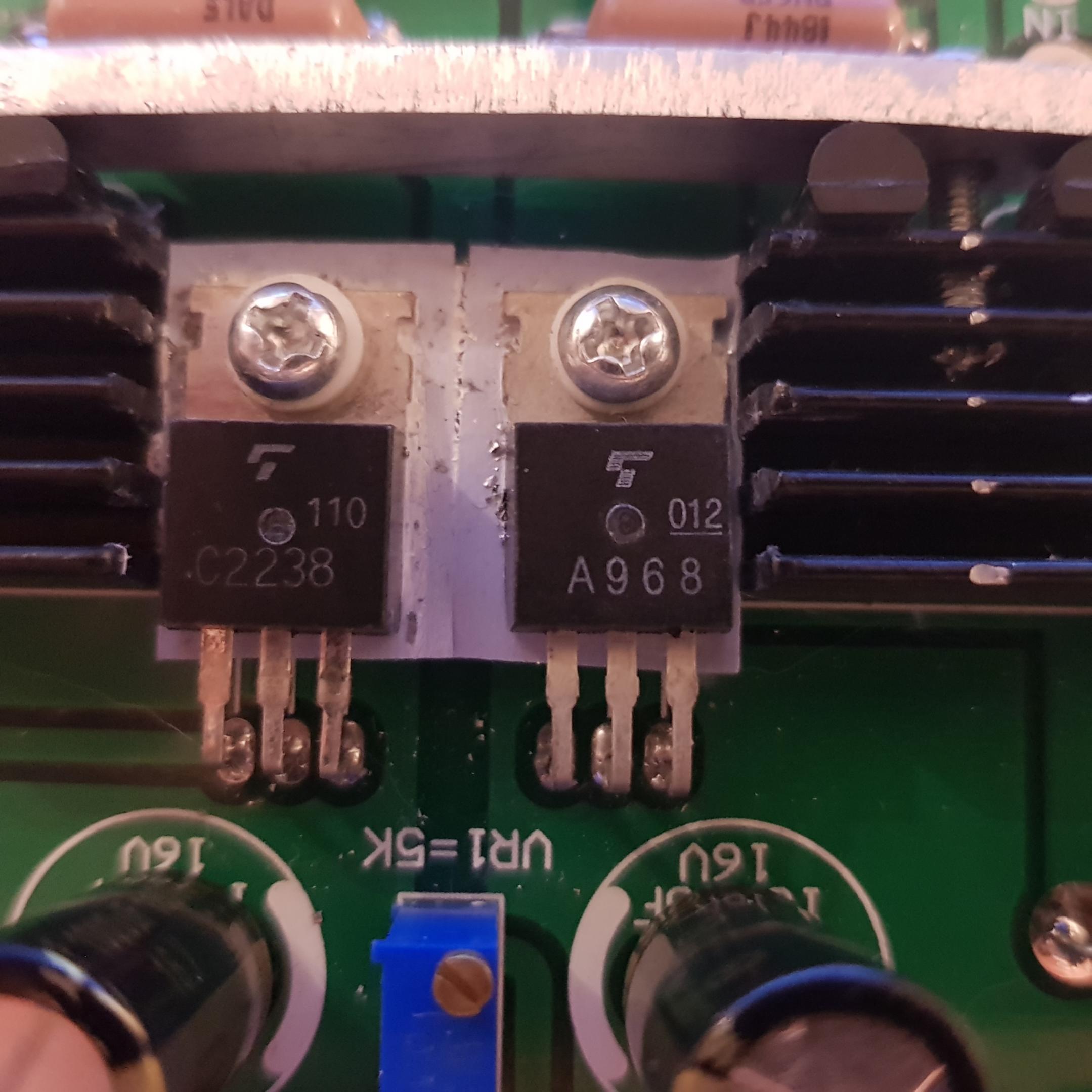

I'm afraid I do not have good news for you. These are definitely not original Toshiba transistors, but some generic Chinese type. Identical are selling on ebay. Today it is almost impossible to find new, original Toshibas. It would be better to try to find replacement transistors like Sanyo 2sa1011 / 2sc2344 or Toshiba 2sa1837 / 2sc4793.
Thank you Neychi I will change them.
It looks like mouser and RS components do not list them so it must be those I got from cricklewood electronics because no components come from ebay for that reason.
I will check for Sanyo or toshiba.
Is Sanyo or Toshiba best or does it not matter.
