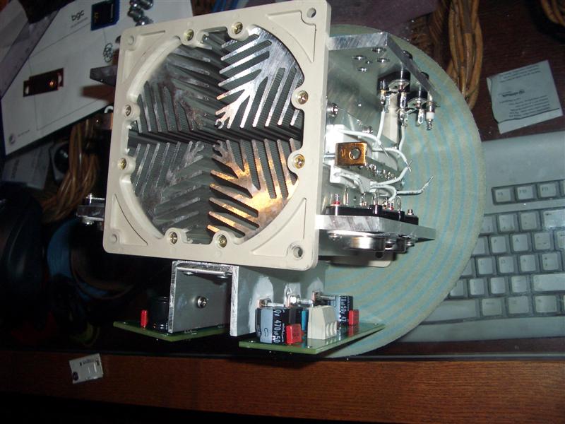

Will the drivertransistors be a problem? This was all I could come up with to mount them and I used conductive paste between the profiles which are bolted to the larger sink.
If the cooling won't be enough then I must try to find something else so I don't fry them...

Personally I think they need more heatsinking. I live in a dry area and in summer the heatsinks that normally run cool in winter become quite hot in summer.

Damn! I was already told that but I hoped that he had seen wrong and that I could get a second opinion. But then I'll just have to see what I can come up with. The only available space is above the mainboards and I still need to be able to reach the pots for adjusting gain and offset. Well, when there's a will...Personally I think they need more heatsinking. I live in a dry area and in summer the heatsinks that normally run cool in winter become quite hot in summer.
EDIT
What if I replace the profiles with a solid chunk of aluminum? say 30x30x100mm?
EDIT2
The drivers can be mounted directly on the large sink instead of using the profiles but then only the upper half of the transistor is in contact with the sink. Will that do?
Hi kmj, indeed nice design and this gives me a trigger again to finish the "raditor" once....
Some questions:what is the capacity of the powersupply capacitors?
They seem a little small to me.
Where did you get the nice topplate for the heatsink?
For more cooling to the drivers you could make a new topplate with extension plates bended downwards to mount the U-type alu profile.
Or an extra plate mounted to the flat parts on the sides of the heatsink(near the TO-3's).
Good luck, Loek

Kmj, I'd just try it as it is first, you may well be fine. And if they start getting too warm in the summer, you've had six months to think of a better arrangement. 😉
Each has a capacitanse of 68000uF and can handle 50V. There are a pair of these for each channel so a total of 136000uF.Some questions:what is the capacity of the powersupply capacitors?
topplate? it is two pieces which I salvaged from an amp I bought from China, it had something wrong with it and the warranty was kind of unusable so I scrapped it. Anyway, I took the top and drilled the big hole in it and later had it powdercoated as the rest.Where did you get the nice topplate for the heatsink?
If you litterally mean som part of the heatsink then I bought it on an internetauction for about 45$

Jozua said:more heatsinking
Personally speaking, the logic escapes me.
The U-profile looks to be at least 3mm thick, and i gather it is thermally coupled to the cooling duct.
The area between 2 of the extrusions is a cold spot of the cross-section, only better place to put the driver heatsink would be spot in the middle of the duct.
I see 6 bolts connecting the drivers heatsink to the duct, and plenty of space around the U-profile.
If the drivers heatsink is in good(flat) contact with the duct surface i'd try it first, you might be in for a surprise.

right on both accounts. However, it isn't a U-profile but two Ls so to speak.The U-profile looks to be at least 3mm thick, and i gather it is thermally coupled to the cooling duct.
It is in flat contact with the exeption of a few mm in the middle where the different pieces meet. But close enough i recon.I see 6 bolts connecting the drivers heatsink to the duct, and plenty of space around the U-profile.

kjm wrote: I don't get a word of that sentence and explain a bit more, will you
Hi kjm, what i meant was a plate mounted to the back of the U-profile(2 L's) with the dimensions about the size of the heatsink, i am not so handsome in 3-D drawing as Gewa...
But indeed i should try it first as you have build it.

KMJ, very nice amp !
One (more) thought about heatsinking: Personally i don't see the point of thermally coupling devices that need cooling to a heatsink that's already hot.
Couldn't you mount the drivers with the l-profiles to the dividing-plate between the powersupply and the amplifier-circuit ?
Just a thought.
I suspect however that it will be fine the way you arranged things now.

The didiving plate is powdercoated so I think that the thermal conductivity is less than that och the aluminum heatsink. But even if not, the dividing plate is made out of steel and it would be VERY difficult to get a handheld drill to fit and make the necessary holes.Couldn't you mount the drivers with the l-profiles to the dividing-plate between the powersupply and the amplifier-circuit ?
I suspect anyway.
