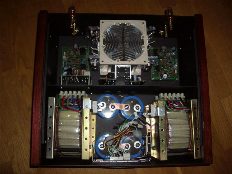

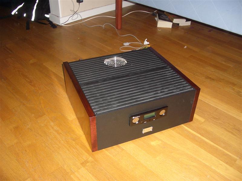

Hi guys, I've finally disslocated my thumb and done some soldering. I'm two zeners short, a 12 and 5V regulated supply and some wiring left but then my radiator will be finished.
I was forced to use some aluminumprofiles to mount the driverboards on and I hope that they will provide enough cooling, if not I'm in trouble due to the usual problem with space.
Some pictures of my small but heavy friend.
In the front half, transformers, Caps, fancontroll and soon the regulated supply for the controll. In the back all Krellboards and softstart are placed. Underneath the sink there's a 120mm fan which hopefully will blow upward.
Cool looking amp you have there kmj 😱 😱
What is that Silverstone thing in the frontplate?
Regards
Regards

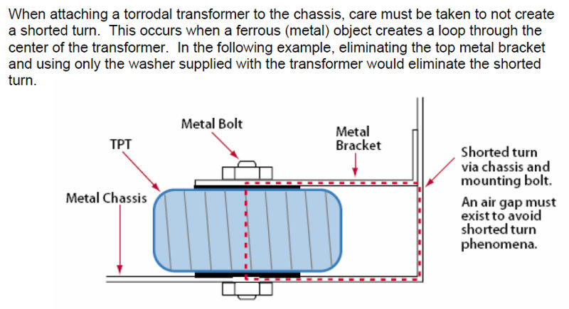

I hope you don't have central bolts through these toroids .........
Thats a fancontroll for a computer and thats what the reg-PSU is for 🙂What is that Silverstone thing in the frontplate?
I stole the idéa from LGreen
No central bolts so there shouldn't be any problems 🙂I hope you don't have central bolts through these toroids .........

I must have missed the discussion around the middle bolts... so is that a bad thing.... or just unfashionable?
I think he refers to that a centerbolt combined with these transformers mountingbrackets would create a loop. Like when you let a bolt fastend in the bottom plate go through the transforrmer and then fastened again in the top. Which is bad
