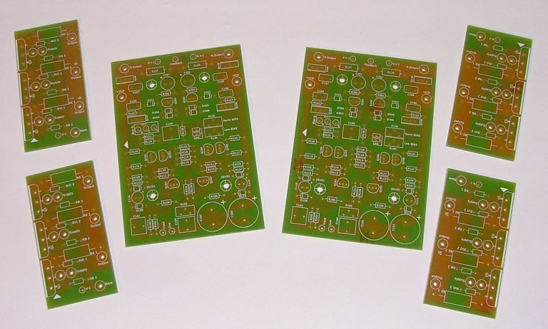

Hello !
If anybode has any spare boards for the KSA50 for sale, I would be interested - og ir anyone knows where they can be bought - I need 4 pcs.
I have mailed Mark G a couple of times without result....?
Cheers !
Buhl
Cheers !
Buhl
Buhl said:Hello !
Cheers !
Buhl
you must be patient waiting for Mark's response;
he's more out of home than at home,at least to my knowledge 😉
These are 100% sure from the DIYaudio GB!
These are the "Jan" boards, they were in the GB before the "Pinkmouse" boards were designed.
I build my Krellclone with these boards.
Wim, sorry bout that, I was to quick on the trigger😉 Totally forgot that Jan Dupont made those boards earlier on.These are the "Jan" boards,
Steen🙂
Okay, okay, I am convinced😀 But they dont look much like the Pinkie boards I have😀These are mine, they sure look the same to me
Steen🙂

- Krell KSA 50 PCB
