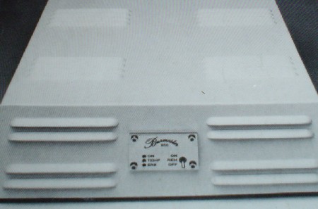

The pic down below is a bridged 100/8 monaural amp that had those Toshiba numbers.
It could be set to 2/1 ohms use through a lower PS voltage, 100Wattsthat in 2 and 160W in 1 Ohm.
1/2 the rail voltage and 2 times the output current=> same VA rating for the transformer.
