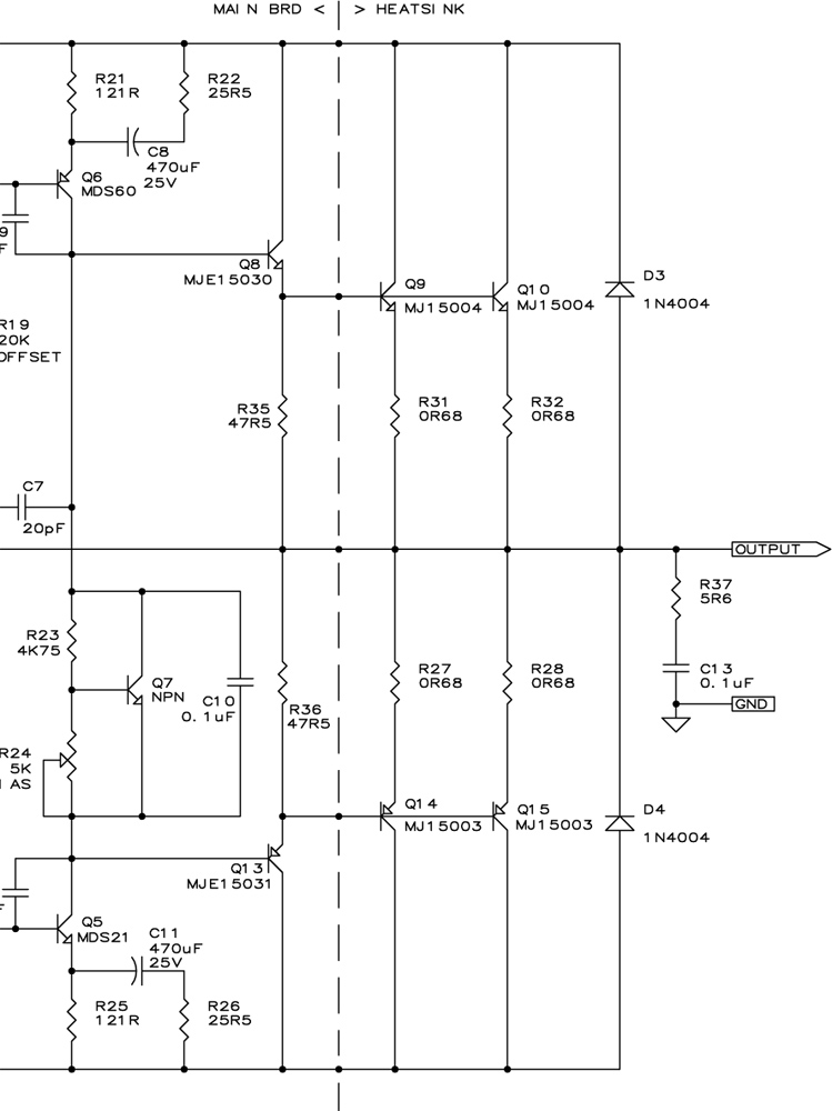

Setting up TO3's
Hi T,
I guess I didn't lay out the previous posts well. I used the schematics only to ilustrate the lack of the resitors connected to the base of the outputs and I still have the question why or why not use them. Why can some designs allow and others not but some both? Very confusing and I'd like to know more without getting off the rails.
I'm using MJ15003/4 three complimentary pairs per channel. I have Mr. Pink's Boards not Jan's.
Since I have three output PCBs with two TO3's on each, where should I place the 1N4004 for each channel? Does it matter? Do folks have a preference.

Hi KJM, if your drawing is a view on the pins the schematic is OK, only the names are wrong:
the left and right(outside) text in a box has to be P-in and N-in.
The Onsemi drawing is a view on the pins.

base resistors...
...are not part of any of the original ksa50 schematics.
They have the beneficial effect of making the output stage into a more predictable, resistive load to the VAS. They also have the less beneficial side effect of making output transistors that are lower in gain get less drive current, ie they compromise the current sharing in the output stage.
The 'catch' diodes can go anywhere convenient, they clamp the output voltage to the supply rails, defending the output stage...
HTH

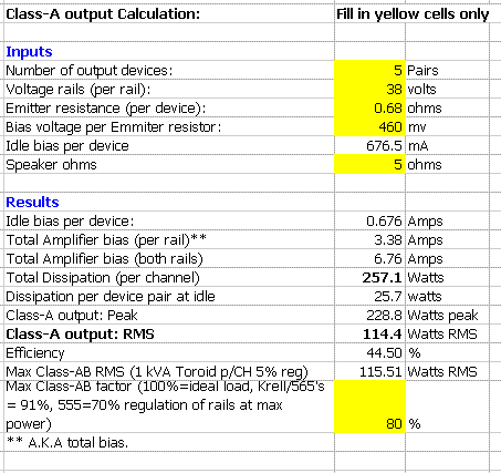

no, it does not all add up.
130W ClassA into 4r would require Iq=4A (already discounted).
Full ClassA into 6r would require Iq=2.9A. (100W ClassA into 6r)
770W for two channel implies Iq approaching 5A.
250W for one channel on 36Vdc is Iq=3.47A
300W for one channel on 36Vdc is Iq=4.17A.
Standard 140W from 37Vdc is Iq=1.9A (57W ClassA into 8r)

So i found the spreadsheet!
Excellent, I found the sheet.
Attached is what I am pretty certain are my exact spec's. Speakers provide ~5.* ohm load, took 5 ohm as the value as it's closer to 5 than 6, and now I know why i set it up the way I did! The picture tells all... I do lose power in other areas than *just* the biasing... The bridge rectifiers seem to get pretty warm (on their heatsinks ~60deg. Plus fan controller (25w)...
It's been quite a while since i've had to look at any of this, and my memory is shadier than a tree!
[edit - i've done the maths, i've got 38v rails, not 36. That does change things a little 🙂 I'm now 98.3325% sure this is right!]
