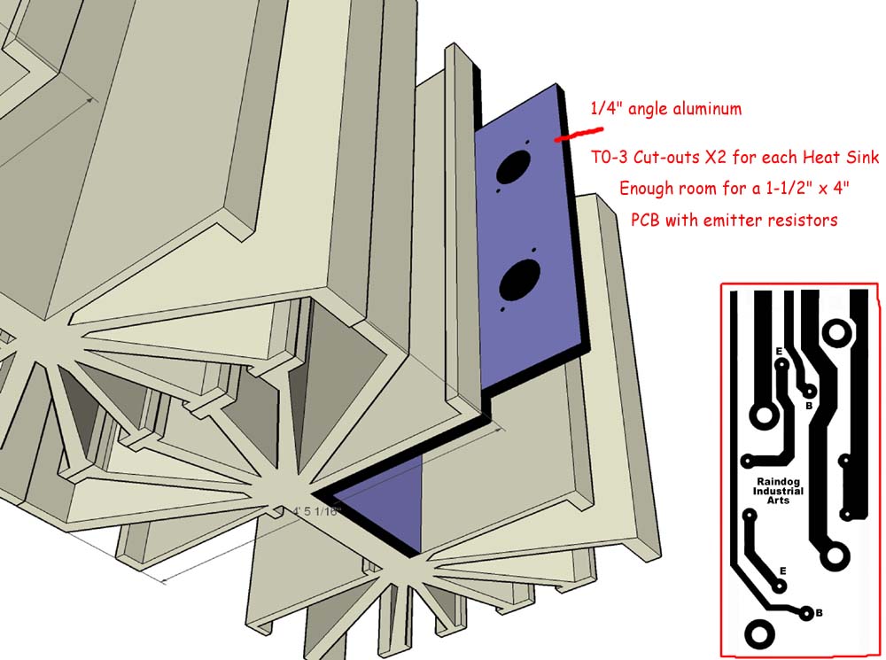

From the diy perspective it's hard to argue against any of the changes you propose. None are strictly necessary, heck for a 50w/8ohm amp none are even remotely necessary, but then we are talking about a class A amp..."need" doesn't really apply...this is the audio equivalent of a hotrod...
Not sure what the peak output power would be, someone else will doubtless run the numbers. The 400VA transformer per channel is plenty, you can probably tweak the idle current up a bit (from the 1.9A default) if you measure the transformer and heatsink temp as you go.
The pinkmouse boards will happily drive the extra outputs, and using a little less idle current on each of a few more output transistors should have a few benefits:
1) spread the power over the heatsinks better
2) make each transistor a little cooler
3) give more margin for 'accidents' and welding...
4) lower intrinsic output impedance
5) ...
Additionally you may get benefits from the transistors operating in a more linear region of their transfer curve...
Of course you get to drill a lot more holes, in the right places...

I don't want to regret the build effort later on with, "what If I did this and what if I did that".
Thats a classic statement that any builder of anything ALWAYS says after the fact! In reality you'd find that any pro amp designer would have ALWAYS done something differently the next time around. In nearly 30 years of building DIY amps I always found something I'd have done differently and thats part of what makes DIY so much more interesting and better than buying a production unit. In actuality we CAN go back and make major changes if we want to but an amp designer with a thousand amps in production can only make very minor mods after the fact.
Build on... we can't bear to Wait any longer🙂 .

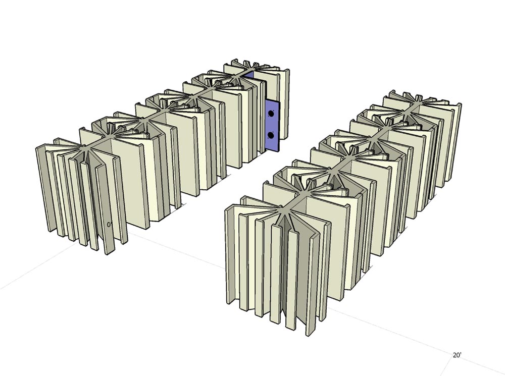

I have low profile extrusions to build the chassis from so it is getting too tight for me in my original layout. So I will add the fourth set to increase the depth of the cabinet, hence I will install 8 outputs per channel (4x NPN & 4x PNP) and this will place only two devices per heat sink. Just because the aluminum is there and why not? The metal supplier came through and I have most of the aluminum to bolt it together. The next part will be the hardest as I do not have a metal working shop but I'm up to the challenge. If I muck it up I can use Mark's classic take and say what if... I'm certain there will be some what if's anyway. The man has a point.

I have 4 extrusions for each side on the amp I'm building. I did up an image in Sketch-Up of the lay out. I'm planning to place 1/4 inch thick angle aluminum flying off each heat sink. This will allow me to place the TO-3's in a single profile on the inside of the chassis. I was planning to cut the extended aluminum lower at the top of each portion and run a "bus" across the top of each side of the amp.
My reasoning is if I place the TO-3's deep inside each heat sink as they exist, I will end up with alot of wire and a difficult amplifier to MOD and/or service. If I use the aluminum extentions, life is better and easier?
This is the best I could come up with and I was wondering if any folks could see it a better way.
Regardless, I'm going to try it out over the next day or so but if someone had a better idea, I'd like to hear about it.
Shawn.
Shawn.
Hi Tom.
the To3s get placed directly on the flat middle section of each sink. No angle is required and adding that angle WILL make the transistors run hotter. Don't!!!!
The To3 can sits on the outside and the pins face in towards the PCBs. hard wire them together. someone posted a pic showing the emitter resistors hard wired into the space between the fins next to the pins.It all looked quite neat.
