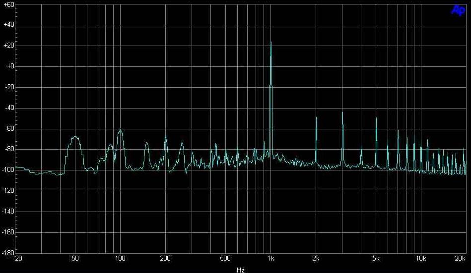

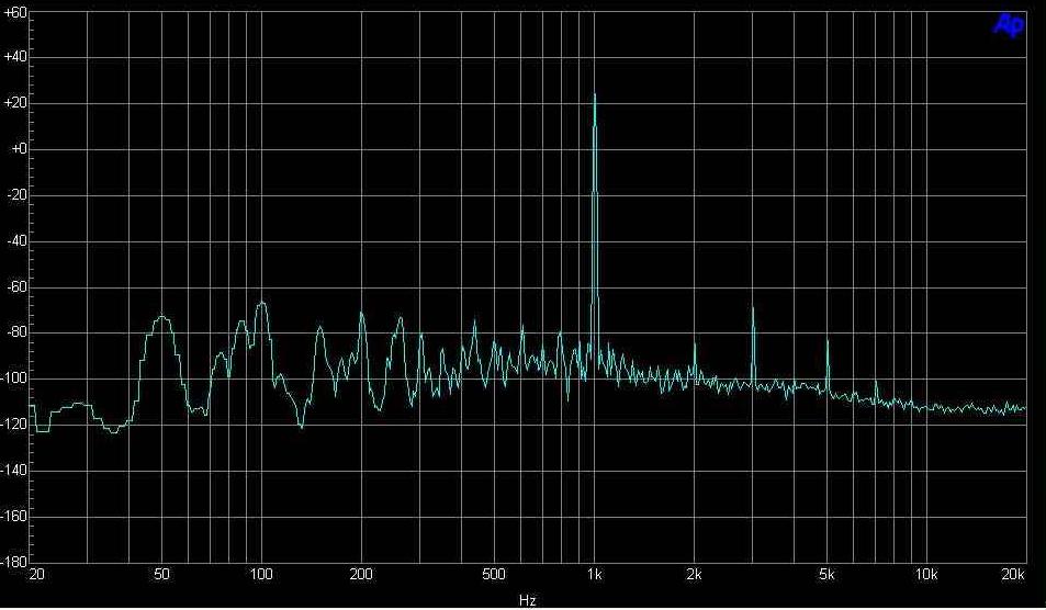

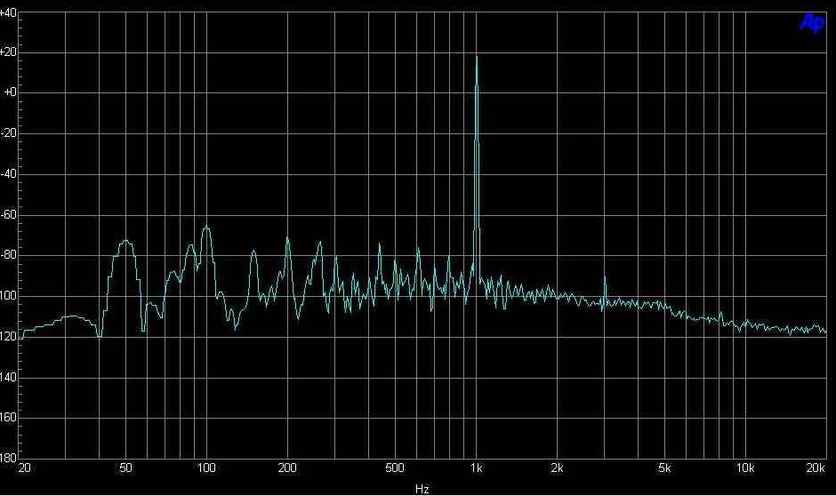

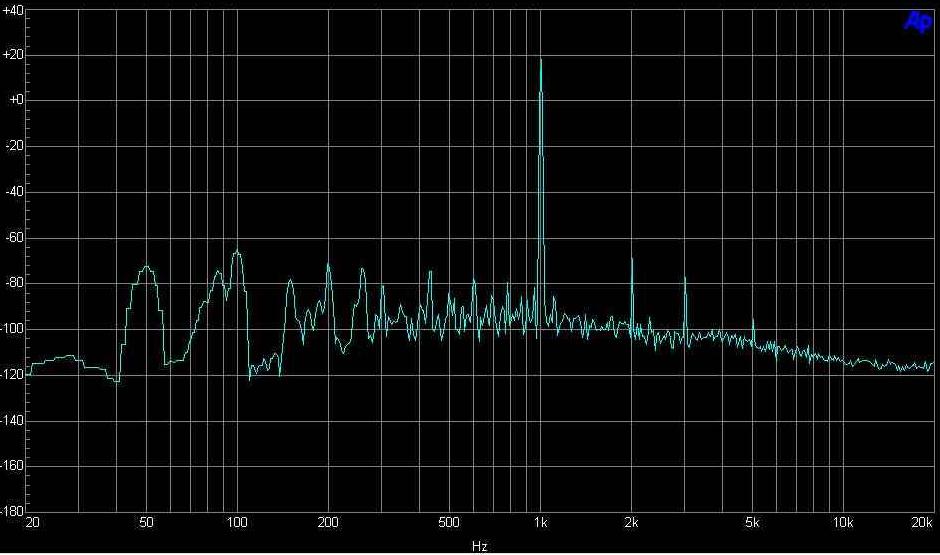

Hi guys,
I sort of lost track of the thread here a few months ago when I finished my first clone (actually I built it on contract for a friend, my research is in PNPWM class-D), but as he now wants a new version built with Pinkmouse's boards I started reading up on the progress made in the meantime.
Back then I posted some time-domain measurements (see thread #320 for them and details on the amp) from a digital scope and interestingly enough few people seemed to be bothered with it, and preferred to discuss more trival matters.
Well, I've since increased C105/106 from 22pF to 47pF on the same amp and took some measurements with an Audio Precision SYS2722. For those not familiar with it, suffice to say it's considered the audio measurement benchmark by many and its features is only matched by it's cost. I've toyed with RightMark AA software with a Creative Audigy4 Pro soundcard but it's not nearly in the same league.
The result is actually quite impressive for such an old design. I didn't bother taking too many measurements (IMD, crosstalk, cosine burst etc), but rather just 4 FFT's with 1kHz sine inputs: 0.5V and 1Vrms, unloaded and 5ohm loaded. Note that these are honest-to-God measurements, with no weighting filters, low-res sampling to reduce apparent harmonic amplitude or so. FFT resolution is taken as 32768 and the spectra are the average of 16 consecutive measurements.
I'm not going to comment too much on them, people can read into them what they want. What is notable, however, is that the noisefloor is dominated by 50Hz and its harmonics. Considering that this amp has been built as an almost exact replica to a KSA100 (layout and wiring-wise), it shows that the grounding can clearly be improved. I'm sure that Pinkmouse's boards' ground separation together with a star-earth point that's not at the PSU caps' centre (as explained by AndrewT, Self and Leach) would help a lot there. The rest is pretty much as expected, with rising odd-order harmonics as the output power increases. Worst-case THD, with the amp delivering over 50Wrms to the load, is a very respectable 0.06%. For 0.5Vrms input the 50Hz noise dominates the THD+N at 0.012% irrespective of the 5ohm load, and THD @ 1Vrms input unloaded is 0.006% due to the higher fundemental amplitude.
Pierre
Pierre
Interesting work Pierre.
So these tests were conducted with the first GB boards, or were they ones of your own design? I would be very interested in seeing the results of testing on my board, not that I want to take any credit, but it would be nice to see if all the good advice and layout after layout worked.
If I had access to an AP rig, I think all the guys would still be waiting for me to finalise the PCB! 😉
Hi Pwatts,
why was it necessary to increase C105 from 22pF to 47pF?
Were there listening symptoms or artefacts found in measurements/testing?
AndrewT said:Hi Pwatts,
And following on, what output devices did you use?
