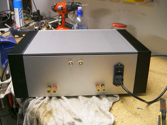

I am pretty sure r126 is for bias.. What's r131?😕 I can't find a good reference to it...
Amp looks great!
MP:

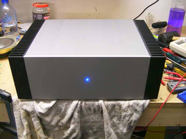

I think that wood looks real nice on the front!!!
Mine still looks like it was breadboarded, but I have been playing it everyday for near six months, and it works and sounds great!

Mpmarino, lovely amp you've got there

Nice work MP, a very elegant case.

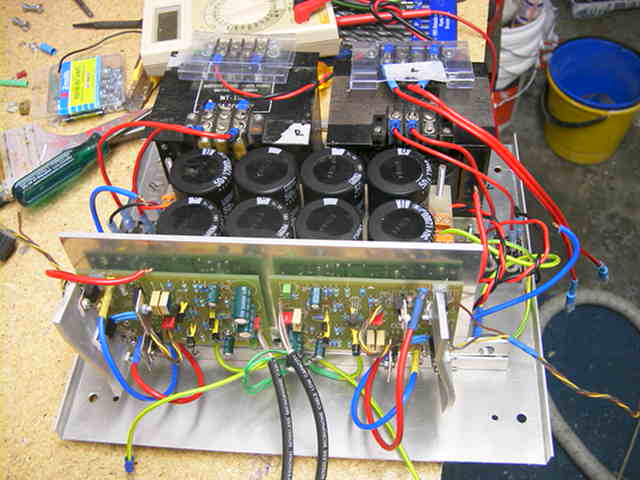

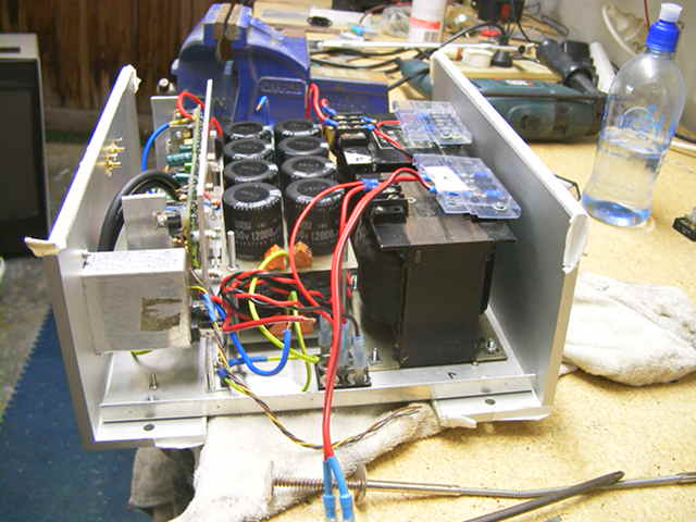

Excellent work, a very clean design. However, if you haven't bolted it up and put it in your system yet, I would suggest twisting all your power runs. But if you want to ignore me, and just listen to it, I wouldn't blame you. 😉

the back has a slit for venting.
That sounds like the kind of excuse I'd use when I cut a panel wrong, though I'm sure yours was designed that way! 🙂
Hi Pinkmouse,
thanks for the kind words.
I know your so right about my wiring, but you wouldnt believe how tight this all is. I might one day but its time to listen to it again🙂
BTW I worked as a test technician along time ago at Perreaux sound. It was amazing what the distortion levels did when I moved the power leads near signals etc.
seeya Arthur
seeya Arthur
Nice looking amp, Luke ! Good to see those ksa-clones getting finished.
