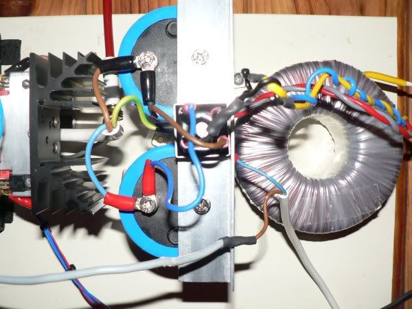

is that three ground references coming off the alloy common plate on the smoothing caps?
And provision for three more.
I recommend you set up a star ground somewhere local to your PCBs and take one connection from star ground back to the PSU common.
I do not recommend you use the PSU common as your star ground and certainly not by taking separate connections from various points around it.

Hi Mark,
you must have missed all my previous postings both on this thread and many others.
The biggest problem is trying to isolate the pulse charging currents going from rectifier to smoothing caps from modulating the ground reference that all the audio circuits need for a quiet (with zero signal and with signal present) output.
I have found that keeping the rectifier /smoothing caps charging circuit very compact, confines the very large pulse currents and their electromagnetic influence to just that circuit. A separate central star ground tied back to the PSU common prevents the charging pulses from travelling through the star ground.
Similarly, keeping the very high currents from the amplifier separate from the high impedance/input circuits also helps with maintaining a low modulation level on the audio ground.
This part can easily be maintained by keeping the speaker return, Thiel/Zobel network, decoupling returns etc all on a power ground. The low level grounds from the input RCAs, the input RF filter, the LTP CCS ground ref, any decoupled Zener stabilised ref, NFB ground ref, and possibly cascode ground ref should also be on a clean ground.
Finally connect the power ground and clean ground together with a link to the PSU common and a disconnecting network to the chassis (safety) ground.

still amp without a case but i like my amp working before i decide on the case-dimensions.
gnd is connected at the bolt which holds the bridge-rectifier .yellow-green wire is connection from psu-gnd to main pcb-gnd (Jan's board). input-signal gnd connects to main pcb-gnd at the same point.
output-stage:
biased for 35 watts class-a, 2x 80mm papst running full-throttle.
i know the psu-rail connections running "through " the main pcb is lazy wiring but it works for now
output-stage:
Klaas

Nice papst fans, enjoy them, they are expensive here in USA. I think that you will find your output heatsinks are kind of tiny, they will work fine for 30W class A but will get surprisingly hot for .... say 50W class A. Just my opinion based on my amp which runs hotter than a firecracker.

Klaas, that is good to hear. By the way, I forgot to compliment you on the exellent construction technique. Unlike me, you appear to have logically connected everything.

thanks, in my opinion any working amp is a good one !Unlike me, you appear to have logically connected everything.
i like to work "bottom up" instead of "top down".(i hope this makes sense)
Keep it simple at first. do i need inrush current-limiting ? not overhere if i use 300va toroids. output speaker-relays ? it doesnt produce a thump at startup.
helps to keep things nice and tidy.

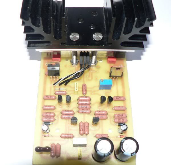

Ouch, i know how it feels when a diy-amp goes up in smoke....reminds me to NOT EVER use silicon insulation-pads together with to220-devices again.i tend to torque things rather tight and the sharp corners can cut through the pad. once took me months to find that one out...
driver-pcb prior to testing - thanks Troy for the parts and Jan for the pcb 🙂
