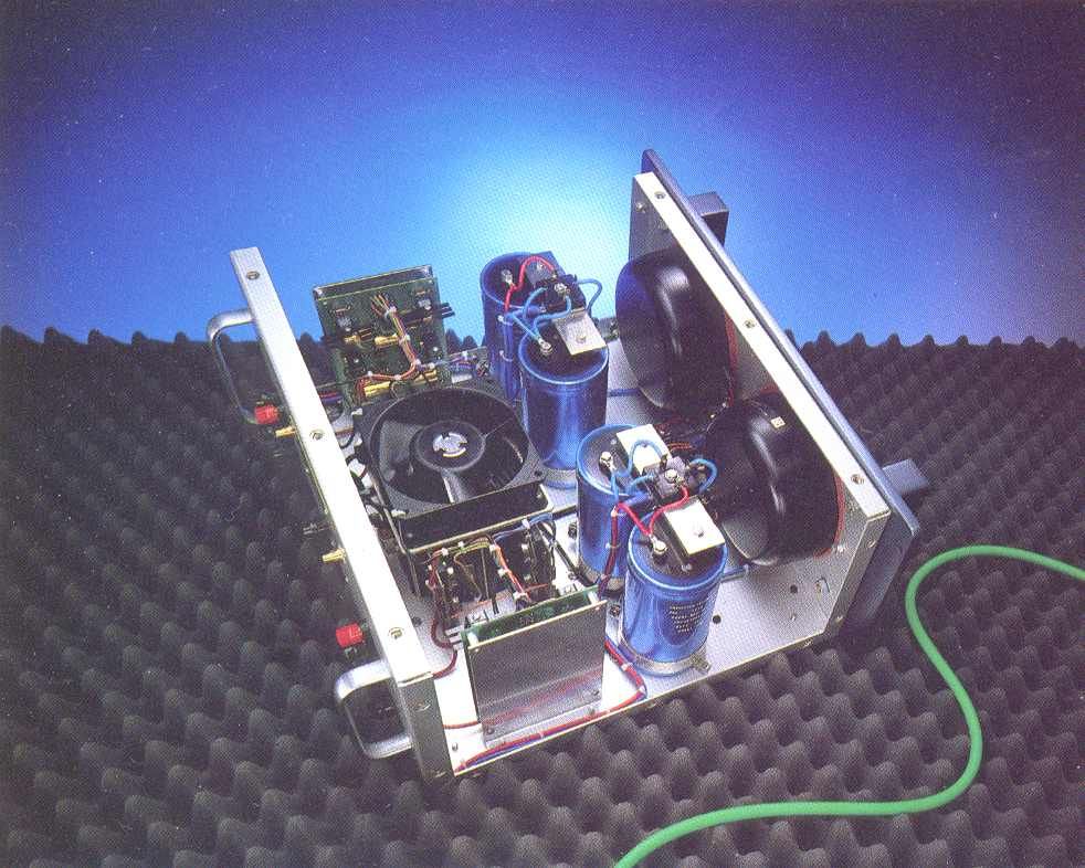

Do you remember the pictures Klaas/kvholio posted of his KSA50 ?
Same board layout but doubled A968/C2238 in the Vas, instead of those TO202 devices.
www.diyaudio.com/forums/showthread.php?postid=840116#post840116
www.diyaudio.com/forums/showthread.php?postid=839051#post839051
Looks to me like Dan d'A made small device changes during production without bringing out a new model version.
Al's version has a new board layout, different Vas, upgraded devices in the driver and output section. And we're running this one full bias. MKIII, the final version ! (but i still say this one should have regulated front end rails)

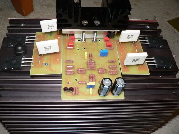

jacco vermeulen said:MKIII, the final version ! (but i still say this one should have regulated front end rails)
Well Jacco, the option is there on the PCB! I look forward to seeing your results! 😉

Yeah, thats my board, as Jacco already mentioned, just with different transistors in VAS-stage...
I guess this means i'm building mkII-clone mk-I (Jan's boards).
Seems to me Dan made a point of thermal redesign of old board (which used flimsy heatsinks for driver-stage).

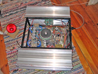

Remember this one ?
My mkIIclone-mkI will look something like this:
With kind regards,
Klaas

Konst, thats heat-tunnel made up of two heatsinks (posted pic before that shows arrangement).My ksa50 doesnt say mkII on the badge, has blue anodized front-panel.The pic i posted from "old" ksa-50 is posted in this thread earlier (MUCH earlier).
With kind regards,
Klaas

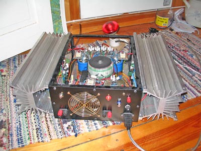

Thought I post some pictures on my slow progress of my KSA50 amp,note,that the wires are not soldered on the pictures so it looks
kind of messy
.I seem to have this habit of starting new(other projects)while building one,so this might take some time.😎
But, it aint no need to hurry.😉
You can see the red 100w in the background.😀
kind of messy

Let me first clear up some misunderstanding:i own original mk-I, i didnt clone it (no need to clone what you own 😉 ).
From what i heard from people on this forum, my ksa-50mk-I is probably retrofitted with pcb from mk-II.
I am attempting to clone a ksa-50 mk-II (which runs on lower psu-voltage than my mk-I).
The pictures i posted earlier from inside of amp were pictures of original mk-I, not of clone.
I can help you with layout of powersupply etcetera, also with wiring like original (in my opinion krell did some typical things with wiring).
I dont think its wise for me to give you layout of pcb (dont think Dan-the-man would like it).
If you have particular questions, please let me know.
