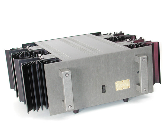

just a question.....anyone knows why the original krell has the heatsink on the side....if the output devices are cooled on an hearsink inside of the amplifier and with a fan cooler?
let's look at the picture attached...(this is the ksa 100 )
...anyone can tell me what that side heatsink needs for?
Simple, that is a later model, from when Krell had more money to spend on case work.

As far as I know the fan cooled versions were the earlier models.
Krell appeared to move to the massive looking passive sinks in the later models.
Why? I can guess at:- less noise, less dust, more reliability, more aesthetic value.

if that had internal fan heatsink?
where's the vent on the top cover?
allan
I have figured why that model has the heatsink on the sie...it's because it' not the ksa 50 but the ksa 100!
