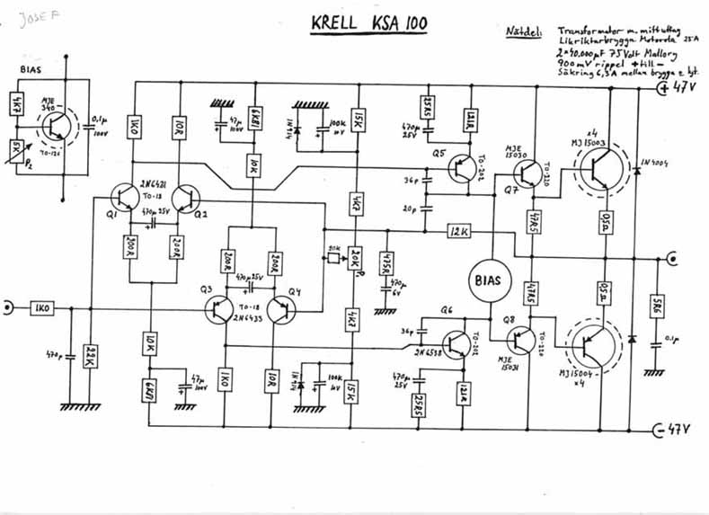

The resistors on the outputstage of the schematic labeled RVI 1-3, where did they go? Are they some optional components or just obsolete?
They are not needed inless you are implemnting current limiting as on Jan's design. The original KSA-50 did not have current limiting except by fuse. They were omitted fomr the Pinkmouse board cause it has no current limiting option.

Hi Stefanoo,
compare the Mk1 (pre '83) to the Mk2.
Note the lack of zeners on the LTP tail currents, addition of the electrolytic capacitor across the LTP emitters, RC in// with predriver Re, omission of the follower to the VAS, cap feedback to inverting LTP, VAS referenced to ground.
Be prepared to change these details to Mk2 spec to at least listen to why Krell changed the schematic.

i would like to built the ORIGINAL MK I ....... NOT the mkII.
I only would be interested on the ORIGINAL MK I project.
i would like to find the electrical schematic for the MK I ...the two that i have now......i don't which one is the MK I ....if there is one correct!
Could anyone help me to find the original and correct electrical schematic and......if would be possible....the lay out of the board?
...for instance...on the link of the ksa100 mk II... there are pictures of the components layout on the board.
by having the correct electrical it wouldn't be that hard to re-built the board.

Stephano, they are probably both correct, Dan was prone to changing things. As for photos of the MK1 board, I did a lot of research and didn't find any Krell pics on the web that are not shown or linked to in this thread. If you're really set on building a MK1, then your best bet is to buy one, copy it, then sell it afterwards.
but this is the krell ksa 100.
...i undertand...
in the the pdf file the label says : 1983 .
it seems to be the first one ad most accured one.
the idea to buy one rebuilt and sell...it's nice.....but......i don't know!
it's not so easy to find one used!
....second...youl'll never know...if the unit that you get is modified or not.....if it's the mkI or the mkII........it's a bet like oyu said!!
I would rather prefere to find the electrical and correct electrical schematic and then built the board based on pics that i have.
The lay out would be really close to the lay out of ksa100mkII.

ksa50-1
lloyd has a schematic of the ksa50 series 1 on his website, it is basically the same as the 100 shown, with half the outputs, and lower ltp bias resistors etc...
But there are no board photos
Stuart
ksa50 schema
Nope, I mean Lloyd Maclean, not sure what the URL of his site is, but he had a good complement of all the early Krell schematics, and one of them is explicitly listed as ksa50 series 1.
I pulled it from the site when he first showed us his stuff, so I haven't checked since, if it is not there anymore email me.

close enough...
yes, and the schematic I was speaking of is
http://home.ca.inter.net/~lloyd.maclean/Krell/KSA50.pdf
The transistors seemed to change based on availability and better specified parts becoming available over time.
Stuart

Hi Stefanoo,
that pre '83 KSA50 and the KSA100 just posted seem to be almost the same.
Have you had a chance to compare the schematics yet?
Can you manage to build a PCB that has the traces and component locations of both, possibly including a few jumper pins on board to allow the alternative topologies? Both the mk1 and mk2 can thus be compared and even individual changes compared.
