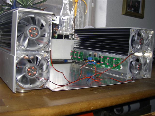

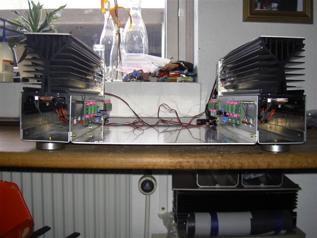

I have now modifyed, my chassis, the 2 duct fans will be controlled separate by NTC resistors, and the fans at the heatsinks will be controlled together by 1 NTC.
Idle speed will be about 4 v and max speed at 10,5 v
Still a long way to go.

Hi Rovsing,
The hot end of your sinks should have the output devices farther apart compared to the cooler end. Which way are the fans blowing/sucking? Moving the hot end ones towards the centre nearly achieves the same thing.
BTW, I would put the fans on the outside so we can see them clapping😉
The sinks you are using have fin spacing to suit natural drafting, so they won't dissipate quite as much heat as close finned sinks designed for fan cooling but they look plenty big enough. What is the Pd you are planning on using?

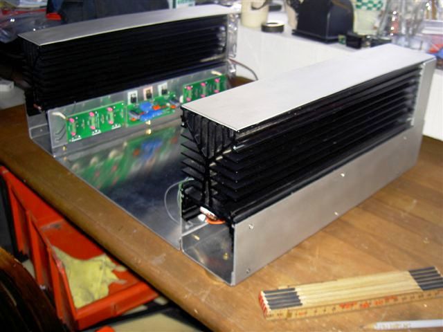

Hei Andrew
The fans are blowing through the duct, if you look at the new picture that i have attached, you can see that the heatsink got a Y shape, that's why i have put those plates at the top(haven't fastened them yet) to make a triangular duct for the upper fans.
If this construction can't keep the heat away, i will trow this thing out !😀 It has already got much bigger than first planned.
D=400 mm H=175 mm W=475 mm
Actually they were on the way to the junkyard from where i work got 4 of them, i like recycling especially if it's something that i can use !😀
I don't know their data, but they should be able to do this job in kombination with the fans.

Here's a picture of the NTC's mounted in the opposite end of the fans.

Very slick metalwork ROVSING. You obviously have better metalworking-skills than me.
btw, heatsinks im using are also salvage parts from electromotor-softstarter at my work. when i saw them i knew they were mine 😉
