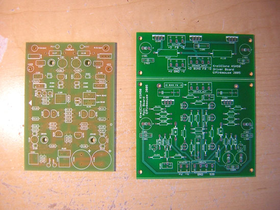

Hi Buhl,
if you are using the MJ15003/4 then the Klone mk2 (Pinkmouse)are really a waste since the two output boards will be unused.
If you can find some of the earlier Klone mk1 (Jan) then you start with much less PCB area (cheaper) in return for the hard wiring of the output stage.
I'm not sure what planet Andrew's on but you can hardwire the OP stage of either board version quite easily.... however the JAN boards driver mounting (tabs reversed from each other) is somewhat difficult to work with if not impossinble in some cases. In my own MK-2 version I used MJ21193/94 perforated emmitter devices that are hardwired to the pinkmouse boards. One point to mention is that several here have noted that the Pinkmouse boards do sound better than the JAN boards. I have built several on both versions of the boards I agree with that finding. While you would also have to discard the OP boards on the Jan version which I can also supply I am also able to supply you with the Pinkmouse boards minus the OP sections @ 12.00 each if you like. I have 6 that way in stock. Let me kow which boards you desire. Both perhaps?
Mark
Mark
FYI: In all fairness this is what both boards minus the OP board pieces look like...JAN on left and Pinkmouse's on the right. Note that the driver board on the top of Pinkmouse board is removable for easy mounting to the main sink if desired and also includes spots for more bypass caps for each board... not a bad idea at all.. There is also ALOT more room on the Pinkmouse board for 1/2 watt Vishay resistors which barely fit between the holes on the JAN board. These were the main reasons with the JAN board for doing the new board to begin with aside that you don't need any current limiting on a stock KSA-50.

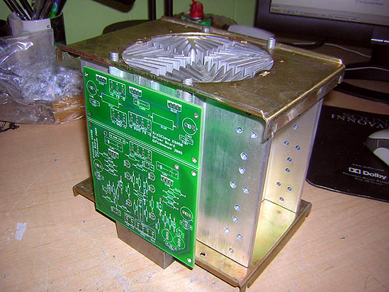

Have finally drilled all the TO-3 mounting holes in my actual Krell heat sinks. Drilling these is a pain in the you know what! I finally made up a drilling jig that I clamped to each position and then drilled through it. Makes a much easier and tidy job out of a real high pain level job. The KSA 50 boards are the perfect size to fit on each side of the sink assy. Made my sink 5" tall to accomodate three TO-3 devices on each mounting rail. Have to go on another road trip next week so will leave at the anodizers. Should have this together pretty quickly when I get back.
Mark

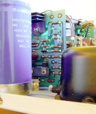

And now at post 6300 I throw a monkey wrench into the gear train!
So which version of the KSA-50 have we actually been building all along? I just noticed this interesting board inside a KSA-50 photo that I had lifted from Audiogon a year or so ago. I lightened up the gamma range and low and behond.... notice the extra row of TO-220 devices along the bottom... these are in addition to the TO-220 driver and VBE that are at the top mounted to the blue heat sink. I say that we are not building the Mk-2 version as we all had thought we were.... any insight on this board? I personally think its a scaled down-smaller version of the KSA-100 MK-2 board to fit the 50. Indeed a true KSA-50 Mk-2.... What do you all think? If the KSA-100 Mk-2 thread does its board it may well be applicable to building a true KSA-50 Mk-2 version as well.
Mark
Mark
