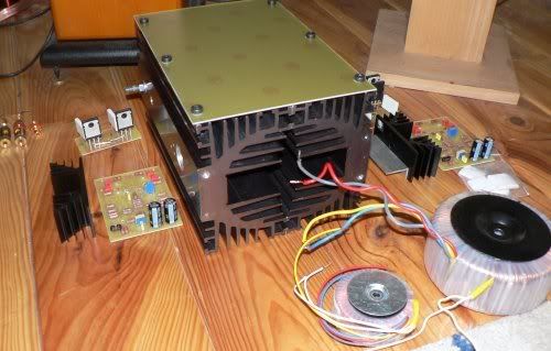

Does anyone have a KSA-50 and or KSA-100 or access to one that they could possibly get me the exact chassis and heat sink dimensions? I just aquired a huge 4 foot section of the original tunnel heat sink and it would be fun to make an exact clone of these amps.
Thanks!
Mark
Thanks!
Mark
Mark, i have ksa-50 mk 1. if you want to i'll measure height of heat-tunnel and can give you all dimensions you want.
Just to make sure, bikehorn, you know what you're getting yourself into , this is just pic of work in progress (i'm not even halfway finished, stuffing pcb's is actually the easiest part- just make sure you don't "free your mind" before you work on this amp 😀 )

Hi Klaas,
That would be greatly appreciated. I need.....
Height of the heat tunnel heatsink only
Dimensions of chassis minus the front panel.
Thanks a million!
Mark

Mark,
Height of heatsinks is 102 mm.
Outside dimensions of case (hxwxd) are: 192 x 433 x 382 mm
-without front panel, back handles, feet etc, just "the box"
glad i could help, if you need more info just let me know
Klaas

standard heatsink 102mm high!
what is the width and depth of the heatsink
looks like my heatsinks are a bit overkill😀
http://www.conradheatsinks.com/products/flat_hd.html
151mm high, 2 per chanel for tunnel
dam it, i am just going to have to bump up the current😀
allan
allan

4 heatsinks form square of approx. 5" (125 mm)
Remember my mk1 is not biased into 50 watts class-a.
(has one tunnel for two channels)
with +/- 47 volts ps-voltage it is more class-ab 2x100 w with huge amount of bias.
Also , after few hours of warm-up, entire case works as heatsink too 😉 10 mm thick frontpanel gets comfortably warm
Klaas

dont worry awpagan, those will probably get hot. thermal resistance conrad states is at 80 degr. above ambient -meaning your amp is fried before you reach that temperature/thermal resistance. Tunnel i'll be using is 170x150x250mm for both channels, with 4 x 80 mm papst-fans blowing air through.Hopefully this will be enough to get to 50w class-a/8 ohm.looks like my heatsinks are a bit overkill

KSA-50 used 1 tunnel with 8 devices (4 per channel).
KSA-100 used 2 of those tunnels.
