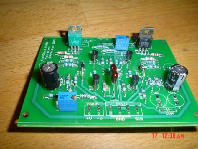

A picture of one of 6 main boards.
All matched Toshiba devices, all resistors also matched within 0.1% accuracy, Roederstein caps and Cornell Dubilier silver micas.
No beautifull Dales, but don't let the size fool you.
Missing caps because of voltage regulators and dc-servo.
Not sure yet how i am to squeeze in the original Toshiba devices for Q105/Q106.
Oh my God...
We are observing the birth of the first Ksa clone with Pink socks !
I don't know how much these socks are going to increase amp's WAF, but they look eccentric, for sure. 😀

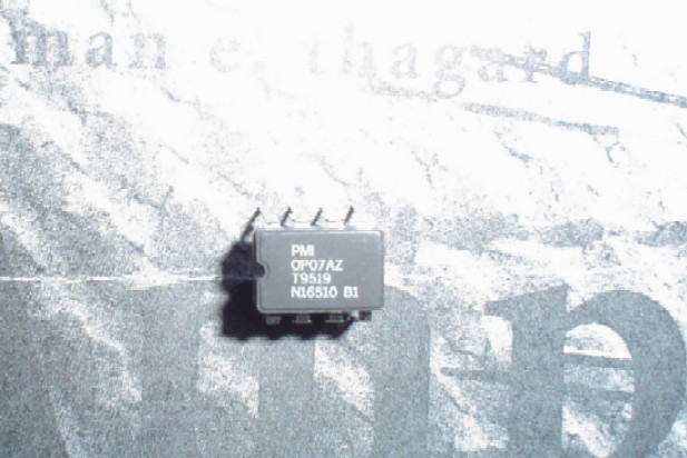

Upupa Epops said:Is not neccessary to use 0.1 resistors, Jacco....
Pavel, not necessary but fun. Pink socks are not necessary either but are fun too.
Some of the 0.6W resistors on the boards are 2% accurate
low noise types that i have aquired the Dutch way: cheap and lots of them.
I have close to 20.000 resistors and have to check their value anyway.
For the dc-servos i have OP07AZ opamps, a full rail from a skipped active crossover project. Sent some of these to ModEvil in Brazil for upgrading his Brazilian Gradiente amplifier.
The opamps were made by PMI, now AD, the AZ is the military version that has very low temp drift and voltage offset values, and has a low noise number.
With a standard filter on the positive entrance of the opamp, rolling off at 0.25 Hz, equal resistor value from the - entrance to ground . A resistor on the output to limit max output current, and a small cap across output and - entrance.
Not much interesting to say about dc-servos really.
As i have 9vac step-up transformers for regulating the voltage for the rails of the front end, they'll deliver their 9vac to TO220 voltage regulators for the chips.

Hi Jacco,
are the Tosh To92 bce instead of cbe?
Then try inserting the body at 90 degrees to the normal orientation and bending the legs c to the back e to the front and b to the middle to align with the pin holes and then there is space, no need for insulation. Not as neat but almost workman like.
Did your last comment reveal the real source of the neck problems? Handbags at 5 paces are pretty drastic!
