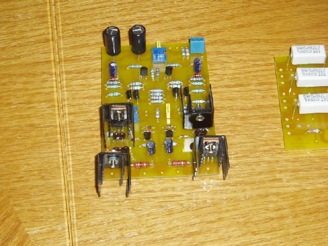

SteveA said:Here is my board ready to go (more or less):
SteveA
Looks nice, good work. I think you will want to use larger heatsinks for those driver transistors (the 2 closest to the edge).

I have those sinks too, what if I use 2 and piggy them back to back ... would it be enough?
Possibly. They take a while to get hot so you will have plenty of time to monitor the temperature.
That's what I've done. If you look close each transistor has two heat sinks attached. I'll see if I can attach some larger heatsinks to them.
