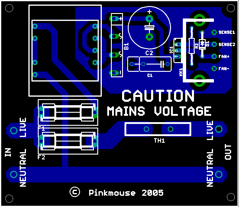

Upupa Epops said:Do not lead ground below transformer, Al. Here you have low distance from line...
Well spotted! That's already been removed, I posted an early version, I don't have the new one on this computer.

pinkmouse said:Oh, and what the final fan/softstart pcb will look like. Who needs complicated! 🙂
Shouldn't you put a 10-100 uF capacitor on the output of your regulator to ensure stability?
Probably, yes, but it's been running fine for 6 months or so, and doing so would probably ruin the top end response... Sorry, that's my minimalist gainclone personality speaking, I'll take it away and give it a good thrashing! 🙂
