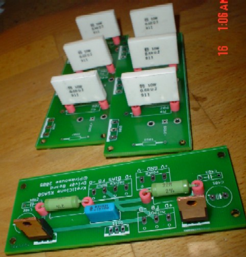

pinkmouse said:Jacco, got any pics yet?
Sort of, still waiting for Mark's ThermAlloy insulators before i can mount output devices.
a couple of weeks ago my physiotherapist did some bonecracking on me for a painfull shoulder.
He managed to displace an intervertebral disc in my neck, which gave me headaches and blurred vision.
Very hard to see small resistors and the point of a soldering gun, even worse for someone wearing reading glasses, i assure you.
Beware of bone manipulators !
Posting a pic of a main board tomorrow, digcam ran out of juice.
