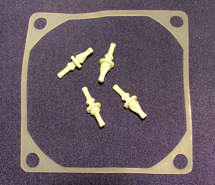

I've got a question about fans. I'm trying to get the case for my second KSA50 put together today. I got side-tracked with an Aleph-X thanks to LGreen. 😀
Anyway. I am using two flat type heatsinks mounted together with the fins facing each other to form a tunnel. I plan to use two 3" fans to cool it. When I selected the fans I was at the electronics store and had the salesman plug in a bunch of then and picked the quietest ones. While holding these fans in your hand when they are running they are almose completely silent.
Yet, when I bolt them to the heatsinks there is an audible sound. Seems they have some physical vibration that is transfered to the heatsinks. So I need to insulate them from the heatsinks. What do you guys use for this purpose? What ever it is, it needs to be able to take heat of course.
Thanks, Terry
