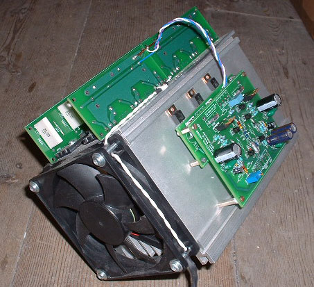

pinkmouse said:I've shown you mine, so you show me yours! 😉
Is that a Coldcube/Coldfin? How noisy is it?
Not sure what you mean, but here's another pic that might help. This is the same heatsink I used for the original T03 stage, but I rebuilt it when I changed outputs.
Using a simple LM317 thermostatic fan controller, (you can see the sensor mounted in the middle of the output devices), it runs very quietly, even with some fairly hefty bias

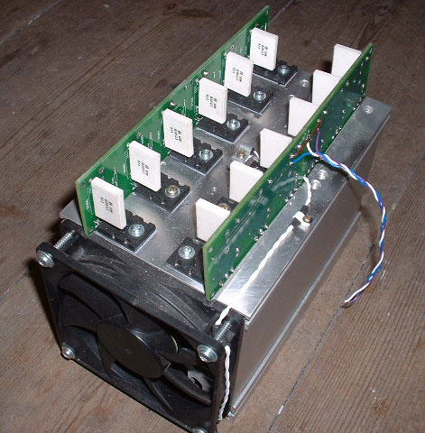

Upupa Epops said:Why six parallel devices, Al ? Are you making velding machine ? 😀
6 devices is OK for the plastic outputs... lol 🙂
I've got 5 pairs on each channel for mine...... Noticed last night it was running pretty "warm" (general heating of the room was noticed!) and i found that ambient was 31, so the hottest output (by a margin) was 72deg... So i turned the fans up 🙂
Al - how much bias ARE you running (or going to be at "maximum") and how hot are the chips running?

Walter, yes. It worked fine on the prototypes. I think it's a lot to do with the 120mm fan, the extra diameter makes a lot of difference to cooling ability.
Pavel, well if you spend as much time on this project as I have, you might as well make it multipurpose! 😉

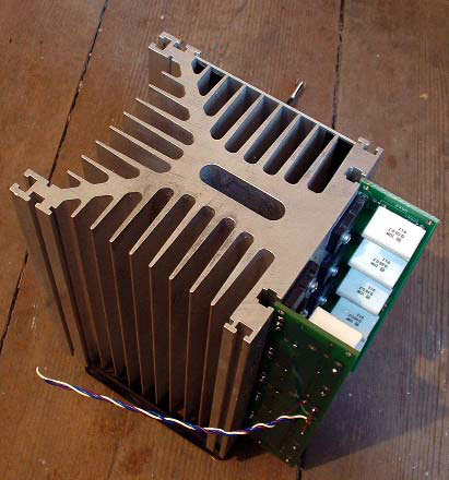

I thought it might be this: http://uk.farnell.com/productimages/farnell/standard/42267299.jpg
but it's not. It's a Semikron, 0.47C/W isn't it.
