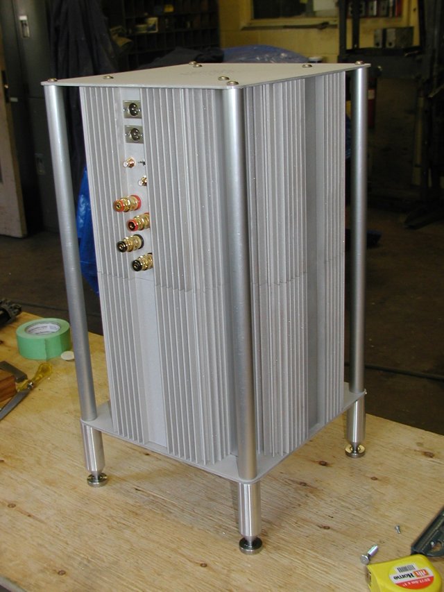

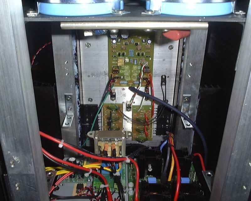

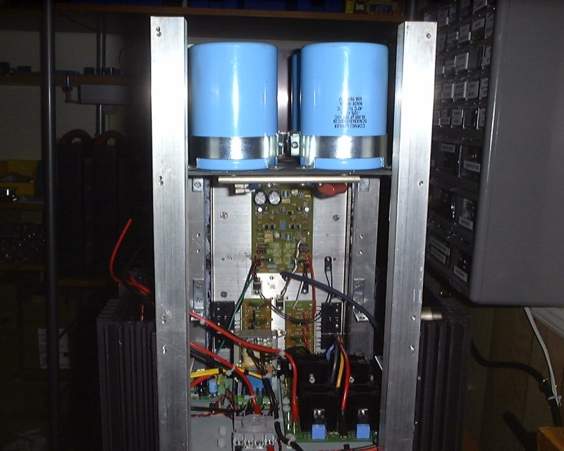

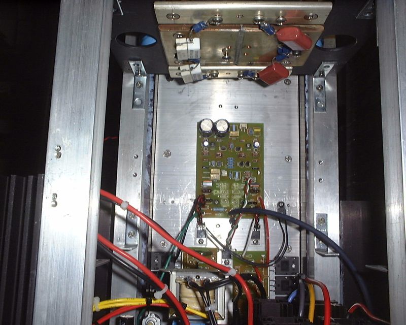

Coulomb said:Some Photo's of my bodgings so far, this has to be the worst project I have tried to complete so far...
Only because of the bad company here.
Looks really hot though, and that thing is Big !

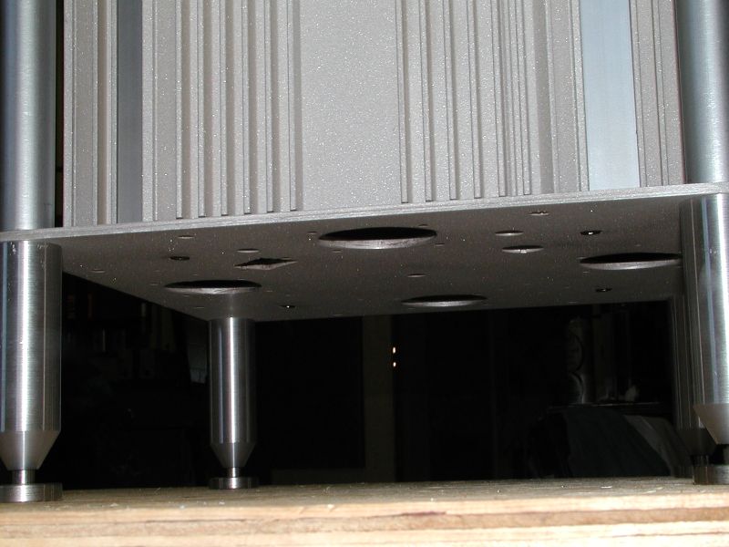

Well it is huge, 14" sqaure and 24" tall without the legs.
Think of it as a giant wind tunnel with all the electronic bits on the inside and that's how I built it. There are up to 4 2" fans pushing air in and a 5" pulling it out. I will be starting with just 2 2" fans pushing at first. The Fan circuits are on a 55 DEG thermostat mounted on the heatsink. A 70 Deg thermostat controls a softswitch that can shut down the DC to the Amp but keeps the fans running.

now...
...thats what I call a tower of power, very nice work...
You won't need as much heating on those cold winter nights...I froze my buns off walking down Jonge to deliver loek's resistors the last time I was there...
Stuart
