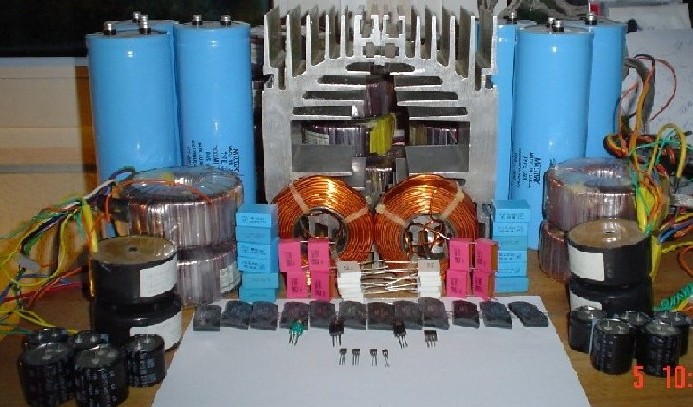

I've received the remaining parts for me Krellster today, i'll post a pic of the junk this evening, then i'll hush and wait for the boards.

Here is my garbage:
2SA970/2SC2240BL/2Sa968/2SC2238/MJE15032/MJE15033.
I forgot to put the MPSA42/92 with the lot, at the front are the 9vac toroidal step-up transformers for the front end regulation.
+ and - will have separate transformers, 2 300va toroids on each side.
