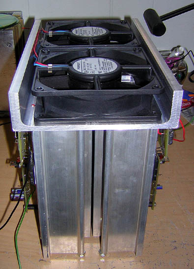

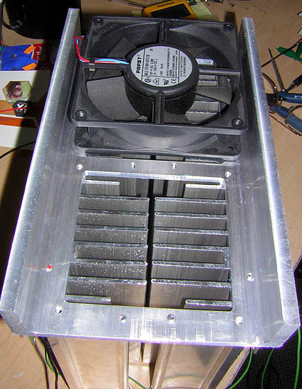

The complete module from the bottom showing both fans. Each heatsink is held in place to the c-channel with 4 long threaded rods. The two bottom edges of the c-channel will be drilled and tapped with 3 - 8/32 threads on each side for mounting to the chassis bottom. Air intake will be through the bottom of the chassis.

Hi mark,
What are those thick white isolators under the drivers?
Do you have the same isolators under the output devices?
I assume they have good electrical insulation values.
Do they also have good heat conductivity values?
Can I suggest that the Vbe multiplier should be closer to the output devices or does it not matter here due to the very long time constant of the heatsink?
What are the two white cables feeding ( the back widget at the end of the heatsink)?
Those are Thermaloy alumnium oxide/ceramic insulators. These effectively replace the berylium oxide type insulators. They are expensive but very efficient. Luckily I can get them surplus.
Yes, They are exactly the same thickness, .80", so thermal time constant should be about equal. Thermal tracking and settle down time is excelent. I feel the bias device is in just about the right place for this heatsink. My forst version had the drivers and boas at the top of the sink and actually that works out very well as the bias device tracks the driver temperature and then the entire sink equalizes with in about 15 min. anyway. But the second version seeme to equalize faster. Note that the bias device is just under an inch from each of those center output devices.
Which picture and which widget? There are three white wires. The two outers are the drive to the output boards and the center wire is the feedback from the output.
Mark
Mark A. Gulbrandsen said:The complete module from the bottom showing both fans. Each heatsink is held in place to the c-channel with 4 long threaded rods. The two bottom edges of the c-channel will be drilled and tapped with 3 - 8/32 threads on each side for mounting to the chassis bottom. Air intake will be through the bottom of the chassis.
are those heatsinks as large as I think they are

Actually not really very large at all...... The flat back is 10" X 7", the large fins are 2", the shorter fins about half that. They were reallycheap off of E-Bay, something like 10 or 15 bucks each. Having built other amps over the years I did'nt bother to calculate the thermal specs, I can keep it at 50 deg. C. in a 70 deg. F. ambient room with the fans running at about half speed. They are actually Solid State Motor Deive heat sinks.
