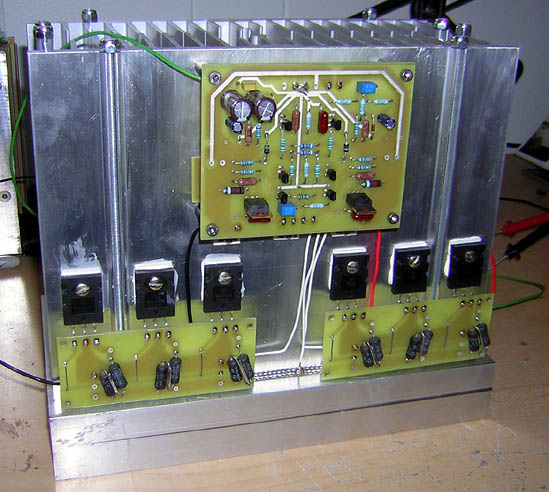

apassgear said:Terry,
I know that you have gone through the boards many times. But there are usually easy things that might have been overlooked. Let me give a list of what things I would look for if I was in your situation:
- Check PSU connections
- Check ground returns. All grounds should be connected to that star ground including the common that is formed with the PSU.
- Check polarities of all transistors. Remember that orientation of different transistor may have leads which are not the same as what the original design is calling for.
- Check for cold solder with a magnifying glass and redo when necessary.
And as said by someone before, check the main board first and then continue with drivers and output.

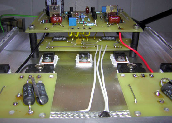

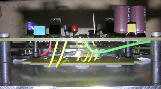

Thanks apassgear,
You can see here how I hooked up the PSU. I will do a proper star ground with a copper bolt and nuts once I mount everything in a case. For now they are just soldered. I thought this would be sufficient for testing.
I used the same transistors as are called for on the BOM except for the outputs, which are MJ15003/4. They are all situated according to the printscreen on the boards, which I assume are correct since I haven't seen any posts to the contrary. The only transistor I'm not sure of as I type this is Q111 though I'm pretty sure I checked that with my meter before I soldered it up. I will double check that when I'm through typing this. I'll have to be sneaky about it though since my wife already asked me to lay of the electronics for the holiday.
I did check the main board first, but without knowing what voltages I should be getting, I was unsure whether or not I have it right. From the reaction I get when I hook it up to the outputs, I have to assume I'm don't.

OK, Using two(different) regulated variable supploes here is what I measured in refrence to ground.......
Note: Bias is set to 150 mv across the emitter resistors and 8.9 mv offset... after 1/2 hour warmup.
Q-101 E .745
B 142.9 mv
C +36.07
Q-102 E .442
B 143 mv
C - 35.6
Q-103 E .617
B 0
C +35.9
Q-104 E .320
B 0
C -35.75
Q-105 E +36.5
B 35.95
C 0
Q-106 E -36.32
B -35.7
C 0
Q-107 E +37.05
B +36.5
C +1.29
Q-108 E -36.8
B -36.33
C -1.288
Q-109 E +.728
B +1.296
C +38
Q-110 E -.733
B -1.299
C -37.88
Q-111 E -1.06
B -.563
C +1.285
+ side OP device E 120 mv
B +.969
C +38.09
- Side OP Device E 140 mv
B -.735
C -37.89
Later tonight I will compare it with the other channel as I think a couple measurements may be off or perhaps I didn't have the probe in good enough contact. Ya got to be careful

Terry,
Checking the PSU connections:
I asume that you Checked the PSU under some small load prior to connecting it to the board.
If not, do (some very basic) the following.
Disconnect rails from the board, if you have rails in the order of 50V calculate a resistance that will draw at least 0.5 amps, this would be 100 Ohms and need to be around 25W raiting or more.
Connect 1 such resitors from each rail to common (use alligators to ease the connection). You now should have equal voltage (one + and one -) from both rail. Voltage should read as expected. Resitors will get hot.
If this is not true you may have the polarity of one secondary reversed.
