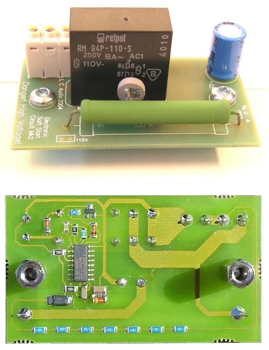

Another question: does one also need a softstart circuit when using an R-Core transformer instead of a toroid?

Walter,
with a toroidal transformer above 300va you'll need a softstarter to prevent the fuse to blow, inrush peak of a toroid can be 10 times the nominal value.(got a inrush graph pic of a toroid somewhere).
It depends on the size of your transformer whether you need a softstarter too.
Behind the transformer are the capacitors, if you are running really big boys a softstarter will gently load them instead of giving it to them straight-on, which lengthes their lifespan.
So i'd use a softstarter either way.

Walter,
Basically it comes down to, regarding what type of transformer (toroid, R-core, EI-core.....) of 300VA and up it's always better to use a soft-start circuit to make life easier on the trafo itself and the cap's behind it. Thanks jacco
Regards
Yes, and speaking of current limiting this can easily be accomplished with a $2.17 CL-60 current limiting device. There is no real need nor gain by utilizing any of the rediclous - extravgant turn on delay circuitry being discussed here unless you're building some really huge ampifiers. Also if you don't like the CL-60 in series with the AC mains all the time it is easily shorted with a simple R/C driven SPST 10 amp relay. Keeping things simple does have many advantages.

I have an ESP sloftstart board for this but you have whetted my interest about using a thermistor. Sounds much simpler and I won't have another transformer to worry about.
