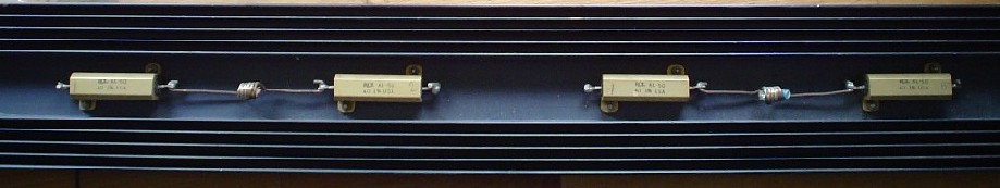

I don't know what CLC is but I am using CRC.
It uses 0.1R resistors. What size resistors would I need to drop a full 5 volts?
Thanks, Terry

The one I use is designed by Rod Elliot.
I calls for 0R1 5W. I guess it is more for clean power than reducing voltage. That is why I asked for the value I would need to drop the 5 volts I need.
Thanks, Terry

You definitely don't want 10 ohm resistors in the R part of this CRC power supply, with over an amp of idle current the voltage drop would be prodigous, somewhere between 1 and 2 ohms should get the job done. I'd turn it into a RCRC power supply using somewhere between 0r5 or 1r0 as the R's
Stuart

Prolonged high output in low frequencies will kill the rail voltage with high R values in a CRC.
What good is a +400va toroid then?
Without investing in serious capacitor power you'll take the sting from the Krell.
Calculation of a choke PS is not that simple, you dont want to know what a CLC is, Terry, believe me.

Well what do you suggest? .5R is just not enough to load the power supply enough to suppress Current artifacts unless your in the 100Watt Class A range.
BTW I meant 1.0 to 10.0 ohms in an earlier post, I just caught that. oopps

At 350 mV it was doing 2.8 amp bias, dissipation at 38vdc around 212 watts per channel.
That is 26.5 watts per device, for only a few minutes without a fan on the sink it should not be a problem, clever it is not.
At operating temperature there is a lot of heat in a heatsink, little in the devices.
When you shut down the power the heatsink will cool down slower than the devices, the thermal resistance between them will create a temperature difference.
In effect not long after shutting down the devices will be cooler to the feel than the heatsink.
Why not fully test the amplifier with everything added in class AB before taking it out full ?
When my main boards are finished i'll fully whistle it, and put it on a dummy load first.
(without output devices its an amplifier too, even a serious overkill headphone amplifier)
With the outputs connected the Krell will go on the dummy load again in class AB, with only 20-25 mV on the Re's before even considering taking it to full class A operation.
I have no idea how you can post such large pics, even at 50kB the picture of a dummy load i made is rejected.
1. This is my first time ever adjusting bias, and I wanted to try it quickly without a scope, without input (input was grounded) and without an output load. Saves a lot of time and more importantly space in my garage. I first measured all the voltage points on the input board vs. wiki, things looked good, and connected the output board hoping not to see smoke and I was very happy that it did not blow up on me. I'll try a full setup with input, output, fan, and temp probes later on.
(I see you suggest running the driver boards alone. I already tested the driver boards by themselves (ok 1 of them) by passing sine waves through it, and it appeared to be working. See Post #2514 and the ones preceding it. Not as much testing as you will do I'm sure but it convinced me to go to the next stage).
2. Believe it or not, I'm trying to shrink the pics as much as possible- my home pc must have high resolution or something because when I got to work today that pic was huge! I post pics on my website and link them here-- reason is that I can edit them and changes will be reflected here (side effect is that it avoides the max size limits here). You now see the pic is smaller.
3. The problem of bias being constantly increasing--- perhaps I should measure the voltage across the driver emitter resistors on the driver board-- I think this should be relatively constant and settable by the variable bias resistor. If this V on the driver board emitter resistors is increasing over time then there is a problem with the driver board. Right or not right??
4. I assume temp probes work by passing a voltage through a wire thats resistance changes with temp-- seems to me it would be dangerous to connect such a wire to a live TO-3 or heatsink. Correct or not?
