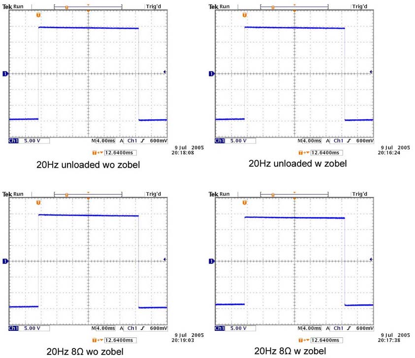

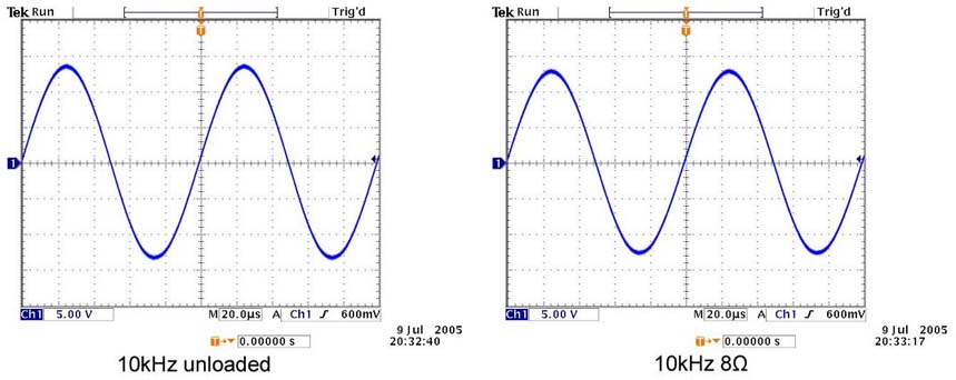

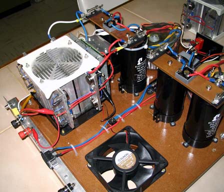

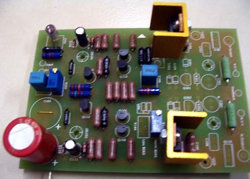

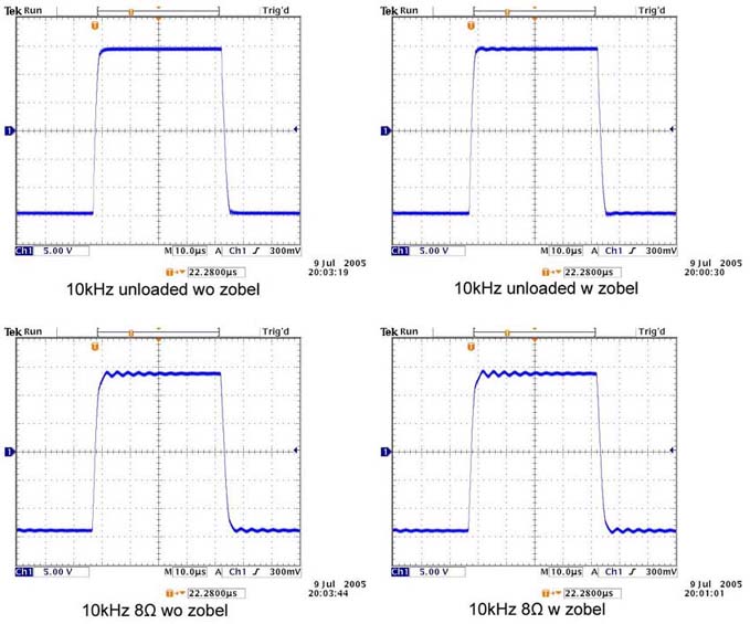

My KSA measurements

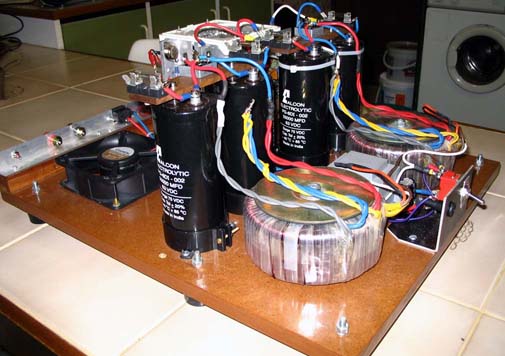

Hi guys,
I just finished some measurements on one channel of my test-rig KSA50. I'm building it for a friend who already owns an original KSA100 and KSA200. The entire layout has been copied from the KSA100, including the dimensions, wiring and heatsink & fan assembly. If the result sounds at least as good as the KSA100, it will be rebuilt in a professional copy of the KSA100 chassis.
Specs (per channel) are:
500VA per channel
+-30VDC PSU rails (transformers were already at hand otherwise I would have increased this)
55000uF per rail
4pairs of MJ21194/3 output devices
50W class-A bias
Although I wanted to keep the design as close as possible to the original, some modifications were made.
- twice the number of output devices and heatsink area
- increased PSU capacitance
- MJ21193/4 output transistors rather than MJ15003/4
- DC fuses placed on the busbar for reduced wire length from the PSU
- DC, rather than AC fans with a separate transformer for less injected motor noise
- Top quality components:
- critical resistors are Riken, less critical Holco and the rest Dale
- R127/R128 are 2W 24R Kiwame
- Emitter resistors are 0.5R 5W Mills
- C101 is polystyrene
- C105/106 are 22pF silver mica
- C104/109 are Evox-Rifa 100nF MKP
- C110/C111 are Black Gate Std
- C102/C103 is a single Black Gate 1000uF NX
- All hookup wire is silver coated teflon
- input cable is vD Hul
The 22pF value for C105/106 was chosen fairly arbitrarily. I had some trouble with stabilty though, and the measurements suggest that it is perhaps a little too small. 33pF will probably be a better bet, or even as high as 68pF shouldn't be too bad. The bipolar feedback electrolytic was chosen as 1000uF instead of 470uF simply because I got it on sale, and not any other purpose. I chose to hardwire the emitter resistors directly to the output transistors, and regret it now as it means I cannot measure the bias current on each transistor individually. I used an ammeter in place of the DC fuses to measure the total current (1.8A per rail), as the current consumed by the PCB is only about 5% of the total current. To avoid making a mess I used silicone washers instead of mica & thermal compound. This was a mistake as one transistor is running at least 20degrees hotter than the rest, despite all my best efforts to tighten the screws. Even that one is still less than the KSA100 I examined, but if it wasn't for that I could have easily increased the bias with as much as 50%. On all the rest I can place a finger without burning (just), but the problematic one burns to pain in less than a second - it runs at least 80degrees celsius. Besides the obvious problem of reduced lifespan (I'm not too concerned, the KSA100's MJ15003/4's are running that hot for over 20years without trouble), is there any reason why I should go through all the trouble to desolder & replace the transistor?
The predrivers probably didn't need their small heatsinks, and the driver heatsink was sourced from an old PC PSU. It runs a little hot, but still cooler than the KSA100's - I suspect around 50 degrees.
See the pics and measurements I made. The input signals from the generator were checked, they are all perfect. All deviation is therefore done by the amp and not passed from the input. All measurements were with a 1V amplitude (2V p-p) input signal.
I took a sinewave measurement at 10kHz, unloaded and loaded with an 8ohm load. It looks pretty good on both, no objections there. On the square wave one can learn quite a bit more, comments are welcome. I measured at 20Hz, 1kHz, 10kHz and 20kHz, all loaded and unloaded, with and without a zobel at the output terminals (10ohm & 100nF). It should be noted that squarewave measurements place great demands on a loaded amplifier, much less than sinewaves. I used a 12W 8R2 load resistor and it became scorching hot in less than 5 seconds. I grouped the frequency measurements together in single JPG's (had to compress them a bit) of four measurements each for easy comparison.
20Hz: at that frequency the zobel obviously has no effect. Loaded and unloaded are pretty much identical, with both exhibiting a slight amount of tilt.
1kHz: Still looks good, with only a slight drop in outout level when loaded. The zobel already has a slight influence, showing some overshoot.

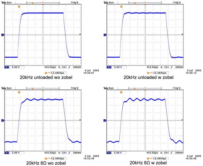

10kHz: now it gets interesting. The unloaded response shows a small amount of ringing with the zobel, but none without. Loaded both has ringing, with the zobel version even more.
20kHz: very much the same, with the zobel still making things worse. Excessive ringing when loaded.

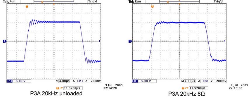

Just for comparison I also measured an ESP P3A, 20kHz square wave loaded and unloaded. The unloaded performs worse than the KSA, but loaded looks better. I guess the next step would be a listening test, and if I have the time, to measure my friend's KSA100 as reference. I think the signs show that C105/106 should be increased. Comments anyone?
