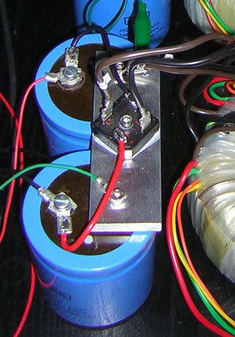

My bridges get fairly warm as Stuart mentioned they would be. Mine are mounted in the origianl Krell fashion..... right onthe caps..... just makes things alot easier to wire with shorter wires too. Note the white grease peeking out from under the bridge.

jacco vermeulen said:
is it me, or are those metal strips really Fat ?
Anyone ever experimented with putting a metal layer on copper ?
I have these gorgeous copper strips i'd like to use for the Krell PS, and would like to sheet them.

Jacco,
Those are alumnium bars approximately 4.750" long X 1.675" wideX .375" thick(you convert to metric). They provide some heat sinking for the bridges and keeps the buss wiring very short.... yes that are about twice as thick as the original Krell bars were. Nuttin wrong with that though. BTW, there is anti-oxidization compound under the screws and star washers. Yeeee-haaaaa!(we still say that out in the west sometimes)
Mark,
Where does one get hold of those bus bars?
Alu don't plate easily----far from.....
If you use copper bars, it would need a layer of rhodium first, to enhance adhetion.
Why not use the alu as is? It is fairly non-corrosive by nature, polishes easily - and so does copper..........................
