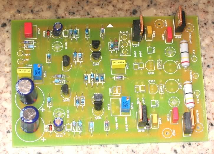

Here's one of my boards stuffed with those tiny 1/2w resistors. I still waiting on the Zeners.
And here are the heatsinks I'm planning to use.
Blessings, Terry

Terry, I've used 5W zeners after realizing that I bought 2W ones that did not match the 3W spec. Guess I should have posted like you, and I would have learned that the wattage rating did not matter; but now I've got these extra, if you want them they are yours, free. If you need any other parts, just let me know; but looking at your board looks like you are pretty much set (if not just email or post). I just can't see myself using these 27V zeners in any other project.

GeWa said:Looking good so far Terry. BTW, what's the height of that heatsink?
Regards
The heatsinks are 4 1/4" in length and use a 5" dia. fan. They are designed to cool a P500, which is 250wpc AB. I'm hopeful they will be enough.

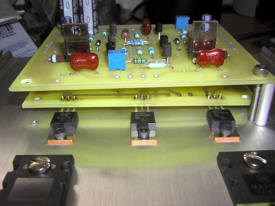

1. Soft Start

Well, I happily worked on this all day. I've got a lot of compartments, wire gong everywhere; but making progress slowly.
I carefully filed, sanded and used epoxy on the holes between sections to avoid jagged metal edges.
Also, I didn't like the nasty cold rolled steel-- a little rusty too. So painted:
My Krell clone has interior compartments separated by cold rolled steel for ferromagnetic and electromagnetic shielding. The steel looks horrible with my sharpie writing all over it (noting orientation, holes etc...) No longer, compartments will be Ferrari Yellow -- On the inside! Hey- it was in my "parts box"...yeah right.
Also, wired up the front end power supply and soft start using the big caps (CL-60 shunted after a 7 sec delay). Tested and working thank goodness. But I've got some QUESTIONS.
Question - do you put thermal grease under the full wave bridge rectifier (shown) or just clamp it to the bottom plate?
(those are pathetic little tiny ventalitation holes for the front end you see in the pic with nothing connected-- yeah, go ahead and start talking about wind noise....)
Question- this will be a massive high current device- I've wired the main PSU caps and all high current paths with 14 gauge wire. Is this big enough? (I only ask because my transformer secondaries are 12 gauge wire and I suddenly feel like I am ripping myself off).

Ferrari yellow out of the parts bin.Question - do you put thermal grease under the full wave bridge rectifier (shown) or just clamp it to the bottom plate?

Rectifier blocks are bolted to the chassis for cooling, grease wil improove performance.

Rectifier blocks don't need very much cooling--- so I have heard, but this is the 1st time I'm using a them vs. discrete diodes; but I suppose a little grease cannot hurt.
You can't see the holes---they are RIGHT THERE-- took me a long time to drill a bunch of those tiny bast**rds😉 I grouped them in 3's mostly so I would know not to connect stuff there.
rectifiers...
...to a simple approximation, dissipate about 3w per ampere,
If your idle current is at approx. 2A, your rectifiers are dissipating 6w, so they definitely need to be heatsunk...this power level will increase considerably if the amp drives lower impedance loads...by the time we get to the full power into 1 ohm scenario described yesterday, the rectifiers will be dissipating nearly 100w...go with the silicon heatsink compound too.
