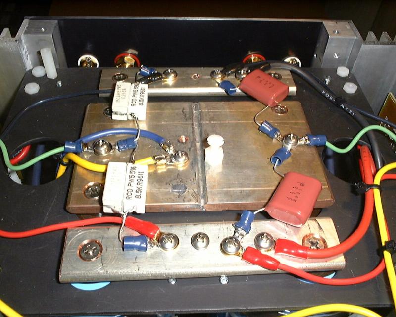

Krell KSA 50 PCB
Here is a photo of my first attempt at using Buss Bars.
Regards

rabstg said:
Please take this as CONSTRUCTIVE criticism!
1) I would not solder to bar stock.
2) Wire looks like spaghetti
3) Doesn't appear to have mechanical support / mounting for caps.
The Star ground is good, as is the concept of the filters. Just please either solder the caps onto a perf board or get screw down caps. Also the wiring looks a mess. I would hate to try and trouble shoot that amp.
Once again that is meant to help make a better version.. Not criticize the past...
#1 Why not?
#2 How would you run the wires? Is it the looks that bother you or are there electronic reasons you don't like it? If you look at the amp as a whole you can see that the wires are very easy to follow. This isa three channel amp though in the picture one of the board is not mounted at the time of the photo. It is now.
#3 The caps are held in place with douple sided foam tape between them and the bottom of the chassis. The bolt that you see for the star ground "sandwitches" the caps between the copper plate and the bottom. They do not move at all. Maybe over time, I don't know.
Why would soldering the caps to a perf board offer better connection than soldering to the plate? I pre-tinned the plate at high temp before I soldered the caps to it. I have been thinking about doing a PCB for this but I have to wonder if 1 or 2mil of copper on a PCB would equal the 1/8" plate. My logic says it won't. Pehaps you can explain so that I can understand.
Thanks, Terry
#1 Why not?
Because it is VERY difficult to get a good reliable connection to a solid bar and any vibration / movement could cause the terminal to break. Also if you lose a cap, it would be extremely difficult to remove / replace on such a setup.
Looks do bother me, if it looks neat it is “usually” safe. Also some long stretches of wire are unsupported.
Double stick tape is not a “long term” mechanical mount. If the bolt does go through to the bottom that is an excellent hold down method! It is not visible in the photo’s.
Why would soldering the caps to a perf board offer better connection than soldering to the plate? They don’t, but perf board does not require the heat to unsolder bad caps potentially unsoldering good ones also. I pre-tinned the plate at high temp before I soldered the caps to it. I have been thinking about doing a PCB for this but I have to wonder if 1 or 2mil of copper on a PCB would equal the 1/8" plate. My logic says it won't. Pehaps you can explain so that I can understand.
Your plate IS a better electrical connection but Far more difficult to make a proper mechanical connection. Solder is not for support or stability. Solder is only for electrical connectivity. The solder would easily crack or the terminal of the cap break if the amp were jolted hard as in a fall. Installation and electrical connection should be viewed as separate items. The hold down bolt is excellent. The star grounding is excellent. The wiring could use some work to be neater and better supported / secured but in the bigger picture not too bad. But I would still suggest not using snap in caps on bar stock.
Again, my comments are stated to make it better. I am not trying to discourage or embarrass. I only TRY to offer a friendly, different point of view.
Hi Troy,
Thanks for the suggestions. As to the mounting of the caps, as I said they are sandwitched between the plate and the chassis bottom. You cannot move them at all. The bolt does indeed go through the bottom plate. I have seen many "snap-in caps" merely soldered to a PCB and the only thing that is holding them is the little prongs. It's hard to believe that is more secure.
I understand that screw type would be better but I bought 25 of these little 80V, 15000uF caps and they work quite well in my P101. I still have 17 left so I plan to use some of them in the Krell Klone. If you really think a PCB is a better ground plane/ Star ground, I will certainly give it some thought.
About the wiring, I have thought about adding some tie-wrap mounts in there to support the long stretches better. Maybe I'll go ahead and do that in the near future.
Again, Thanks for taking the time to help me. I really appreciate it.
Blessings, Terry
Baloney! When assembling just place a star lockwasher on both sides of the plate were ever a critical screw passes through. I have done this for years and never had a screw or terminal come loose, ever. Most if not all manufadturers also do this. Replacment of one or all the caps is also not that difficult as the whole bank of caps comes out just by loosening the clamp screws in the mounts. This way just one bad cap, or all of them can easily be replaced.
Mark
Now, now Mark... Calm down and re-read the post.....
I said to SOLDER a cap to bar stock....
I also use star or "dragon tooth" washers on screw caps when connecting to bar staock.. It is my perferred method.
Both Terry and Mark... Peace my brotha's!
It's all good.

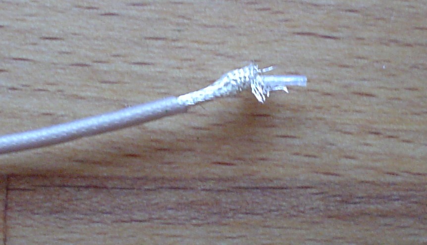

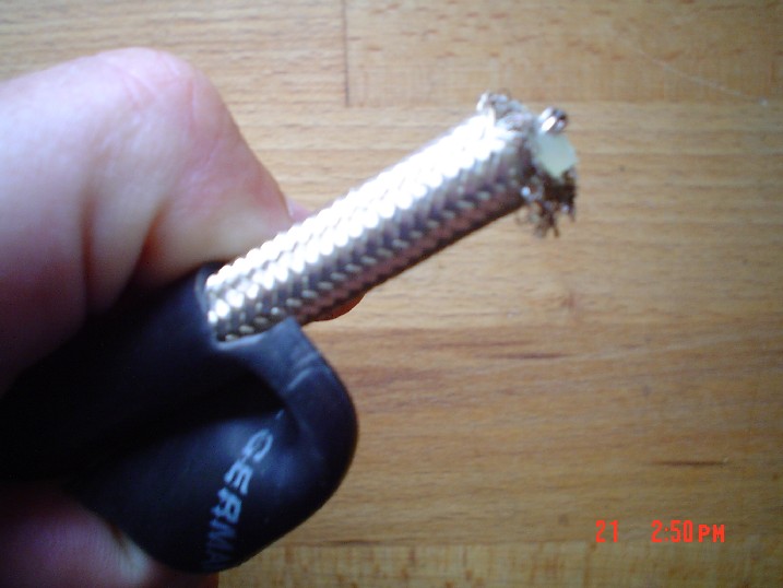

K-amps said:
Has anyone tried Apexjr's Silver over Teflon 12 ga wire?
Seen that, looks very attractive, thinking of ordering 100ft, same with the 10ga. And i gotta have those 1.5''x1.5'' feet.
i am using this as speakercable.
1/2" diameter, silverplated, double shields, 7 times 0.03" strand core.
Bi-cabled, core of one cable connected to the shields of the other for the +, same for the -
I can only recommend everyone to use teflon insulated wire for internally wiring the Krell's.
Teflon is also great material for valves and top of the range for a lot of other applications, wonderfull material.
My dad bought Teflon foil rolls by the tons from DuPont for production, i used to make all kind of stuff from Teflon foil as a kid.
(old fart)
