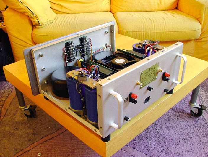

apassgear said:And now... is this what Krell uses? Terminal blocks as star ground?
At least they seem to be brass.

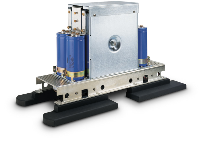

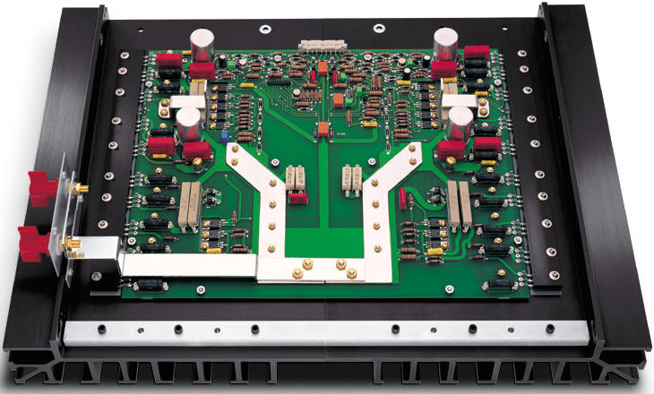

They look like brass because of the yellow furniture around the amp reflecting on the steel bus.
When ML started with these door-to-door bus bars the nuts that hold the screws were soldered on the bars.
I can't tell from the posted pictures how the nuts are attached, if ML still uses the same technique it's very unlikely that the bars are made of aluminium.
Amusing to see ML left aluminium transformer pans and went to galvanised steel.

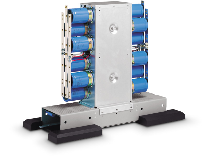

No. 33H Monaural Power Amplifier:
The efficiency of the power distribution system is enhanced by the use of tinned, oxygen-free copper bus bars that are far superior to PC board traces or point-to-point wiring.
(www.marklevinson.com)
Neychi's pictures are of the 33 and 33H

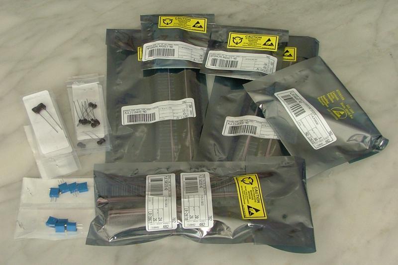

Looking good Walter, how many amps will that lot make?
Only 2 (but with some spares)

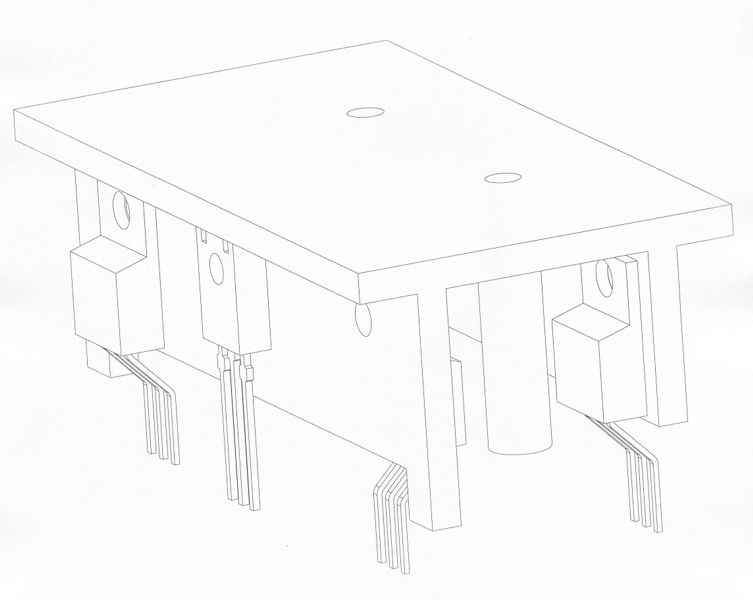

Still can't put the drivers on the board because my special cooling piece isn't finished yet

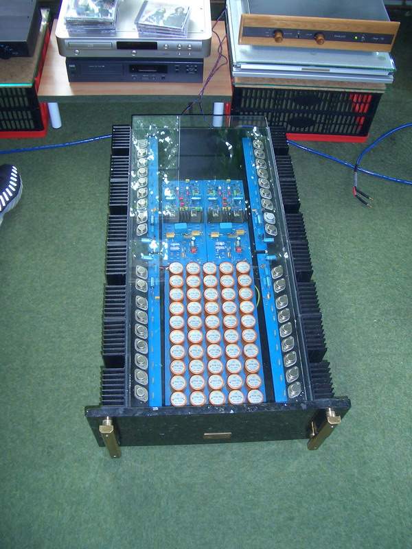

neychi said:
This amp is made on plexy boards (it isn't mine) instead of standard pcb.
Cheers
