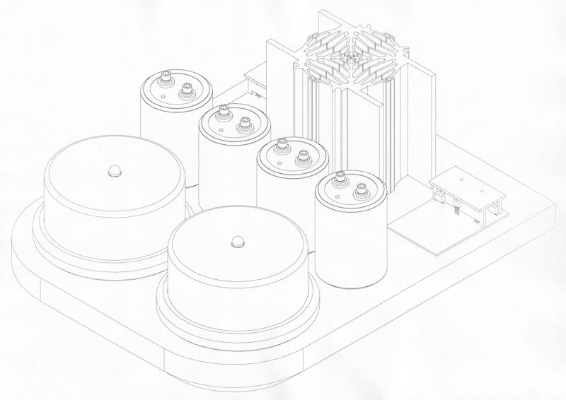

The heatsinks are on the driver PCB's. These are just some ideas, the final design of the amp may look completely different.
How is your project comming along?
Regards
Walter, in post 2775 it seems as you couple the 4 drivertrannies to one heatsink, but in the next (beautifull) drawing i cannot see that.
Regards

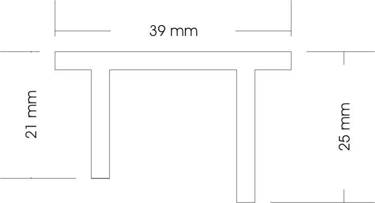

Hi neychi
Mine is a custom made heatsink. It's milled out of a solid piece of aluminium. All walls are 3mm thick and the length is 75mm.
From what I gathered here is that all transistors should be mounted on the same heatsink for better tracking.
This is a question for the expert cloners. (Mark, Al, K-amps where are you.....)
Cheers
Cheers
