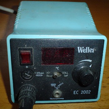

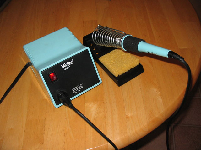

Yup i have had this soldering iron.. for about 5 years now and love it.
But just bought this blue weller off ebay for 60$ in march. The Weller 921 is ment for smd and small stuff so i now have 2.

For most projects I'd recommend the blue Weller stations as mentioned by jleaman. At less than $100 used on eBay they're cheap, and with it I've assembled huge boards with 0402 components and 0.5mm pin spacing chips without problem before I was given the larger station.
