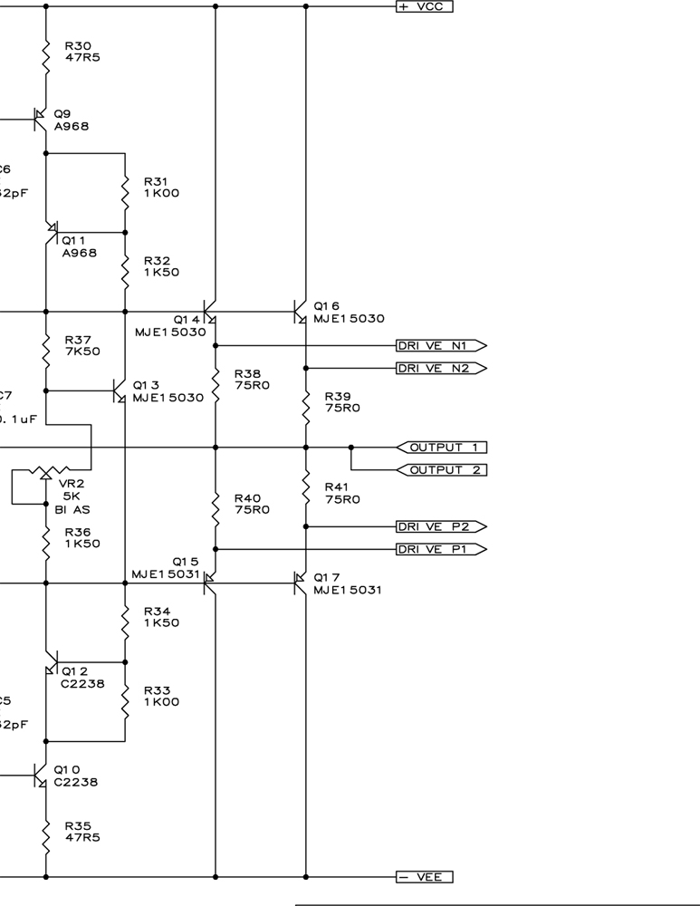

Might? Where is your faith? Please explain 5 pairs on twin drivers. Do you mean the drivers can not handle 5 pairs on the output?Now you might get 5pairs up and running (but how do 5pairs fit on twin drivers?).
Shawn.
Hi Tom,
the twin drivers expect to see the same number of output devices connected to each.
That forces you to adopt even numbers of output pairs.
2pr, 4pr, 6pr etc.
Or you could use the whole sink for just one channel and go 10pair. What a waste to leave some locations empty!

1 Pair = 2
To me, a pair is a pair,1pair, 2 pair, 3 pair who cares? I don't get it? It is a push pull set up, as long as the NPN and PNP are in sets, then it's fine. The sink is set up for 2x10, that's 5 pairs for each channel. Are you saying the following will not work for each channel? The sink holds 20 pcs of TO-3, does that make better sense? If I'm speaking in tounges please say so but I thought I was straight forward?
Let me know if I need to get my head checked?

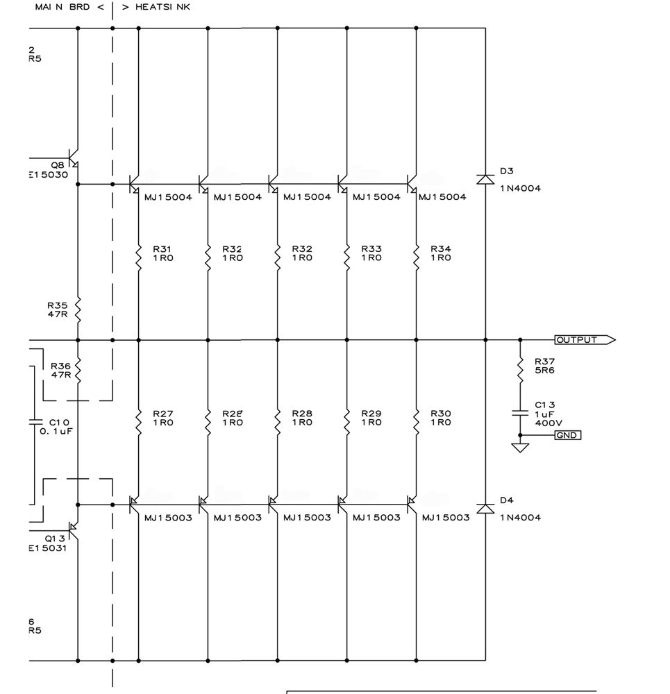

Hi Tom,
that extract from the schematic shows a 5pr fed from 1pair of drivers.
A KSA50 had 2pr fed from 1pr of drivers.
A KSA100 had exactly double that complement i.e. 1pr of drivers feeding 2pair of outputs and a second parallel pair of drivers feeding a second set of 2pr output devices.
So the twin drivers fed a 4pr output stage.
It follows that twin drivers MUST have an even number of pairs in the output stage if both drivers are connected to the same load.
You could run a 4pair stereo output and leave 4 empty locations, in the single tunnel. That would exactly duplicate the semiconductor complement fitted to the KSA100.

Actually the image is from the KSA100 first version (my edit included) and now I'm looking at the MKII and you are correct! Dual drivers for the outputs!
Well, as I said earlier, there is a lot of space between the TO-3's and it would break my heart to leave spaces open so I'll just have to machine the rest in there. It should pose no problem as I currently see it. I will set it up for 6 pairs for each channel. This will give me the symmetry you pointed out.

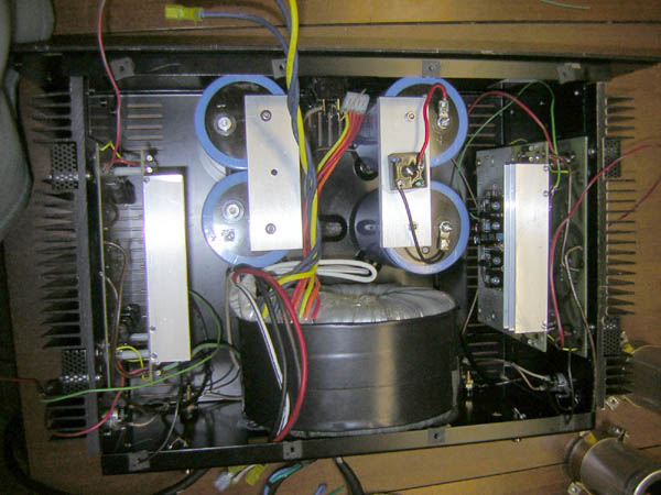

While you guys are looking at things I need to shoehorn a larger power supply into the KSA-100 chassis... Ths IS temporary!
I have a 2KVA plitron toroid that just fits in under the hood... 2 pair off 56K's and two bridges. Can I feed both bridges from the common AC secondary and use the common center tap for both channels or should I use one bridge and 2 caps per rail in this situation? Any other ideas that mnight work better would be appreciated?

I'll go with one bridge+two caps/per channel
common ground from CT,what else?
Mark A. Gulbrandsen said:So its ok to feed two bridges from one secondary?????
Mark
why not?
ya teasing me?
you know-look at Graetz bridge-you feed two diodes in same time -from one secondary..........
why not two bridges............

Mark,
consider the other alternative.
Feeding both channels from one bridge would be equivalent to running a true 400 watt Class A Krell amp from a single bridge rectifier, at the least.
I suppose you've got huge bridge rectifiers ?
(3d: 4 bridges, no common ground)
The two AC connections get paralleled to each rectifier. Then each rectifier feeds it's own channel. The outputs of the rectifiers are NOT paralleled.
The single centre tap goes straight to the audio ground where the 0Volt from both the capacitor pairs have also met up with the speaker returns etc..
yes.. Can I feed both bridges from the common AC secondary and use the common center tap for both channels
Thansk guys, I iwll go with both bridges fed from one AC secondary with the CT being the 0 volt common junction for all grouinds.
