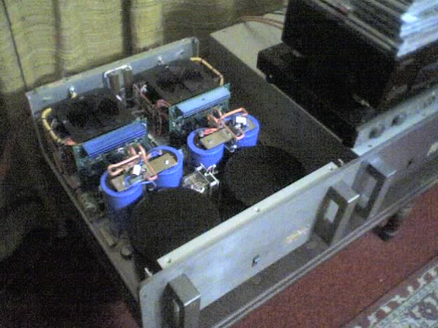

KSA 100 M2 upgrade feedback
Hi
Some time back the amplifier driver stage, output devices, the internal wires between the pcb and output devices were changed to Van den Hul CS16, the Roederstein pcb caps replaced with one Black Gate cap per board and the mains input changed from 115 volt to 240 volt. My expectation was that all these upgrades would contribute to an overall improvement in sound quality.
Listening to the amp after the changes my initial impressions was that it had lost the Krell characteristics. The soundstage was skimpy, I was hearing two speakers, vocal pieces sounded shrill and lifeless and the extreme lower bass sounded loose. Apart from a volume capacity there was nothing to suggest that this amp had the finesse it is known for.
My initial thoughts re the causes were that it could be:
a) The BG caps that still needed some more time to burn-in?
b) More accurate output transistor matching was required?
c) Or to revert back to the slower original driver transistors on the pcb?
d) Drop in voltage when using 240 transformer setting?
Yesterday after my Sunday afternoon nap I woke up with the idea that I need to remove the tight cable ties that held the yellow Van Den Hull cable in place. Interestingly once the cable ties were removed there was a significant improvement in the soundstage solidity and inner detail.
The lesson here seems to be that there is obviously more subtle issues at stake here. The Van Den Hul wire obviously did not like to be “crimped” or to be so close to the power wiring of the output transistors. This is possibly a hint to everyone that care needs to be taken in the wire layout if optimum results is a criteria- especially if you have no idea of how a Krell should sound.
Jozua

The cable ties were used (just like the original) to tie the interconnect to the DC power fed to the rear transistors of the blocks.
I've thought for a brief while about possible issues but the original wire were super-thin and thus in much closer proximity than the very thick vdH, plus the vdH coax is balanced with the shield tied to ground at one end and the signal and return connected to the two internal conductors.
