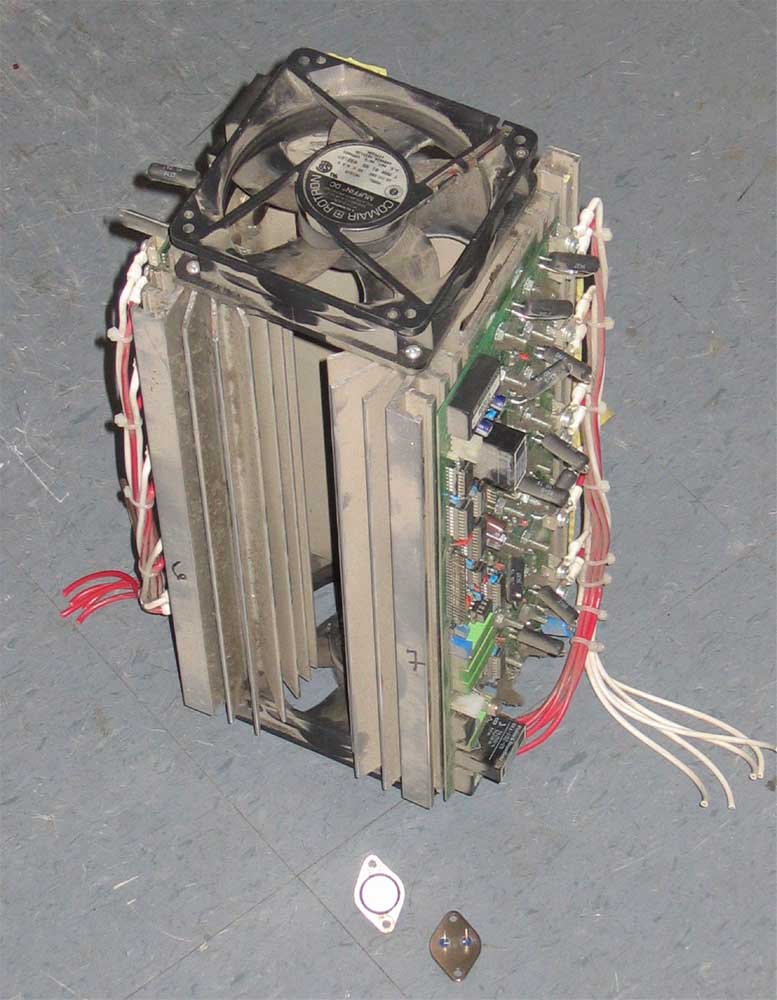

Getting ready for the storm
I couldn't turn my back on yet another heat sink tunnel surplus item! 🙂 This one weighs a ton, has a fan on each end and holds 2x10 TO3's. It is already machined out and the spacing between the TO-3's is generous and the unit is very robust. Each half measures 16.5cm wide by 32.5cm long. This too could easily chill a mean KSA100 down.
Planning in advance,
Shawn.
Shawn.

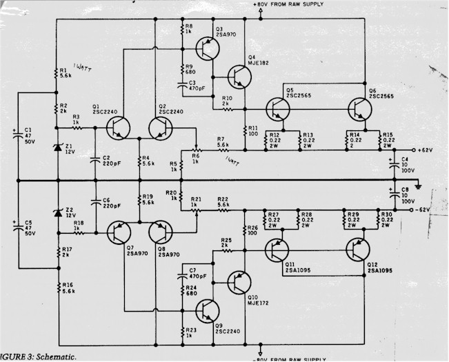

I'm still not clear about the dual driver transistors. What is the advantage?
Do they need to be very well matched so they turn on/ off at the same time?
Also are we certain the cct we have is indeed the last version for the KSA100.

Harry3 said:I'm still not clear about the dual driver transistors. What is the advantage?
Harry,
The main drawbacks of the antique MJ/MJE devices are the low current amplication factors and low Ft values at high output currents.
At lower output currents their hFe and Ft are pretty good.
One reason why a bunch of the American 80s designs had big arrays of parallel output devices, such as the big Threshold and Rowland Research Model 7 amplifiers. And Krells.
Not just for flashing El Major hardware, for a reason.
At lower output currents, the later Motorola devices reach Ft values of 7 to 8 MHz, with hFe values that are as good as Jappon competitors. See a bunch of posts by one of the Motorola TO3 experts, DJK.
With fewer parallelled output devices the driver section needs to compensate for the lower hFe of the output devices at high output current levels.
As the available driver devices in the 1980s weren't that great at higher load levels either, splitting the load across 2 drivers keeps their hFe value more stable.
The idea of course is that the driver section keeps floating, at the output level where they start switching i doubt that it's a big thing if they don't switch simultaneous.
Dissipation of the drivers gets pretty nasty when the output stage has to drive really low impedance loads, AND doesn't have sufficient high hFe.
As you can see from the schematic the load on the drivers is reduced by halving the bias load, the KSA100 drivers have 75 ohms emitter resistors instead of the 25 on the KSA50.
(40 % more rail voltage, bias current reduced to 1/3d)
A way around the issue is by using more modern output and driver devices, which retain their hFe values up to higher output currents.
Or like in the old days, use a sheetload of TO3s in parallel.
The main reason for using TO3s is because they may be easier to get in some places and/or they are less expensive.
A suggestion might be to match the combined hFe products of driver and output device section.
I was hoping we could chat through another year or so on the different KSA-100 versions.
A thing to be highly aware of is that in low impedance loads the drivers get a serious beating.
If the voltage on the output stage rises, there's more output current going through it, means more current having to flow into the base of the output devices.
Suppose the output voltage doesn't go higher but the load impedance drops. Also means more current, again the base of the output devices need more current.
Then, if the output current becomes so high that the hFe value of the output devices decreases, again there needs to flow more current in their bases.
On top of that, in both cases the voltage drop across the emitter resistors of the output devices goes up because of the higher current going through them.
That means that also the voltage drop across the emitter resistor of the drivers increases !
Means there's also more current going through those resistors when the output stage is driven, NOT less.
And all of that current has to be supplied by the driver(s)
So why were these Krell designs so good in driving low impedance loads ?
One reason => Because they have a very sturdy driver stage compared to the less capable varieties.
In relative terms, the KSA-100 is a good example of an amplifier that can be seen as one with an output stage after the output stage.
The 4 MJE drivers are good for a total Pd of 200 watts, an output stage with a Pd of 200 watts is good enough for an average 50 watts/8 amplifier.
Less robust amplifiers that have to drive a low impedance load can burn their driver section before the output stage blows.

Jacco has made the case well for a generous driver stage.
One point I would like to add.
When the output stage is working into a reactive, the driver also feels the effect of that reactive load.
A condition to design for that is fairly extreme (but achieveable) is full output load current when the Vce is =PSU rail voltage.
For the KSA100 into 4ohm this would be about 40Vpk/4r = 10Apk @ Vce=50V giving 500Wpk through those four devices.
The drivers each see half this divided by the output gain @ 2.5Apk (10/4).
The driver dissipation is about 49V*5/40~=6Wpk.
A single driver would be dissipating 12W for the same 4ohm load.
The numbers for 2ohm (and god help us, 1ohm) get much worse.

Hi Tom,
that tunnel leaks.
It will work much better if you can "tunnel" it.
I note that the two sinks are spaced quite far apart and the fins on the outside are in passive air.
Can I suggest you make a sheet metal tunnel and bolt both sinks inside it but much closer together. A small gap between the outside fins and the tunnel inner wall will work quite well.
Remove the fan that is sucking and place the pushing fan at the bottom.
Now you might get 5pairs up and running (but how do 5pairs fit on twin drivers?).
that tunnel leaks.
