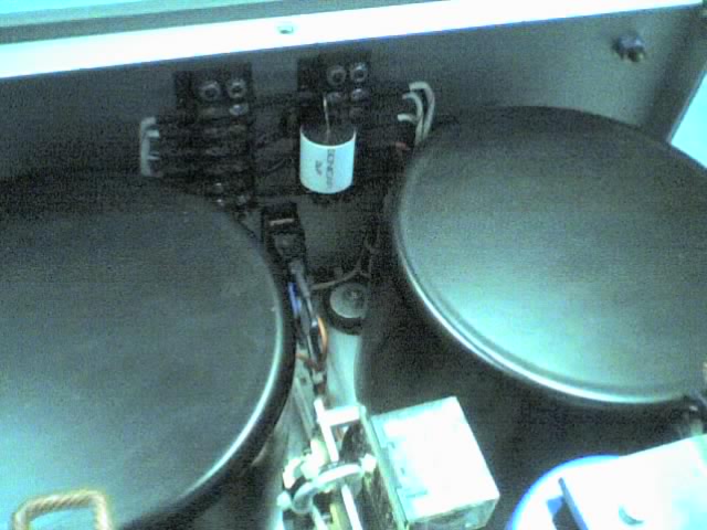

Hi
Some quick feedback re the sound quality following the work done by Pierre.
I have removed the 2uF cap from the mains voltage at the transformer primaries at the wire harness. That made a 20-30% improvement in restoring the bass tightness the Krell. However I still find it lacking in realism, overall transparency and extreme dynamics. The attached picture refers to the cap change on the PSU.
I am hoping that the above sound attributes could be due to the fact that some burn-in is still required. For the meantime the amp stays as is. If there is no improvement my gut feeling is that if one might need to revert back to the original PCB drivers?
At the moment I am playing the amp without a cover and despite the lower class A rating the output transistor heat sinks still do get pretty hot..
I keep the group updated.
Jozua
Jozua

Hi Joz,
I would have expected interference suppression (at the mains side) to have more effect on the mid or treble frequencies.
this result surprises me.I have removed the 2uF cap from the mains voltage at the transformer primaries at the wire harness. That made a 20-30% improvement in restoring the bass tightness the Krell

I did the initial listening test with a transistor pre-amp that was fired up cold with the amp. The pre-amp has now been on one and half days and listening to the amp this afternoon I could detect a further improvement in speed and low end extention. I now suspect that the cold-start of the pre-amp could have had a impact on the overall sound.
It is summer in Cape Town and I was very surprised how hot the large pcb driver heatsinks became. My gut feeling is that if the case is not a constraint nothing can be lost by using larger heatsinks.
For the moment I intend to leave the PSU cap out.
Jozua
Jozua
