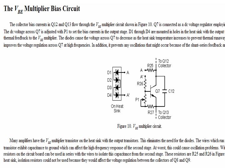

- Changed the MJE15030/31 drivers and vBE multiplier to 32/33's since I didn't have any of the others and it proved successful in the KSA50 project and Mark also used it in his prototype

Originally posted (331) by AndrewT
there seems to be a dual identity regarding KSA50 Klone bass developing.
Some are saying that the 50 has really strong deep bass and others are consistently saying the 100 beats it every time.
Is the power supply the difference between the two opposing sides, or is it in the implementation/selection of the PCB components?
Whichever, we need to understand the mechanism to ensure that all the builders of the 100 get the full benefit of this renowned bass ability.
Originally posted (361) by AndrewT
jacco said quote:
"A bunch of folks here built a bunch of different KSA50s (Klones), judging one variant doesn't speak for another. "
That was the point of my earlier question.
Which components control the bass quality in the final build of a KSA50 Klone? That knowledge can and should be used to ensure the 100Klone build gives the result that most would expect.
We could start by comparing the differences between the common parts of the two 100s and how they are different from the 50.
The LTP seems similar,
The VAS seems similar,
The FET stage (mk2) is different,
The driver stage is doubled,
the driver bias is reduced,
the output stage is doubled and the bias is +40% (reduced per transistor),
the transformer is bigger,
the capacitance is bigger?,
the layout is different,
What else can be added to the list?
What components in the difference list can be eliminated from the bass investigation? Any?
What components are left that may have an effect on the bass quality?
Excellent comments. From what has happenned in this case, it would seem apparent that various tweaks that may offer improved performance in some cases may not necessarily hold true.
Based on these observations I think the window for investigation can be made smaller than the ones jacco mentioned earlier, since many stayed the same during the conversion process such as power supply, layout, front-end, number of driver/output transistors, output bias. They may of course have an influence, but in this case they all stayed the same, yet the bass had changed. Since the change is so profound, these may be the starting point for many seeking the difference between the 50 and the 100 too. Differences with transistor proximity may also influence the mixed comments even with the same transistors used.
First off I'd suggest somebody do a side-by-side comparison of the different driver and output transistors. Everybody says "I'm using xxx and it sounds so much better than yyy", but did anybody ever make an observation of comparing some directly in the same amp? Another possibility that obviously only holds true in certain instances might be that the higher fT (4MHz instead if 2) of the 21193/94's may not be as happy as the 15003/4's with the fairly long leads going to the transistor bases on the original heatsink: almost 20cm for the rear ones.
Same goes for the driver transistors.. I can't see why but maybe the higher-gain models don't work too well with the drivers and/or vBE multiplier.
PSU and capacitance would IMO be secondary, since the Mk1's bass is apparently not as good as the Mk2's, yet they use the same power supply - only difference is the capacitors and transformers are newer models, but the same values and VA ratings.
I know many of these should make no difference in a theoretical sense, but since there was a change, and a big one at that, it would appear that further investigation may be warranted. Unless somebody finds out what's going on, people wishing to play it safe may want to stick as closely to the original as possible.
